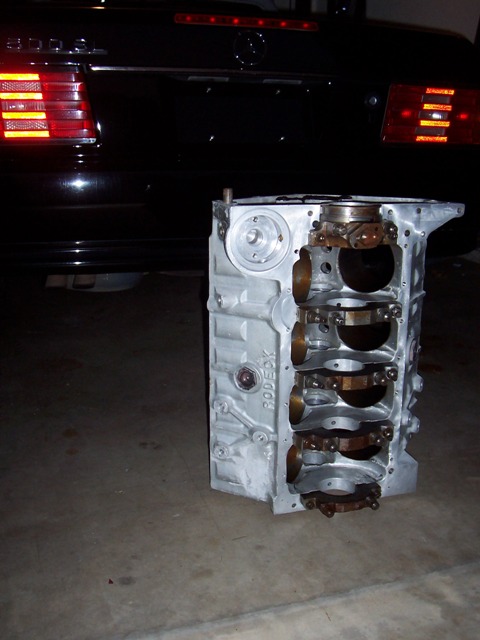

This seems like a good place to post a pic of my main acquisition :
I have an Eagle crank and rods that should be in some time this week. Going to build a 377. Should be good up to around 9k RPM if i get the top end together like I hope to.

Dead nuts phrek. With alum heads, my brain math puts me at about 50 lbs lighter than the 2.8 v6 it's replacing. I'm going to get as close to 50/50 weight as I can with this project. Initial guestimates from the scales are going to put me at 52/48 without trying very hard.

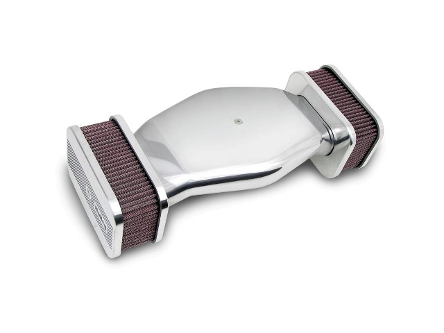

I hadn't really thought about it till you said that, but unless I'm overlooking something, I won't have any GM parts in my setup. Victor JR intake, Silver Demon 650 carb, MSD Ignition, and I've got a trick air intake setup figured out (I think) that will look a whole lot like FI to the untrained eye.
Something like this, with black plastic duct work going to either side under the deck vents, where the actual air filters will be :
No chrome though. Brushed alum on all of it.
No computer wires running all over hell and back, nice clean install.

That is a very nice block, but also very expensive.
Displacement does not mean power. Displacement with VE (volumetric efficiency) equals power. VE is more easily atained with a dohc design. I believe that is what JohnnyK was getting at. An engine with a high VE and forced induction IS a replacement for displacement.
The aluminum sbc is nice, but sbc's generally make too much torque for our transmissions to handle. A smaller displacement engine such as a N* which makes hp through rpm is better suited for a fiero. Less trani snapping torque.
I've been in a 430rwhp fiero with a 406 sbc and it was insane. I was amazed the getrag 5 speed could handle it, look forward to seeing your swap done.

I just gotta ask what trans do you plan on running that is going to support the HP your going to get from that motor? Better be something built or thats going to be a waste of alot of HP and alot of money in trannies.

You're all going to crap, but I got it for $0.00.
We bought it at an auction to build for one of our race cars, but upon further inspection decided it had been run too hard to be suitable for an 800 HP build. These rodeck blocks have problems with generating cracks on the mains webbing at big HP numbers so it's been sitting around the shop for 6 years looking for a home. 86 GT will be where it's going. Will hold up to 500 HP fine.
I also had a Eagle 383 crank I bought years ago and never used. New in the bag. Local engine builder needed one so we even-swapped for the 400 crank I need for this project. Also found a set of carillo nascar-pulloff rods that I'm going to ebay (2 bad in set, 6 brand new remaining) I think I'll get 500 for. So that covers a new set of rods and 1/2 a carb. I've also got a set of double-hump iron heads that were built to go on a race engine and never used. I think I'll get a couple hundred out of those too with that cash towards a decent set of alum heads.
I'm very fortunate to have a fully equipped race shop at my disposal, and enough blowup leftovers to put this thing together for next to nothing. I expect I'll have under $2,500.00 in the whole project when all the swapping is done, and that includes buying the car to start with !
