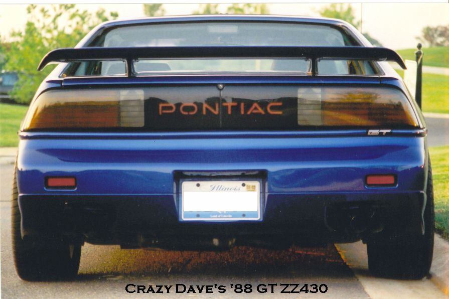

03/29/03 - The Chicago winter has for the most part come to a close, and I've brought myself out of reclusivity and the blue monster out of hibernation. When I put it away in November it was at 6200 miles. The clutch is still holding up with absolutely zero problems and the Getrag, with GM trans fluid and output support bearings, still shifts smoothly and tolerates the abuse of this engine with aplomb.
The engine, however, is only about 75% dialed-in and is in need of some wideband O2 dyno tuning to get it 100% for this upcoming season. Can anyone recommend a shop in the Chicago/Rockford/Milwaukee area that can do wideband O2 tuning and deal with the reprogramming of a '92 F-body engine computer and MAP TPI setup? This is a removable EPROM chip-based configuration, unlike the tune-on-the-fly computers of '94 and later with MAF. I have tried the remote reprogrammings that use an inline datalogger or manual data chart, but those rely upon the limited feedback of the narrowband O2 sensor on the engine and can't get it as close as wideband O2 tuning can. This thing really needs a sniffer up the pipe.

I'd like to preface this by saying that a lot of folks refer to their cars as beasts after doing modifications to them. I haven't heard of anyone call a modified 4cyl a beast yet, but some near-stock V6 cars have been referred to this way, and this dilutes the meaning when referring to a car which has truly been reborn with something an unholy degree meaner under the hood.
I'd also like to mention that anybody who has ever attempted to push the limits understands that it is never as easy as it seems, and there are implementation challenges no matter how well you think you've planned it out ahead of time or how easy it should be in theory.
My goal has been an honest, naturally-aspirated 400hp (or more) Fiero that has 100% daily street drivability, 100,000-mile durability, and nothing to give away what is under the hood - especially to have a quiet exhaust. The accomplishment of all that is no small feat.
Today I found and solved all the remaining issues with my engine and injection system, both drivability and performance, and even got a little scanner time on it. I'd like to thank Chuck (MotorTV), Archie, Eric (AOB), and Winston (FieroLT1) for their help and suggestions in dealing with these issues.
Right now, it's even better than it was last weekend. I got rid of a miss and reduced power that turned out to be rotor contact corrosion on the distributor cap. I smoothed out the fuel delivery (according to the fuel pressure gage, at least) with a new fuel filter, from the previous one clogging by the pump sucking the crap out of the bottom of the tank from running out of gas a couple times. My Speedhut Indiglo gages are to blame for that, by the way. I topped it off with an injector cleaning and a plug-wire rerouting to cure a heat issue. The computer is now clear of codes and staying clear, and the scanner shows zero spark retard, no false knock readings, and a block learn only slightly on the rich side at around 116. The computer no longer seems to be compensating for things being out of whack like it has been.
I have been in ZR-1 Corvettes, Lingenfelter C5's, Viper GTS's, highly modified F-bodies, and numerous other cars over the years. Nothing I've ever been in has launched this hard, pulled this hard, wound so high, and been so cheek-flatteningly fast as this without nitrous or some other power-booster.
Archie drove it, and his comments surprised even me. I'll let him share his thoughts on it if he chooses.
It's definitely ready for a dragstrip run now, when mother nature cooperates. More videos are also forthcoming. Stay tuned.
Dave

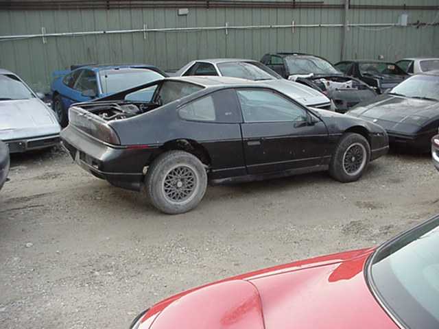

Early images of the '88 GT auto donor car:
Wow Fiero heaven..!? Is there truly such a place, where old unfortunate forgotten Fieros can join as one!..
Waiting for a saint to come along and rescue her. Where is this fiero heaven..???

I believe what you are seeing is the place where old and tired Fieros come to die a peaceful death.
Only to come back reincanated in a beautiful body with a very, very powerful soul.
