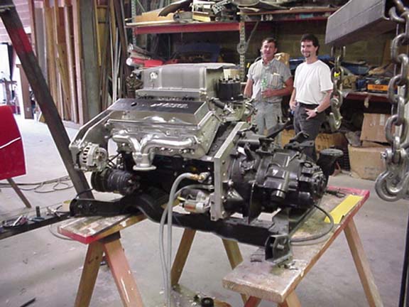

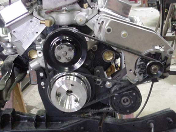

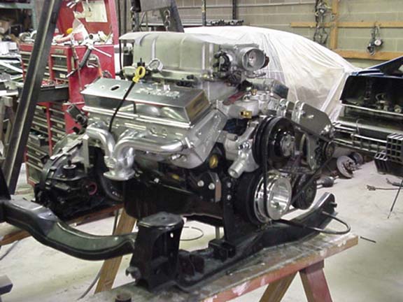

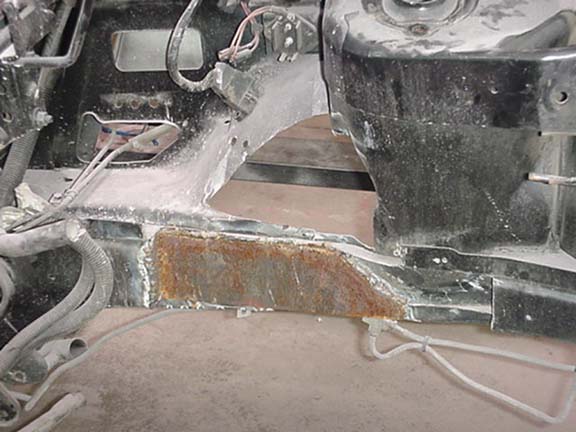

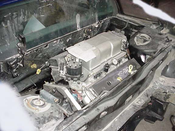

A few pics from yesterday..... got the belts drives all sorted out.
I hear all these experts saying that they don't like my W/P drive .... the alternative to that wouldbe to use an electric pump. This is the next alternative. What we did here was to move the engine to the left in the chassis by 2.375" (like on the Z kit) Moving the engine over like this requires notching the frame rails to clear the end of the transmission and the huge stock SBC HBP. When people complain about my W/P drive and the sheet metal you have to trim out of the inner wheel well to clear it, then I can't figure out why they want to use the Z method that requires frame notching on both frame rails. Like this....
As you can see we've welede in a lot of steel plate and boxed the frame rails. Considering that if you use and electric W/P or my W/P Drive you can mount the engine in the normal location and avoid all this frame notching, this method (shown) becomes a lot of extra work & also more expensive since it requires that you use custom length axles. However on the subject of W/P drives this illustrates the difference between the 2 methods.
Here are some pics of the engine asembly after we finished the belt drive & before we put it in the car.
Here is a pic of the belt drive system:
A couple of pics of the whole assembly.... that's Crazy Dave in the white nd another groopie standing with him.
More to come later today.
Archie

archie, i like to know what you think of the v8 conversion that had the marine waterpump. hope that's not too vauge. it was posted a few months back by one of the canadian guys. seemed to maybe be a good option if the car dosen't have a/c.
found the thread...
https://www.fiero.nl/forum/Forum1/HTML/017141.html
[This message has been edited by Philphine (edited 08-09-2002).]

YIKES!!
I'm glad I didn't have to chop up my frame like that.
I feel a lot better about the small notch I made in my frame.
Seeing the amount of frame modification involved with the stock pulleys, I am glad I bought archies water pump drive kit.
And when my pump starts to leak it will only cost about $30.00 for a pump would be available at any parts store in the nation and I'm on my way.
Try that with your electric water pumps.
If you break down in bum f**k egypt, you will be staying for a few days.
Thanks for showing me what is involved in running stock pulleys, I always wondered.
tstroud

Report this Post08-09-2002 09:55 PM Click Here to See the Profile for ArchieClick Here to visit Archie's HomePageSend a Private Message to ArchieDirect Link to This Post
Well, it's in there.
Next week we install and exhaust, hook up the cooling system and the wires & boot it up.
Archie
Archie ... is this a new Alt racket system? looks like you are using 2 brackets instead of the usual 1. Is this to keep everything in line?
Archie
Posts: 9436
From: Las Vegas, NV
Registered: Dec 1999
Total ratings: 547
Report this Post08-13-2002 10:37 PM Click Here to See the Profile for ArchieClick Here to visit Archie's HomePageSend a Private Message to ArchieDirect Link to This Post
No not really. On this car (& on my Stinger) this area is easy to see when looking into the engine compartment so I thought it would look a little cooler if I doubled up on the bracket. This is actually just 2 Alternator brackets bolted together. Nothing fancy & not really necessary. A little decoration if you will.

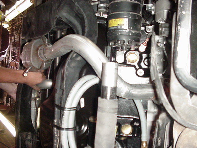

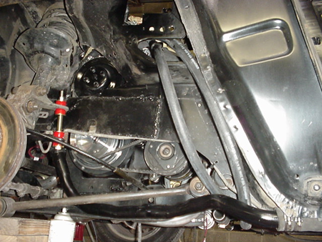

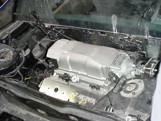

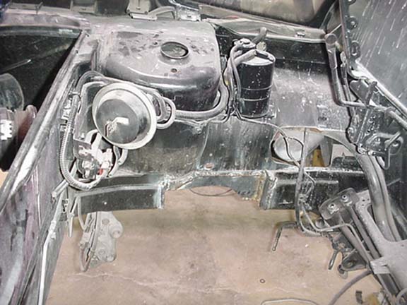

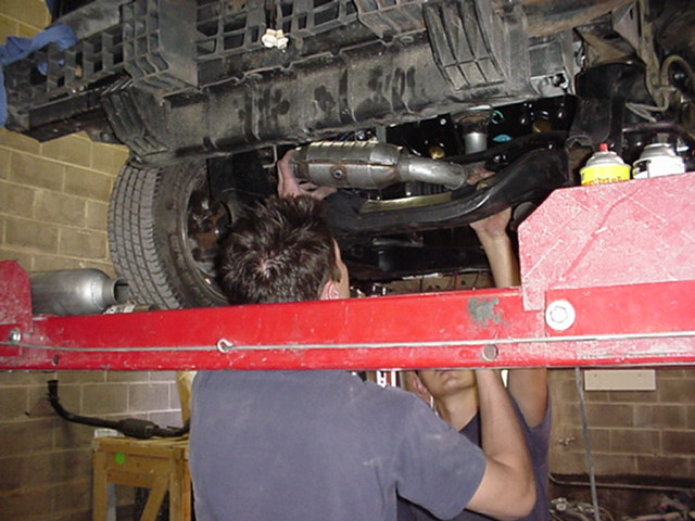

More pictures of the latest progress.
A shot of the passenger side wheelwell with most of the coolant lines in place:
Working on the exhaust. Since this is an '88 GT, the factory rear sway bar is in an awkward place to clear the exhaust:
The front side, however, isn't a problem. (looking sideways, I can't rotate images):
Dave

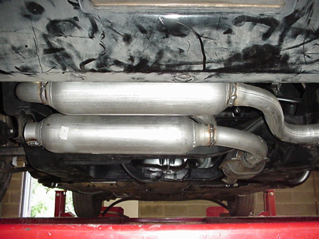

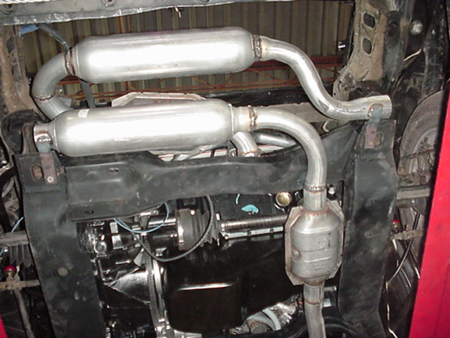

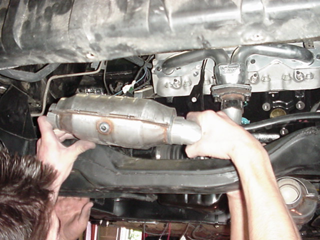

Completed exhaust:

Report this Post08-15-2002 05:05 PM Click Here to See the Profile for Formula88Send a Private Message to Formula88Direct Link to This Post
Did you loose any of the trunk for that exhaust?
crazyd
Posts: 2016
From: Washington
Total ratings: 140
Report this Post08-15-2002 06:48 PM Click Here to See the Profile for crazydClick Here to visit crazyd's HomePageSend a Private Message to crazydDirect Link to This Post
Yes, I lost the lower section of the trunk for the mufflers. That is why it is having a hitch installed. As you can see there is also a catcon above the two mufflers, so there will be a lot of heat beneath the trunk. I had hoped to extend the trunk down a little for some more room, but the heat nixed that idea since it would melt the carpeting.
Dave

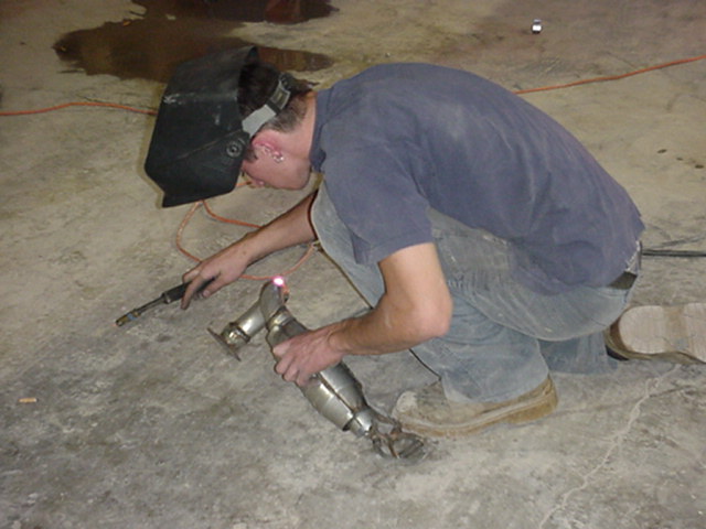

Report this Post08-15-2002 11:18 PM Click Here to See the Profile for ArchieClick Here to visit Archie's HomePageSend a Private Message to ArchieDirect Link to This Post
Well the exhaust is not yet complete in these pics. we still have to put 90 degree turns and the S.S.Resonator Tips on both sides & paint the exhaust.
The Cat is mounted about 7" below the new trunk floor, so there is plenty of room for circulation around it.
Dave does need a little trailer to put his stuff in. You wouldn't believe how much stuff he has packed away in his car. He travels with more baggage than my wife takes.
BTW, you can build a good exhaust with the trunk area still intact. But if you want Cats & dual mufflers outside the engine compartment, you're going to give up a few inches of your trunk area.
