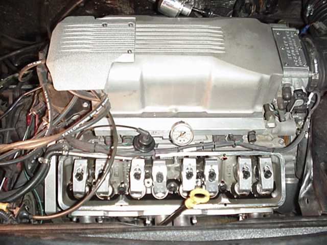

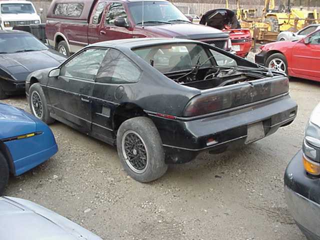

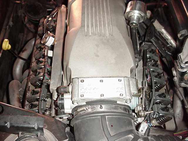

I found some more pics that I wanted to post.
Early images of the '88 GT auto donor car:
And, those beautiful GMPP 1.6 roller rockers:
Cheers,
Crazy Dave
