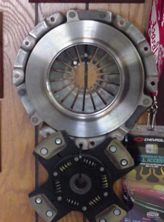

The Center Force Clutch sold by Archie is very streetable. There's no noticeable difference in the pedal effort and I believe that the clutch hold is superior to all except the real exotic stuff (which wouldn't be streetable anyway).

Tough call if you're going to go above 400/400...
In that rareified region, you're starting to talk about a truely exotic car, and a car that can have issues with even the CF clutches. (this is what I hear, second hand. I do not own a SBC350 Fiero
California Kid AKA Tom I belive has blown a CF clutch, though his car is a Zumwalt kit, and I do not know if it was an Archie CF, or
PS: when I say 'blown' I do mean exploded... Parts don't just 'fail' at 400+bhp...
In my N* car, I'm going with the Quartermaster setup, Tom has had this on his car for nearly 30,000miles so far. And asside from the fact that you will likely have to change it every 20-30k, at a cost of about only $200 for new discs(everything else is high quality billet Aluminum, or Titanium, and is retained). Our QM clutches are fitted with an *ORGANIC* friction compound, as opposed to the purely metallic hardcore racing version. (this exact clutch, in 2 and 3 plate variants, most of use the 2, is used in NASCAR Winston Cup race cars by the way... with metallic discs.)
The 3-plate is rated to hold 1,150lb-ft, the 2-plate 750lb-ft. It WILL NOT fail with your V8
Tom and others with the organic version tell me that there is some slippage possible, and that you can drive it like a centreforce that heats quickly (the discs are race depth, so a tad more sensative to 'riding the clutch' than a CF, but not too much more.)
I don't know that I'd put one in my *daily* driver, but in a weekend car, sounds like just the ticket for serious HP.
Ferrari's F40 had a twin-plate too.
I guess you could really go either route. $400 clutch that you can probally get 40-50kmiles out of, unless it explodes, or $1200+ clutch that you get 20-30k at the most out of, but WILL NOT SLIP, ever
Anyone with more than 400bhp/400tq in a Fiero with an archie CF care to comment on their reliability expierence? I'd like to get some numbers to replace my conjectire....

Chester, I, as yourself, am using Archie's Centerforce clutch. I would second what Farknocker said, real smooth, good grab/hold. Mine is mated to a 300hp SBC. My guess to your 'few' responses is that most would be somewhat wary of +400hp to suggest what clutch to use. How streetable is 400+hp??? ie: 'idle' at lights?? J/K...

IF you make that kind of honest power, the standard CF clutch supplied by Archie will not hold. I don't care what he or any other member tells you. In fact, a good rock sold 300 will blow that clutch away.
Here is the good news. You can go direct to Centerforce, and or through Archie etc. and ask Centerforce to custom build your assembly for more power. This can be done for around $250 additional on top of Archie's regular price.
I opted against this option when having trouble with my Archie/CF clutch on my high output engine. I had actually removed it and shipped it back to CF for a QC check. It checked out fine, but I was told direct from the source it won't hold on a consistant basis over 300 hsp. They at that time offered the upgrade.
Go for the upgrade and let us know.
I have a RAM 900 on that same engine now sitting on a ZF six speed in my 90 Vette. This clutch bites like a mother, but is difficult to manage in heavy rush hour traffic as it tends to be more on/off than smooth transistion.

FWIW, I have a CF DF clutch (this is not Archie's version) and it slips. 1st and 2nd gear is OK but if I drive agressive it will slip all the way through 3rd! My motor should be pushing over 350 ftlbs of torque. I have 9,000 miles on this clutch.
This clutch is installed correctly and has been properly broken in, I do not have a leaking main seal either. The pressure plate is just not up to par for high torque loads. I have contacted Centerforce and they said that they could make a pressure plate with a higher clampload. This higher clampload would make depressing the pedal a lot harder however. I don't mind a harder clutch pedal but Centerforce qouted me $300 for a new pressure plate.
I am currently looking for a replacement clutch with in the import community. They have the same size limits for clutch diameter that us Fiero owners have. There are many excelent import clutches that hold over 400 Ftlbs of torque, problem is getting one setup for a Fiero. I am still working on this, any info suggestions from anyone would be great!
Of course you could spend a $1000 and get a dual disc setup.

You can / should contact other companies for custom setups and prices. Always good to have more feedback.
As noted by Ben "Artherd" above this works excellent in the double disk configuration (triple disk shown). You can stand on it in 5th gear and it's positive lock. While it isn't designed for "street use", it is very streetable.
