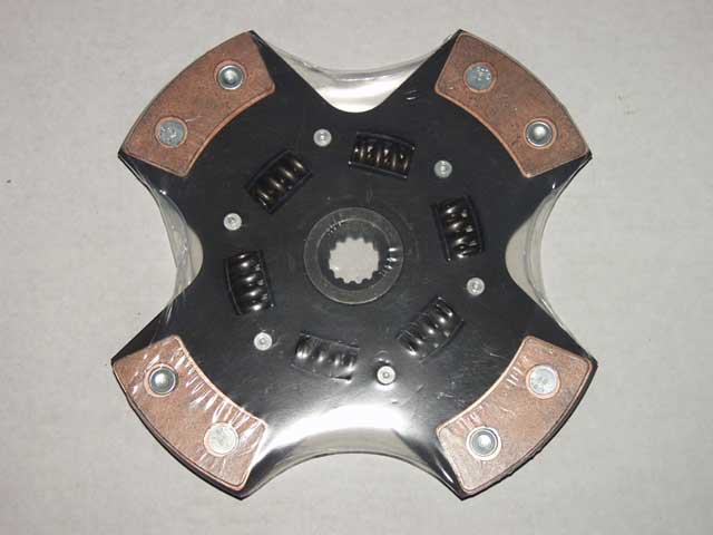

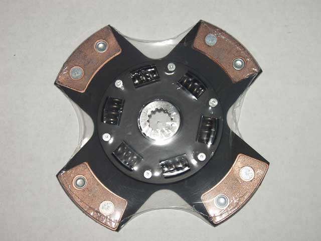

Here is a response I got from SPEC.
Chester you may want to call them.
Jim,
Again, thank you for your inquiry. We are willing to work with all V8 Fiero
owners to get the best possible clutch solution.
You are welcome to forward this information on to all Fv8 owners, at least
until our new website launches in 3-4 weeks.
The two pictures on the forum are both stage III's. The black disc ( "+"
design) is our newly revised Stage III. The gray disc in the wrapping is our
previous stage III. The owner of the "old" unit is welcome to turn it in for
a new design. The new design is stronger and lighter.
We offer two pad options, carbon and ceramic. The carbon is a little smoother
after break-in, but the ceramic has a little more bite.
We have Stages IV and V also, which are more aggressive and stronger than the
Stage III. The Stage V is an excellent alternative to the pricey QM dual and
triple.
If you will give me your torque goal, I can tell you which one you need.
David Norton
SPEC
800-828-4379
Jim
Jim,
triple.
David Norton
SPEC
800-828-4379
Jim
Sweet, They're cross shipping me the new disk.
Rob D.

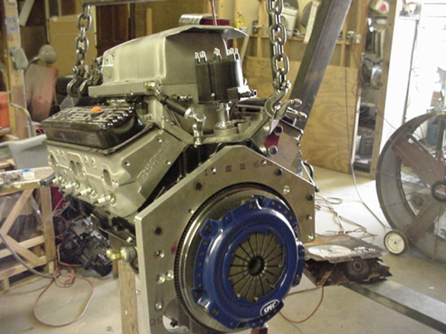

Well, she finally arrived
Will be installing within the next 2 weeks

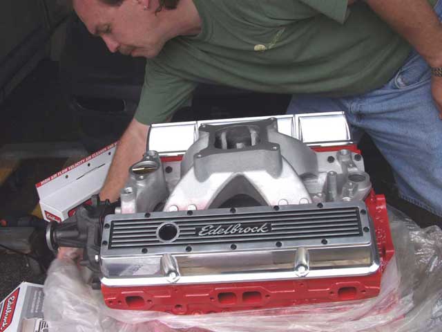

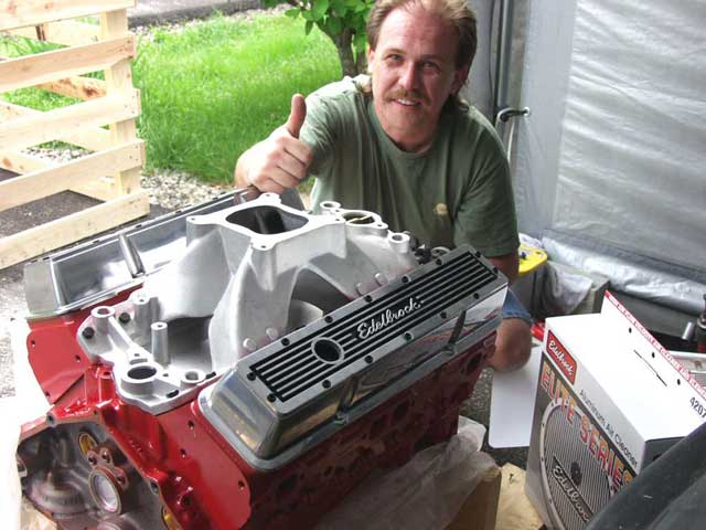

Ben Cannon

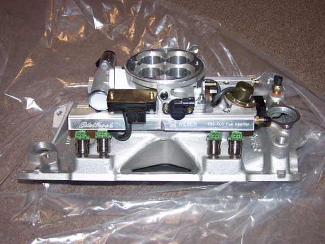

Report this Post06-28-2002 05:24 PM Click Here to See the Profile for crazydClick Here to visit crazyd's HomePageSend a Private Message to crazydDirect Link to This Post
I sure hope you've got a different intake manifold, that one's not for any injection system I've ever seen...
Dave

Originally posted by artherd:
Oh, HELL yeah! )
Best!
Ben.
(did they paint the aluminum heads?)
THATS what I'M talking about! Nothin' like 450 ponies pushin' ya 'round No aluminum heads, the motor has a set of Dart Iron Eagle heads with 215cc intake runners and 2.05"I/1.6"E valves.
Rob D.

Report this Post06-28-2002 07:13 PM Click Here to See the Profile for chesterSend a Private Message to chesterDirect Link to This Post
chester
4063 posts
Member since Jun 2001
Dave
Hehehehe, I know This is the story:
I order a 383 stroker for X. I specify LONG BLOCK. I send him my harmonic balancer and flywheel to balance the rotating assembly. He tries with a 400 crank and has no luck. Tells me he had to spend an extra 400 on a forged INTERNALLY balanced SCAT crank, 6" rods and Keith Black pistons. Not my fault so no charge. I get motor, look in crate and find a COMPLETE 383 stroker oil pan to carb! So, now to take those parts off and recoup some of my money. The motor came with EVERYTHING including taylor wires and even spark plugs! Anyway, this is what is going on it instead
It's an Edelbrock Performer RPM Pro-Flow MPFI setup with a 1000cfm throttle body. Comes with a programmable ECM with cockpit control unit for fuel curve /spark/ idle adjust on the fly.
Rob D.

Well gotta say that I'm impressed with SPECS service. I hope the clutch is just as good . Dave was kind enough to cross ship me the new clutch disk. He even included a return shipping label prepaid! Here's what the new disk looks like
The disk is made of a different alloy and has a 6 rivet hub instead of the 3 rivet hub. Also they cut out the extra metal to save on weight. The pad material IS THE SAME as the original disk that I got.

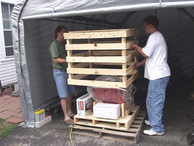

Well, got the hoist assembled and THATS IT for now. 10:00AM and the heat index is already past 100. This sucks! Anyway, I'll get back to it once it cools down some.
Now for that nice cold shower

Well, the engine hoist is assembled and the motor is on the stand (finally) I'll start stripping off the parts I don't need off the block later today. I'll post some pics tonight. It’s been awesome today so I've been driving around in the t-top instead of working on the car. Oh well, gotta play sometime
Rob D.

Originally posted by Archie:
Well I was working today.
https://www.fiero.nl/uploads/Mvc-174f.jpg
Archie
Mmmmm.... that looks nice! Is that the ZZ430? I do believe I spy a SPEC assembly on there as well! Guess it really will be to the test

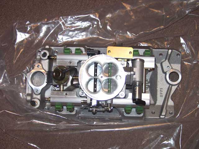

...this is what is going on it instead
Rob D.
Yikes!!!
You're just trying to get Archie to replace your axles, aren't you?
From the Department of Redundancy Department.
That it is, with the Street & Performance Ram-Port Injection setup on top. I'm pretty sure it'll be enough power, even for me.
