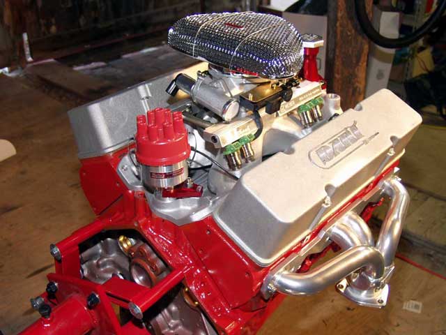

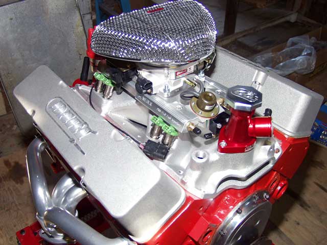

Well FINALLY got some work done on the V8. Stripped all the "extra" stuff off the motor and replaced it with what I intended on using. I'm getting antsy Can't wait to light em up! Here are some teasers...
Haven't had much time cause of work but I'm in no rush (yeah right !). Do want to get it right the first time
Modified 2.8 (Soon to be a 383 V8 )
2.5" Drop
11" Brakes
17" Revolutions
RCC Coilover Suspension
New web site! www.dirtyratracing.org
[This message has been edited by chester (edited 07-12-2002).]

Man! What a beaut! You can eat off that thing.
The Dart valve covers look a little tall. I hope you don't run into clearance problems with the decklid mounting bosses.
Farknocker.

Damn thats purdy Rob! Almost too nice to put in a car!
Would make a nice center piece for in the living room....;p
Can't wait to see that in person. When I deliver Bob's V8 to him in MA, I'll either drop by on the way there, or back.

That is a beautiful motor your putting together. Just a note, that air filter looks great but it has some issues.
From experience working at a speed shop... They don't really flow all that well and the foam element is FLAMMABLE. The flammable part shouldn't be a major concern on a dialed in injected engine since it's a dry flow intake, but I used to sell a lot of replacement air cleaners or filters for people that had a intake pop with a carb setup and the foam left nice plastic goo as it got sucked flaming into the intake. You may want to get engine dialed in with the larger aircleaner they sent you before running that one.
No flame ;-)
Just a suggestion.

I had one of those "foamie" air cleaners until recently.
Every time I went to clean the element I had to wipe out the INSIDE of the base plate because it was dirty.
I never could get that thing to seal around the edges of the foam.
Now I run a K&N 9 inch air filter with an X-stream top. It seals tight, no dirt gets by.
I wonder how many miles I lost from engine wear caused by the dirt that got by the "foamie"?
Farknocker hit that one on the head. I sure hope it fits, Rob.

Chester, nice to a see a clean new monster!!! suggestion: don't forget to plug the lower bolt hole between the timing cover & the fuel pump plate. If that hole isn't plugged with a short bolt, you'll have oil pissing out all over that beautiful engine. It's a common mistake... the hole is used to lock(hold up) the fuel pump shaft when installing the 'old' fuel pump.
good luck, Sandy

Thanks for the air filter tips. I'm just using the filter temporarily untill I get my custom cold air induction setup made once the car is put together. Funny how some of you mention the melting element. I used to run tht filter on my 360 moper for years without any incident. Go figure

Chester those Dart valve covers are sweet! I think you can fit the covers in the engine bay. Looks like you will have to remove the passenger side hinge on the decklid or severly modify it. Can't wait to see more pics of the install.
Jim

Looks totally friggin sweet Rob :D)
One suggestion though, I'd ditch that particuliar air filter. I've heard nothing but bad things (good 'ol K&N never lets you down. It'd be good actually to vent air in from the 'stock' Fiero's intake duct in the driver's side (just run big tubing all the way, give the engine cool, fresh air.)
But yeah, aparently even just *any* other filter is better than those 'block 'o foam' style acording to my mustang buddy (take for what it's worth. He says they melt? & gung up carbs...)
Best!

I'm thinking that setup will need a decklid scoop for clearance, so cool air shouldn't be a problem. Might even consider sealing an air pan to the decklid like the old Ram Air Firebirds did back in the '60's. I agree with Ben, I'd ditch the foam air cleaner. If you've got the clearance, especially with a hood scoop, I'd suggest a good 14x3" air cleaner with a K&N element. Moroso has one that sits pretty low, it it'll clear everything.
We'll see. If it doesn’t clear, the project will set me back a few months. I have some creative deck lid ideas . The filter is temporary till the motor in and all clearance issues are addressed. Thanks for the input.
Even with a scoop, you may be limited to going with a 9 - 10" diam. air cleaner unless you want to modify the underside of the hood and the grill.

That is a beautiful motor. Can't wait to hear how that FI setup works for you. I've often wondered how they would work in a Fiero.
Keep us posted!

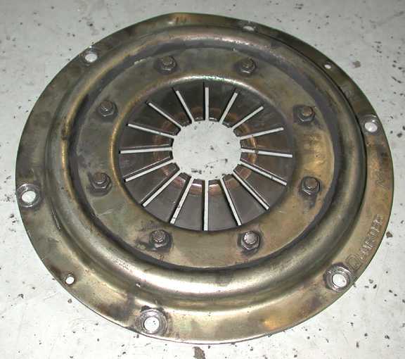

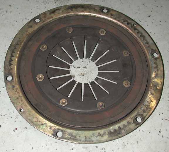

Couple more photos of the QuarterMaster parts:
Titanium Housing ring mounted on flywheel:
Outer side of pressure plate, plate ring not pictured but can easily be seen in cross section drawing in this string. The set of disks going in is the last for this pressure plate, note some wear on diaphram fingers (has been in car since 1993). Will replace next time:
Inside of pressure plate shown without pressure ring:
All parts are super light, for less rotating mass, including flywheel.
