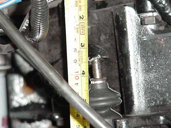

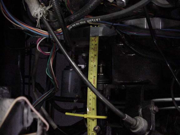

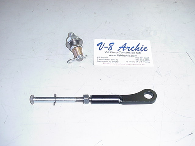

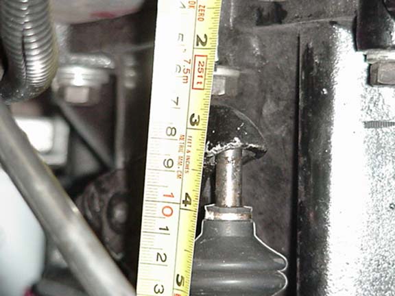

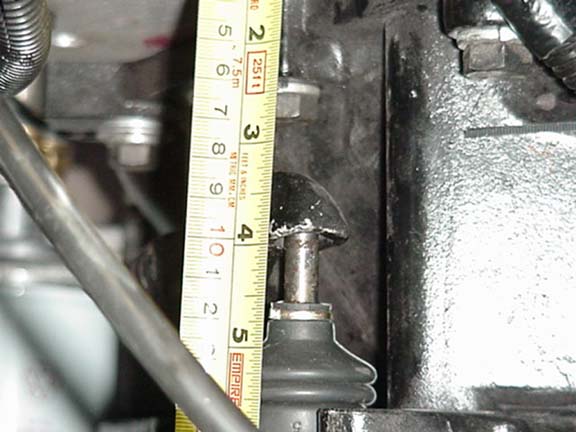

In a previous post, I had mentions a small problem I had found with the SPEC clutch, that I had never seen before, & that I was sure that it could be solved.
I'm going to try to explain the problem and the solution now.
I'm sure that many of you have seen the subsequent reports from Dave & myself telling how much fun this car is to drive. So it should be clear by now that we indeed did find a fix for the problem. You'll recall that we had said the short release on the fixed clutch was like an "On/Off Switch".
Here is what the deal was & how we caught it.
We had bled the clutch on this car and, as I always do with any car right after we finish bleeding the clutch, we "static" tested the operation of the Clutch. Typically when we static test the clutch we do the following. With a driver in the car and the engine OFF, we have the driver put the car in gear & push the clutch down and we rock the car back i& forth. Typically the car will roll back and forth easily. Then we'll ask the driver to slowly let the clutch out so we can see when it starts to grab. In this case with the pedal depressed we could feel "drag" when rocking the car. As we were trying to rock the car, I had the driver start to let the pedal up slowly....... what do you know.... when he let it up just a little bit, the car began to roll very easily.
I immediately began to think that the clutch was over traveling & the diaphram was lightly dragging on the clutch disc it'self. After years of trying to maximize the travel of the hyd. system, could it be that now I'd have to find a way to limit the travel?
I immediately went to the PC and found pictures of the SPEC clutch. When compared to the CForce or the stock clutch it appeared that diaphram pivot points on the SPEC are closer to the center than any other Fiero clutch. Now this isn't necessarily a bad thing. The closer the diaphram pivot points are to the center of the clutch the more clamping power that diaphram will make. However, the closer the pivot points are to the center of the clutch the quicker the release is.
The following pictures show what we were seeing as we rocked the car back & forth.
You'll note in this overview picture that we taped a tape measure into position to be able to take comparative readings. The actual tape measure values are not important, only the differences are important.
Here is where the clutch arm was positioned when the pedal was all the way up.
Here is where the clutch arm was positioned when the pedal was pushed all the way to the floor. Remember in this position, with the car in gear and not running, some resistance was felt when we tried to roll the car.
After the pedal was pushed all the way to the floor then let up just a little to this position it would roll just fine. Also from this position we noted that if we let the pedal up just a little more, the clutch would start to engage.
The solution?......... How do you limit the pedal throw and still have it adjustable so you can dial it in?

Well you could put a piece of wood under the clutch pedal..... but with the very short release travel (this thing only takes about 3/8" total travel from off to on) you would have to be trimming the pc. of wood to get it dialed in just right.
You could put in a different length shaft on the slave cylinder so that the piston in the slave would bottom out at just the right time . What with the short travel you'd be adjusting the length of this rod several time..... & besides if make this rod too short too quick, you can bend the Banjo and have another problem to solve.
You can remove the master cylinder and use washers to space it out away from the front bulkhead. Plan to work on this for a little while to get it exactly where you need it.
All of these solutions would work but they are really tacky solutions. I recommend you take the high road and use the solution I worked out.
Enter Rodney Dickman...... He makes an adjustable Banjo. He didn't design the Banjo for this problem but it solves this problem just sweet as heck.
You will recall the picture from above that shows the perfect place we wanted the clutch arm to be in. We just left the tape measure taped in place and installed Rodneys' banjo (don't need the new pin shown next to my bus. card in the above picture). We adjusted the banjo so that when the pedal was pushed in the arm ended up in the same place as we had determined was the perfect position as shown above.
When Rodney 1st. came out with his banjo, he saw fit to send me one. His forthought made it easy to solve this problem for our customer in a professional manner. No wood pedal stops or hack saw or flat washers needed, a professional solution for a professional looking job.
Thanks Rodney for a well made part that solves a problem that didn't exist when you made the part.
Please note, this problem may not exist on all Fieros with a SPEC clutch but you'd be wise to check for it from the get go.

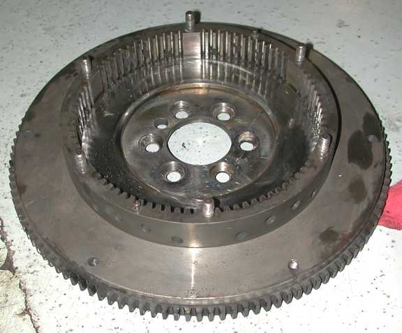

Couple more photos of the QuarterMaster parts:
Titanium Housing ring mounted on flywheel:
What's the dimension from the tops of the bolt heads/the surface with which they are flush to the friction surface?
I'm trying to figure out packaging that in my N* conversion.
Conical Bolts sit flush with flywheel (same plane as bottom of steel insert ring), requires very accurate machining to match flywheel bolt pattern to crank. Also, locktite (non permanent) is recommended.
