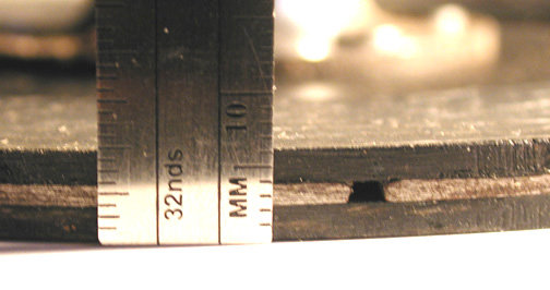

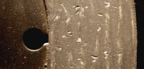

Update on clutch life: Well I've got 17,000 miles on this set of QM Disks and the first signs of slipping has appeared. I could probably get another 2,000 miles before replacement if I drove it like a normal car, only noticing the slip in the upper torque range when disk's are cold. Considering what I put this car through I am not at all disappointed.
Time for me to make a list of additional things I want done while the car is up on the hoist with the trans out. Like paint trans case, new needle bearing/seals for trans output case, jet hot coat headers/exhaust system in color, etc.

Report this Post06-18-2002 02:53 PM Click Here to See the Profile for crazydClick Here to visit crazyd's HomePageSend a Private Message to crazydDirect Link to This Post
Having seen the thickness of a QM disk first-hand, I'm surprised they lasted that long, CK. The FM depth on either side couldn't have been more than 1/16". There has to be a better way.

Report this Post06-18-2002 09:31 PM Click Here to See the Profile for California KidSend a Private Message to California KidDirect Link to This Post
Dave, the reason the material is thin is because it will retain less heat, which kills torque holding power. The material QM uses is a hybred composite and very hard "cast like" material, difficult to mark it even with a knife. It appears they bond the "cast material" to the steel disk, then put the disk in a machine to grind both sides "true", as there are fine grind marks on the new disks. Pics below:
I'm very satisfied with this kind of holding power and mileage until someone finds a way to beat this setup, so far I've found no one.

Report this Post06-18-2002 11:29 PM Click Here to See the Profile for crazydClick Here to visit crazyd's HomePageSend a Private Message to crazydDirect Link to This Post
Yep, I was awfully close, I count 3/32". If it were a car tire it would barely pass inspection.
Yes, but our goal here, after all, is to see if we can find one that gives the kind of holding power that the QM does but with equal or better drivability and a minimum of double the service life.

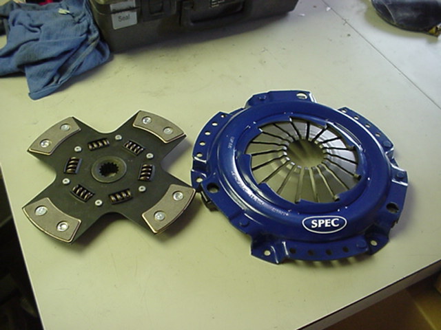

Chester, you'll be pleased to know that it's official, we're going to do a SPEC in my car too. Even though my motor's a bit milder than yours will probably be, it's still a significant datapoint.

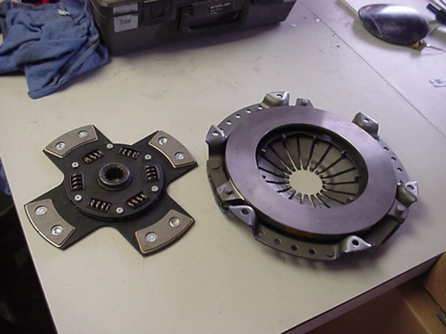

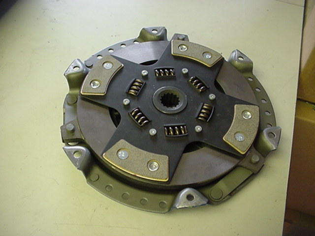

Of course. David Norton at SPEC assured me that there would be no problem with a 400ft-lb. motor on the stage III clutch.
There is a 350 mile break-in of typical city driving, which is gonna be hell, but I'll be breaking in the motor too so it's compulsory.
It will be at Archie's on Monday or Tuesday of next week, and everything should be ready to go for that install. There have been requests for this to be an online-buildup similar to the Stinger, and Archie gave that the green light, so be on the lookout for that topic to start here on Pennock's next week.

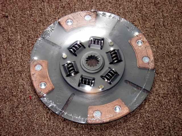

The picture is becoming clearer now! They sent me the wrong set of disks (box of 3) about two years ago. They looked just like mine, but instead of the black friction material, they appeared to have a very thin amber coating that was only just slightly off the surface in thickness (like 0.3 mm thick). I called QM thinking that the disks missed the operation where the lining was supposed to be positioned on the "glued" surface. They informed me that someone screwed up and sent the metallic disks.
Those might be pretty tough to use on the street, your going to have to release it quick and these will really create positive lock up. You've got "mega" surface area compared to the metal disk shown above in this string. On the down side, it rules out going 3 disk organic, unless you shim the housing ring slightly away from the flywheel and have QM make some disks with just slightly thinner lining than they currently supply (shouldn't be a big deal, minor adjustment to machine that surfaces lining material).
I need to investigate further now, as Keith Huff said the 3 disk wouldn't package without modification to the trans (supposedly splined portion of trans shaft just slightly short to hold 3 disks, from what I was told), and I thought he was talking organic 3 disk. Now I wonder if the 3 disk metallic (since it uses same housing) will work in my car??? I had a machine shop machine off 0.020" of the QM housing ring (maiting surface to flywheel) to improve the clutch stack (little less air space between disks on disengagement). Worked real well for the organics, new disks grabbed when clutch pedal was just sligtly off the floor, and after break in the pedal engagement height was pretty darn close to normal. Would probably need the 0.020" back if I went to metallic 3 disk setup (shim ring is easy, ).
How are they doing on your setup? Be sure to post some pics when you get the parts.
Dave
Is this what you were expecting Dave?
Archie
We don't even need to install that thing to know it's not going to work. I'd say Mr. Norton and SPEC have some explaining to do when they get to their top-floor corner offices in the morning.
Dave
Archie
Dave, I don't see a big difference between the picture above and this one Chester posted
Archie

Is that what he calls the stage 3 clutch? Doesn’t look too much different from the one I have. Can't tell if the pad material is the same or not. Let us know what Dave says when you talk to him crazyd. I'm getting ready to do the install in the next couple of weeks.
Oh, also why do you feel that it won't hold? Just cause it’s shaped like the one on Archie’s wall of shame? (Is this a setup or what? ) Don’t necessarily mean that it’s using the same pad materials. (I hope )

Can you assess and tell us if the pad material looks to be the same as some of the clutches that you have had fail in the past? Namely the four puck (if I recall correectly) hanging on your wall. Could you possibly post me a pic of the two side by side as well? Just curious. What do you think Archie?
Why, in the space of two weeks, would we get shipped two different clutches in spite of requesting the same one? Why, after you tell them you're doing a big buildup of a megamotor on a major online Fiero forum, you get one clutch, and then I, Joe Nobody, get a different one? Something smells very fishy here.
I think it's obvious that it isn't.
The resemblance is uncanny, don't you think?
It looks exactly like the Wall of Shame clutch. I've stared at that thing in person long enough to know it as soon as I see it.
Archie,
I can post a picture of the 2 side by side tomorrow.
I saw Chester's clutch in person at Carlisle and as I remember it, the material on Dave's clutch appears to be similar in texture and content to what Chester has. Overall color doesn't match.
The material on the FS Clutch is wimpy lookin compared to the 2 clutches pictured above. There is no doubt that the FS clutch IS NOT the same material as the 2 pictured above.
Archie

"Four Puck" clutches are some of the best gripping single disk clutches made. They are aggresive, but thats the price you pay for a race clutch. These clutches are all about NOT slipping, they sacrifice everything in terms of ease of use(don't want to be in rush hour with one of these) and they ussualy come with a high clampload pressure plate that requires more pedal effort.
The Fiero Shop clutch that Archie used is not a good example of a four puck clutch.
I may end up buying the stage three after talking to SPEC for the last 6 months. I wouldn't mind the extra pedal effort with this clutch, if you ask me I think this is the sort of thing that adds to the character of a sports car IMHO.
