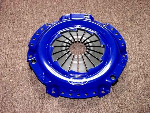

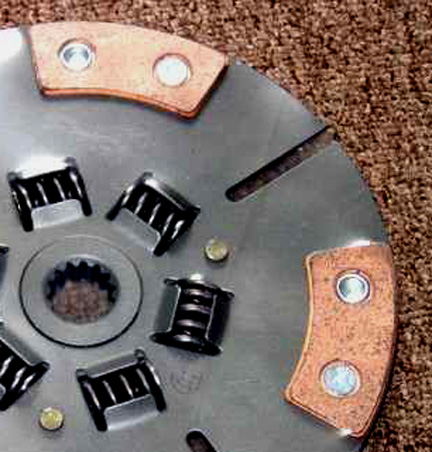

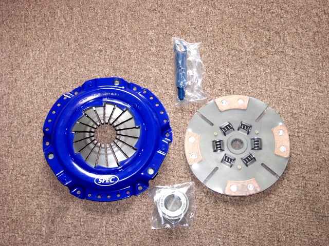

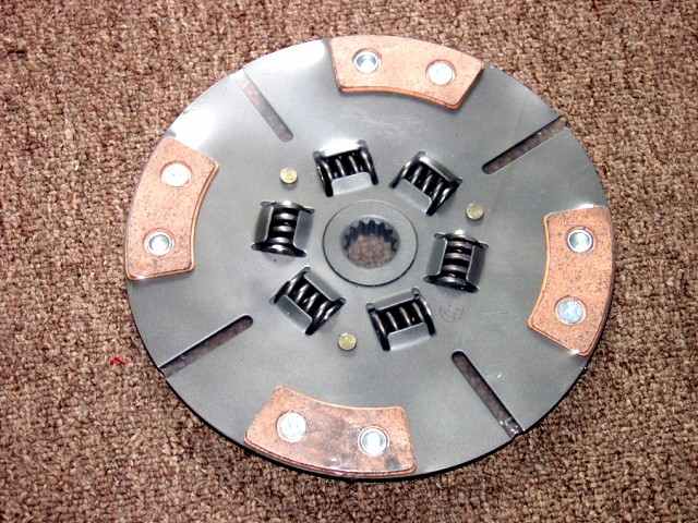

Ok, clutch arrived as promised. That's always a good start
Here are the pic's;
So there you have it. I will bring it with me to Carlisle for those of you that would like to examine it in person.
Rob D.

Report this Post05-16-2002 02:34 PM Click Here to See the Profile for Joe TormaClick Here to visit Joe Torma's HomePageSend a Private Message to Joe TormaDirect Link to This Post
Huh...doesn't look like there's much to it!
Since I got a standard dual friction Centerforce, I'll be interested in how these other clutches perform.
I only broke-in my clutch a little in my driveway before I beat on it, and it felt great...just wondering what will happen a few miles down the road, especially when I strap on the supercharger.

Is that what it looks like to you? They told me that it was a carbon/ceramic composite? Are you sure? I might want to call him in the AM and inquire! If it is actually a sintered metal clutch, what are the advantages/disadvantages? I'm assuming it eats the flywheel as well (metal on metal). Would I get the miles out of it and just have to replace both the flywheel and clutch at the same time? Anyone have experience with sintered metal clutches?

Hmm...looks like metal to me (I've never bought a metal clutch, mind you). A carbon/ceramic would be a lot darker in color (carbon being black). I'd make a call and verify what you've got.

Report this Post05-17-2002 12:00 PM Click Here to See the Profile for California KidSend a Private Message to California KidDirect Link to This Post
Is it an illusion or are the rivets retaining the pads, very close to the surface? It appears that you wouldn't have to lose much lining material before they contact the flywheel.
I'm not a clutch design expert, and I'd cetainly want to understand why you wouldn't have to worry about this.
Can't wait the hear your test results and durability, I may be wrong, but I don't think it's going to last very long, pretty small surface area for transfering torque. Also can you let us know your HP/Torque numbers, trans model, make, and size tires?

Report this Post05-17-2002 02:09 PM Click Here to See the Profile for artherdClick Here to visit artherd's HomePageSend a Private Message to artherdDirect Link to This Post
Oddly enough, the small surface area is good (well, sort of, it means it won't slip as easially ) Keeping the pressure plate the same stregenth (say 2,000lbs) if you decrease the surface area of the disc, you *increase* the loading/per-square-inch.
It *does* look like metal from here, but I sure can't say for sure. It's entirely possible that a ceramic/carbon hybrid could have almost any colour (depending on where/how the carbon is mixed with the ceramic meterial, and in what proportions, and what colour the raw ceramic was...)
What it boils down to is: It's gonna chatter a bit (I bet) and yeah, I'd just replace the flywheel when you replace the clutch. It should last quite a while, wether it's made of metal or ceramic/carbon, it ain't going to wear-down very fast! (probally at close to the same rate as the flywheel, grin )
Just thinking about your next clutch change (I do expect you'll get some decent mileage out of it, unless it slips, which I'm betting it won't; a steel/steel frictional coefficent is huge!) But yeah, when you pull it, you'll want to NOT be out of flywheels )
Let us all know how it goes, looking forward to seeing your car!

Chester,
I am afraid you are going to learn to hate that clutch, unless all you do is race. That thing is going to chatter your teeth out of your head and shake like you are on an old dirt road if you attempt to let it out easy after it has been heated up (heavy traffic, etc).
This is much like my RAM 900 clutch, but even more aggressive.
Notice the individual pads on the disc in my picture here. This clutch is super tight, holds tons of power, but is terrible in "normal" driving situations.

It might not have much pad before the rivets, but it shouldn't wear anything like an organic pad. The flywheel will be showing the wear. I could chirp the tires into third gear with a stock pressure plate, 4-puck unsprung clutchnet disc and a V6! It's more streetable than you think. You just get used to it... I put a couple thousand VERY HARD miles on this setup combined with the punishment 1FST2M6 gave it with nitrous oxide and it still worked perfectly when I pulled the engine. The flywheel was worn a bit, but not as bad as you'd think! For a V8 I'm using a better pressure plate, and clutchnet just replied about it, so we'll see what they offer.
