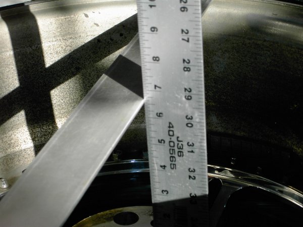

While I was at Custom Auto, Jim measured the "backspacing" on the 20x11 rim. The rim measured 6.5" backspacing.
The "formula" this site ( http://www.rims-n-tires.com/rt_specs.jsp ) resulted in the HRE rim being 14mm off-set. I tried using the other formula but it doesn't "jive" with the rim/spec site. Something is missing in the formula but I'll continue to plug-in the numbers. However, Troyboy measured the back spacing on a stock rims and the rim/spec site was correct in it's measurements.

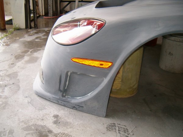

Norm is Venting:
Both Vents and Corvette side markers are on! Norm is sending (ruff) pics today. Please stay tuned.
[This message has been edited by madcurl (edited 07-03-2006).]

Report this Post07-03-2006 07:36 PM Click Here to See the Profile for Mr. PatClick Here to visit Mr. Pat's HomePageSend a Private Message to Mr. PatEdit/Delete MessageReply w/QuoteDirect Link to This Post
where's the bloody pics????
Pics are on the way soon. Norm was at a non-Fiero car show during the 4th and just got back on the 8th. FierogtGuy and me will sport the C6 flipper at the CTHC and the Fierorama show.
Norm....please send pics!!!

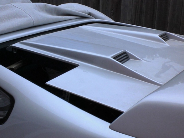

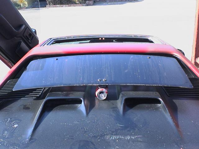

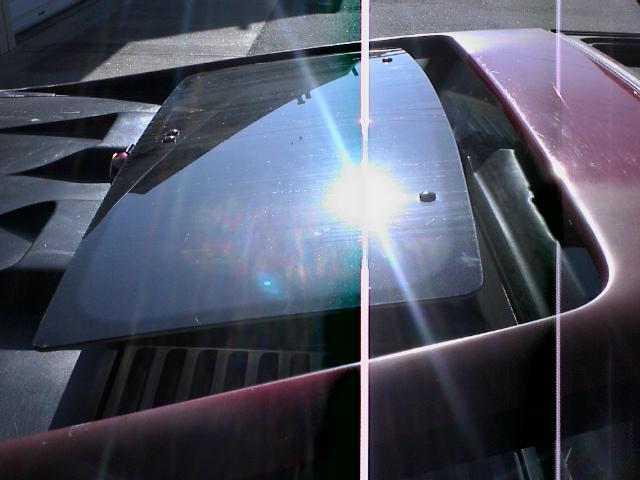

No comments ? Hmmm well how's about a few pics of a mock up for this car's next mod ?
Note, the car pictured is not Madcurl's choptop #20 but rather his choptop #15.
This mod will be going on choptop #20.

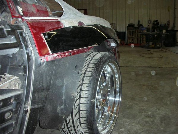

Oh yeah and back to the widebody work.
The true genius of Madcurl's work is usually not evident until it is mostly finished.
I hope you are going to use at least 4 layersa of glass over the plastic fender then remove it as glass will not hold permanently to the fender it will separeate in about 2 years I used smc rear clip sections to widen my rear clip
here is the link https://www.fiero.nl/forum/Forum1/HTML/033676-35.html
[This message has been edited by bubbajoexxx (edited 07-21-2006).]
It shouldn't if you used a TPO primer before the fiberglass...

All I can say if you move that piece of glass 2 feet forward it will fit perfectly in the hole in the roof
it is the differance in materials that cause the separation glass dose not expand but the plastic fender is constantly contracting and expanding with changes in temp tested a quarter panel and it pulled apart on its own after 18 months and it was good and ruff before it was glassed
Archie lays it on very, very thick and since 2001 I haven't had any issues on #011, #015, The Redux, and hopefully #020.
Trust me, it will be moved forward, hehe. This idea hit me after #020 was dropped off which was a carry-over "pipe dream" from #011 when I was getting the hindges chromed. Not wanting either of the cars to be too clones, #020 was pinned for rear "flipperism."
Original idea from #011 (back in the day)
[This message has been edited by madcurl (edited 07-22-2006).]
i know youve said this a couple times before.. i dont know what you did, but ive had my panels glassed onto for years now, not one crack... theres also alot of other people who have glassed onto those panels and had no problems.

More Madcurl Madness being implemented with #20.
Can you say operation Moon Raker !?!!

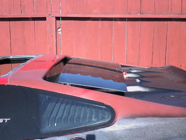

Report this Post07-25-2006 10:50 AM Click Here to See the Profile for exoticseSend a Private Message to exoticseEdit/Delete MessageReply w/QuoteDirect Link to This Post
A different angle

Report this Post07-25-2006 11:03 AM Click Here to See the Profile for RCRSend a Private Message to RCREdit/Delete MessageReply w/QuoteDirect Link to This Post
I was seriously considering a powered moonroof. What is that off of, or is it an aftermarket piece?
Bob
http://www.webasto.us/am/en/am_auto_sunroofs.html

I think placing the sunroof glass there looks su-weet!

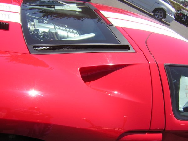

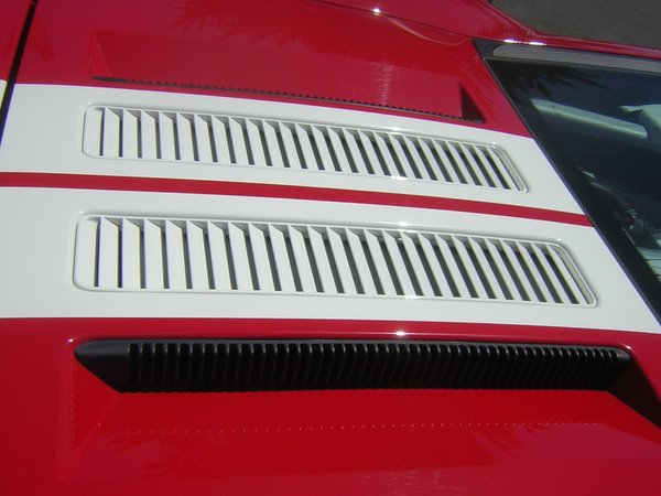

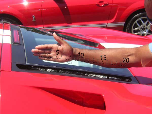

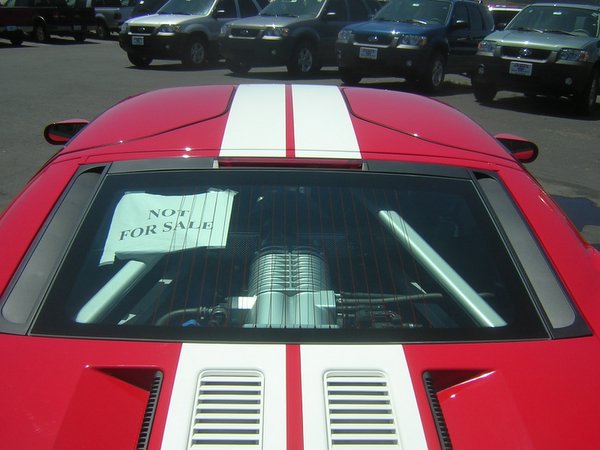

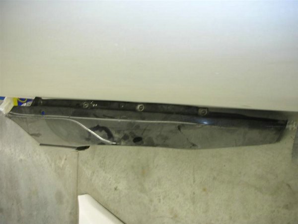

During my lunch, I paid a friendly RECON visit to the local Ford dealership today and viewed the GT40 and the Shelby GT. I was in “LURK” -mode plottin’ the GT40's sides deck vents and cost.
The side vents (lt & rt) of the rear deck glass are $117.69 per side. The deck lid vents below the deck glass are $198.68 per side. The rear deck lid glass is $1,572.68. The parts guy wasn't the usual person I normally buy parts from so he asked me if I drive mine. I told him.... yes. I do, hehe.
After I got the prices, I headed out front to where the GT40 and the Shelby on display. The sales rep remembers #015 and asked about the progress on the dash and stuff. He knew that I was up to my old tricks in purchasing various parts including parts from the GT40.

Report this Post07-25-2006 10:37 PM Click Here to See the Profile for exoticseSend a Private Message to exoticseEdit/Delete MessageReply w/QuoteDirect Link to This Post
The pics from the visit !

Curly how did those measurements i sent you match up with what you were checking out ?
Close ?

What happens when Madcurl and V-8 Archie collaborate ??
Mad-Arching !
i spy a scoop where the qrt window would be... unless that's a nochie with the sail extended back?

Archie,
What kind of rivets are you using here to secure the new outer fender to the original stock fender ?
Archie
Posts: 9436
From: Las Vegas, NV
Registered: Dec 1999
Total ratings: 547
Report this Post08-03-2006 05:24 PM Click Here to See the Profile for ArchieClick Here to visit Archie's HomePageSend a Private Message to ArchieEdit/Delete MessageReply w/QuoteDirect Link to This Post
Those are self tapping screws, just used to see what it would look like on the car.
It'll take a lot more than screws or rivies to put that on there correctly.

Originally posted by 88White3.4GT:
[QUOTE]Originally posted by exoticse:
Mad-Arching !
O snap, after you pointed that out I looked up at the picture that is from the back and it looks like something like say, a decklid, would fit in the gap created. Look at the other picture, the one from the back angle, you'll see what I mean.
