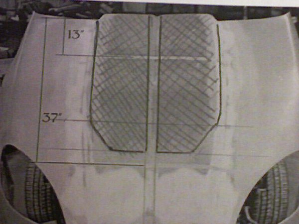

Pipe Dream: imagine the possiblities....

Still dreaming:

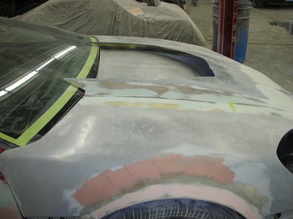

Well, we are going to need amazing to get this baby in there.
The MB wiper assembly came in &, as suspected, it's a lot bigger than the EBay ad made it appear.
From now on this assembly will be referred to as "The Crab", you'll see why when you look at the pictures.
Notice how tall the Crab is when in the side view. Notice also how it's being heald by it's claw with it's legs hanging down.
Here it is in it's attack mode as it is attacking our windshield.
How'd you like to have this crawling up your chest?

WOW....that thing IS huge!
I'm not really sure how you'll make that one work, but I know you have something up your sleave Archie!
Can't wait to see this part of the car completed and working.

I have no doubt that you can make it fit in there, Archie. Just keep thinking how cool it is going to be when you get it done.
Make a few cuts where it will fit down inside where the current wiper mechanism is and it will work out fine.

Operation: King Claw, hehe.
"Anyone can make a copy of something, it may look good but it ever is the real car. Make something from your imagination, something unique, something nobody has, anything is possible and, ideas can be a reality."
[This message has been edited by madcurl (edited 03-01-2007).]

Where will it sit when "king claw" isn't being used? :O

Wow...that is way bigger than I would have expected it to be. You've got your hands full trying to conceal that.

Hmm. It'll be Pinching something??

It's too bad you'll have to mess with the tightness of this cowl hood.
I guess it may be a blessing in disguise to be able to hide the claw under it!!

Welllllllllll,.....not quite hehehehehe
Stay tuned.

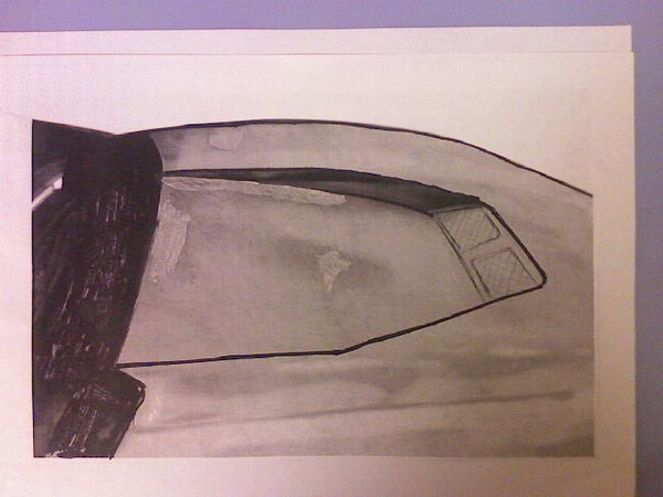

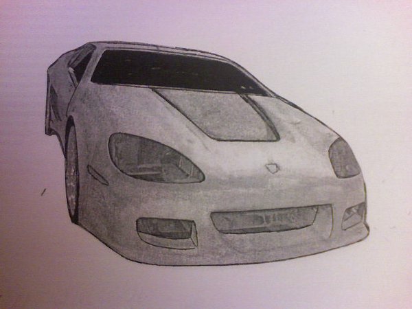

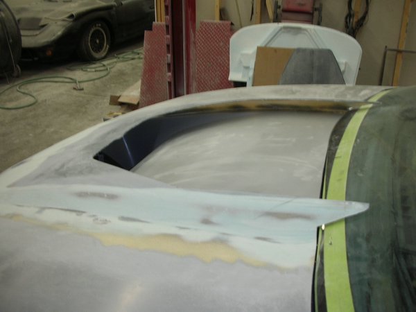

If you follow the sketches and concepts it appears the top of the cowl will be coming off, thus exposing the claw
madcurl
Posts: 21401
Total ratings: 314
Report this Post03-01-2007 05:54 PM Click Here to See the Profile for madcurlSend a Private Message to madcurlEdit/Delete MessageReply w/QuoteDirect Link to This Post
Hmm. Part of the three or four "clues" was on a previous page.
The madness continues,.......
I will say this: The scoop (cowl as some call it) is actually a "head-fake" for other items not seen right now. I guess the key word is, "tweek" cause I rarely bolt anything onto the car w/o first doing something. Granted, 4.9, "Archie and the Crew" and others have aided in tweeking items too along the way.

We didn't see any real problems based on the pictures on EBay either but after getting the part you realize how heavy the modifications are going to be & what the trade off is going to be to make it work.
Here is a copy of the pictures and analysis that I sent to Curley after we had a chance to look at it in it's Full Size.
ITEM A) Starting with picture 5549. The “flair” that we are going to have to put on the hood that will have to flair up to cover the base of the windshield will need to come up to cover most of the green tape. It will have to start 4 or 5 inches forward of the base of the windshield so that it will taper smoothly up over the windshield. You’ll need to keep this in mind as we talk about the wiper because the wiper has enough swing that it will violate the green tape area at both ends of the sweep of the wiper.
ITEM B) In picture 5733 we have the wiper assembly up as close as it can be to the windshield & located in the center of the car. In this picture the wiper blade is at the lowest end of it’s stroke on the drivers side of the car. Please note how much of the green tape the blade covers. Also note that at the other end of the stroke on the passenger side of the car it covers just as much of the green tape. This means that the “flair” of the hood is going to have to be notched out to clear the wiper or it’s going to have to come out quite a bit higher above the windshield so that the wiper & arm stay below the “flair”.
NOW, we’ve covered the fore & aft location of the wiper & the left to right location of the wiper. NOW for how DEEP we can mount the wiper assembly.
ITEM C) In picture 5724 you’ll see the area I identify as the Rubber Seal. When we dig the hole to mount the wiper assembly down into, we will not be able to mount it any lower than where this rubber seal will be even with the face of the windshield. If you look at the area in this picture above the rubber seal you’ll see that the wiper assembly “head” is at least 2-1/2” above the rubber seal (see 2” x 3.5” business card in picture) If you’ll look at picture 5535, you’ll see that in the center of the car at the base of the windshield, that the windshield is at least ½” above the current location of the hood. So the “Bubble that is going to have to be put on the hood to clear the head of the wiper assembly is going to have to be at least 3” taller than where our “flair” was going to have to be in item “A” above.
ITEM D) Now when we dig the hole to mount the wiper assembly down into, we may run into another problem. The area where the stock Fiero wiper arms are normally mounted is only so deep & I’m concerned that it is not deep enough & that is cannot be made deeper. Go back to picture 5724. See the items I’ve marked “Actuator & Actuator arm” When the wiper is turned ON these parts are moving. When we get the wiper assembly mounted deep enough to get the rubber seal in the area described in ITEM C above there may not be room for the Actuator & Actuator arm to work in. You don’t want to take the floor out of this area because then you’re getting into the heater & A/C & blower motor area.
ITEM E) I just noticed this & it may be a problem too. Go back to picture 5724 note the “Wiper Motor” is Higher than the Rubber Seal. There could be a problem clearing this too in the same areas as item “D” above.
So there you go, these are just the items I’ve found so far, I’m sure that is not all we will run into on this.
Now no one is saying that it will not work, however it will take sacrifices & we have determinded that we don"t want to make those sacrifices.
So at this point we've decided to use a cable drive single wiper like I used on my GT40.
Hope that helps
Archie
