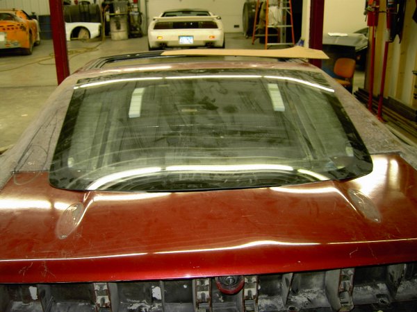

After the trial fitting of the dcklid & 350Z rear window, we had to do the leg work to make it all workable.
I think some people don't realize what all it takes to make things like this functional.
After getting the framework ready for the window & welding that to the decklid structure, I consulted with Curley. We determined that there was no desire to make the left & right sides & the top of the window waterproof, but there is a need to have the lower end of the window seal. That way water won't have a chance to get inside the trunk & the small decklid.
Considering that the 350Z window is going to be bonded (with Window-Weld) to the framework & that the Left, Right & top of the window is going to extend out past the framework, we still needed a waterproof seal at the bottom edge of the window. We also need the underside & edges of the decklid to have a finished look. So it took a little time to get that done.......
We had to establish a surface to seal the window to along the areas marked in Red.......
We used a piece of 1/2" box tubing & bent it to shape, put plastic tape on it then attached it to the top of the rear window framework. When we are done glassing it, we will remove the box tubing & we will have closed in the area between the framework & the decklid.......
Note that we also scuffed-up the underside of the decklid so we can glass the whole thing.
Then we glassed it all in.......

Once we removed the box tubing, the underside of the decklid was bonded to the framework & the seal area looked like this.........
A little bit more fiberglassing & the underside of the decklid will be completed.
Then it's time to address the tops of the doors.
Curley wanted the top edge of the door to get taller as it goes back into the quarter window area. So we cut off the top of another door skin & did some trial fitting.......
Here's what it looks like before we glass it in......

Originally posted by Songman:
I'm ready to see the ideas for the vents around the rear window. The window looks cool alone, but you gotta get all of that hot air out of there. I know it's in the works. I just want to see ideas.
Clues are located on pg 9.
Songman
Posts: 12496
From: Nashville, TN
Total ratings: 309
Report this Post10-01-2006 10:10 AM Click Here to See the Profile for SongmanSend a Private Message to SongmanEdit/Delete MessageReply w/QuoteDirect Link to This Post
Oh, I've seen page 9. Now I am ready to see what you really have planned for back there.
Actually, I've already got a plan for the venting of the rear compartment.
This thread was originally started so that people could see how a lot of the custom stuff was done on Curley's other cars. I was thinking that when the home Fiero hobbyists saw the details on how to work with the fiberglass they wouldn't be so afraid to try their own little projects. However, With all the negativity I've seen about this car, I don't blame the Fiero hobbyists for sitting on their hands.
I've known Curley for quite a while now & for some reason he has an eye for how something is going to look once it's finished. Several times during the early building on #11, #15 & the "Bubbletop" he would tell me about his ideas & I would tell him it was going to look terrible. But then it turned out pretty good. I don't critique his ideas negatively anymore. I only critique his ideas based on functionaly implementing them into the rest of the car. After all, he hasn't built an ugly one yet.
I have talked to Curley about how we're going to vent the engine compartment area & we pretty well know what we need design wise. WE have an area that is only a few inches wide (on either side of the window) & we have to make it look good. It also has to match from the left side to the right side exactly. The Fiero hobbyists should note here that designing one side of the car is easy, getting side #2 to match side #1 is the hard part. Now we could buy some off the shelf part & put it in there (& we've considered that) but we've decided to make something custom. On these vents, the only way to know what they are going to look like is to build them & once you've built them it's gonna be pretty hard & expensive to make big changes to them. So, I've decided to go with my concept for the vents. Curley & PFF won't see them until they are finished. Then if you like them, that's fine, if you don't like them, that's fine too. Then if people want to know how we made them, I'll show the inprocess pictures. Otherwise we'll just move on with the rest of the car. In fact when they are done, I just might give you guys a few days to guess how they were done.
In the meantime please feel free to speculate how you would do them.
Gee, now I sure hope my idea works.
Archie
[This message has been edited by Archie (edited 10-01-2006).]
