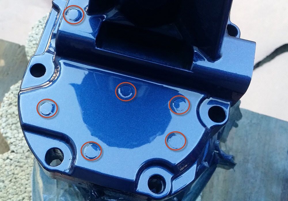

Report this Post03-01-2016 06:53 PM Click Here to See the Profile for JohnWPBClick Here to visit JohnWPB's HomePageSend a Private Message to JohnWPBEdit/Delete MessageReply w/QuoteDirect Link to This Post
After watching TONS of Youtube videos, doing some research on paint types and such, It has ALL paid off! I painted the Super Charger main body and the snout today after work. I did a fine mist of the base coat, and let that sit for a few minutes. I then did the full coat, and allowed that to flash over for 15 minutes. I then did the same with the clear coat, misting, then a full coat after 15 minutes. Then a second, and final clear coat 15 minutes after that.
I am VERY happy with the results!
Here are the main body, as well as the snout after the final clear coat:
Here is a closeup of part of the snout, it came out like GLASS!
[This message has been edited by JohnWPB (edited 03-03-2016).]

Report this Post03-01-2016 08:09 PM Click Here to See the Profile for Napoleon_TaneriteSend a Private Message to Napoleon_TaneriteEdit/Delete MessageReply w/QuoteDirect Link to This Post
Wow, very nice. I've very interested to see how these turn out. Our two cars are VERY similar colors, so I want to see how the blue parts look in a blue car.

Report this Post03-01-2016 08:43 PM Click Here to See the Profile for JohnWPBClick Here to visit JohnWPB's HomePageSend a Private Message to JohnWPBEdit/Delete MessageReply w/QuoteDirect Link to This Post
Honestly, so do I LOL! I am hoping it is not TOO much. I want to do the engine in silver and the brackets / pulleys / braces, parts in black. I was hoping to tie everything together with just the valve covers and Supercharger done in the body color. I don't THINK it's going to be too much, but I have nothing prove otherwise till I can actually see it finished.
This is my very first time painting in 3 stages, etching primer, base coat, clear coat. I just went out to the shed to have a look at it again, and wanted to bring inside just so I can look at it more LOL!
[This message has been edited by JohnWPB (edited 03-01-2016).]
