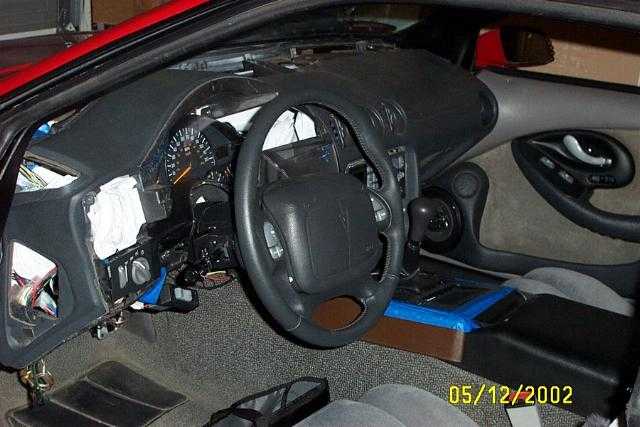

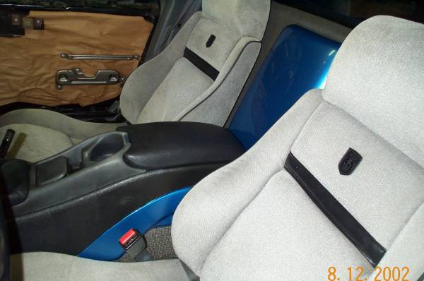

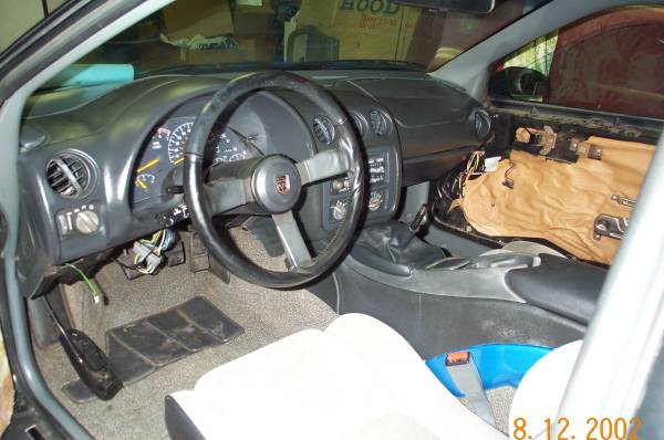

Sorry it took so long for me to respond to your request but the pictures you asked for are below. Keep in mind that these pictures were taken before the screens were installed. I now have the screens installed and will be painting the filler this weekend (I hope).
More pictures later,
Roy :D

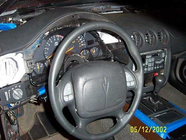

New megapixel camera shots of current state...Firebird center console still not installed, so don't hate me

Thanks for the pics. It looks great!

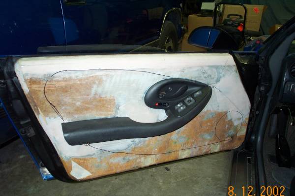

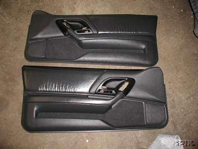

Here is a shot of the Camaro door panels. Of course they can work but, cosmetically, I like the Firebird door panels better. Of course, like the Camaro dash will work just as well as the Firebird.

Ambush - I have not taken a Camaro dash apart so I couldn't tell you if it mounts the same as a Firebird or not, but if I were a betting man I would say that it probably does. If you have a deal on a Camaro dash and you like the way it looks then I say go for it.
Smooth - I actually live in Pearland, but I can throw a rock and it lands in Houston. Are you planning on coming to the Galveston event? I'd like to bring the Trans Fiero if I can get some of the wrinkles smooothed out by then, (pun intended)
LT-5Fiero - The Camaro interior is very similar to the Firebird. I prefer the pontiac look though. The Camaro gauges will light up white and blue, (there is no red) personally I wouldn't want that in a Fiero.
Also if you get the gauges for the V8 you will have to modify the tach. I haven't a clue how to do that, I used gauges from a 3800 V6 Firebird so they worked right automatically. (Trivia note - I am using the 4000 PPM square wave output to the electrohydraulic power steering to drive the Firebird Speedometer.)
AznFiero - I say "only" 2.2 megapixels because that is plenty for posting pics to the web. My old camera was also 640 x 480 and it's like night and day the difference.
Mrfixit58 - I agree with you that cosmetically the Camaro door panels don't look as nice. Also the Firebird panels have integrated tweeters in them, Camaro does not. But it's up to the individual to decide which they prefer.

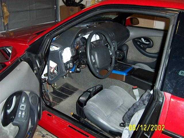

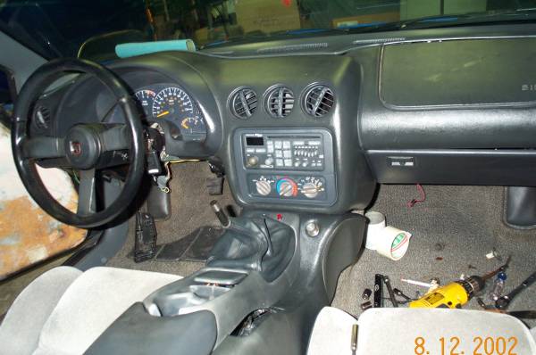

87gt guy - Roy has said that the total cost of his conversion is in the $200 - $300 dollar range. Incredibly cheap. His strategy has been to search the boneyards and get the best possible price for the Firebird Items. I have invested somewhere in the $1000 range mainly because I have used ebay and the internet for my source of parts. More convenient, but I have to pay shipping and sometimes inflated prices.
Fierokid87 - The door panels are one of the trickier areas. I chose to use Firebird panels and then trim off the front and rear portions and then adapt them to the Fiero. This also involves new door handles, window and door lock switches, and speakers. It also replaces the inner dew wipes.
What I haven't done yet is to make the ends "pretty" where I cut them off. A lot of people are concerned about that but I am confident I can make it work.
Roy decided to take a different path and use the Fiero door panel and smooth it out and attach the firebird handle and latch. Then cover it with vinyl. That sounded like more work to me, but his results should be about the same or better than mine.
The dash fits within the Fiero to within an inch or two. There is some tweaking that has to be done to make it perfect. If you don't want to cut metal it will stick out about 3 to 4 inches more than the Fiero dash, (the jscott position) if you cut the steering column support and reposition the whole thing you can get the dash farther back (the Roy position). There are pros and cons to each method, you have to decide which is better. You can look at the pictures to judge which looks better to you.
Sailordude - The panel pics were just taken 5 minutes ago. (I just noticed the clock was set wrong on my camera) I am presently working on the center console and environmental controls so I haven't a new picture to show of that yet. The panels are presently held in place by screws which will either be covered or I will choose nicer looking exposed fasteners.

Report this Post12-07-2002 11:47 PM Click Here to See the Profile for jscott1Send a Private Message to jscott1Edit/Delete MessageReply w/QuoteDirect Link to This Post
The air vents line up from side to side but the Firebird vents are about 6 inches in front of the Fiero ducts, Also the Firebird vents are round and Fiero ducts are square.
To make the transition from square to round I used flexible ducting, (you can see the white ducts in the pics)

jscott1
Posts: 21676
From: Houston, TX , USA
Feedback score:    (15)
Total ratings: 415
Report this Post12-08-2002 01:49 AM Click Here to See the Profile for jscott1Send a Private Message to jscott1Edit/Delete MessageReply w/QuoteDirect Link to This Post
Originally posted by rynelson85:
what is that *bump* noise? oh..its me!
-Ryan
Thanks for the bump...this is not a Fiero, but an example of a show quality 4th gen Firebird interior:

1986GTV8 - Roy made a custom piece out of fiberglass to fill in the space. I am planning to take the original Firebird piece and trim it to size once I figure out exactly where the dash is going to be placed.
ltlfrari - The dash doesn't really interfere with the shifter too much, but to answer your question, the support for the steering column prevents the dash from going more forward. Roy has cut the support and repositioned the support for the steering column, which allows the dash to be positioned more forward. I didn't want to cut anything so my dash is where it is.
My reshaped shifter should minimize the interference with the dash, if there is any.
- Jonathan (JScott1)

Originally posted by Texas87GT:
Looking really sweet..just bought a 2000 firebird and was wondering ..How do the air vents line up? any trimming or repostioning to the firebird air vents..
Keep up the good work.
Texas87GT,
I took a more anal approach to the A/C ducts and modified the center distribution box from the Fiero. I cut the box so it just covered the lower air box then installed 2 -2 1/2" ID PVC couplings on each end. From there I used 3" duct hose to reach the corners. The right corner attached to the back of the vent. The left hose passes through the dash and slides over the vent in the gauge cluster bezel. For the center vent, I used the Firebird center distribution duct and afixed it to the front of the modified Fiero A/C air box. The whole system is mounted inside the dash and comes off with the dash just like the Firebird and Fiero systems. To patch everything together, I used a two-part adheasive from 3M for rigid plastic.
Hope this helps,
Roy

Report this Post12-09-2002 12:31 PM Click Here to See the Profile for mrfixit58Send a Private Message to mrfixit58Edit/Delete MessageReply w/QuoteDirect Link to This Post
mrfixit58
3330 posts
Member since Jul 99
Here's a few pictures of the new dash and console. Except for a few minor punch-out items, the dash and console are FINISHED!
Comments?
This one is, of course, the door panel in progress. The outline represents where the contrast line will be. I'm thinking charcoal gray like the armrest around the outside with a light gray inthe center.
Roy :D
Blue 87 GT w/ 4th generation Firebird interior.
Suncoast Fieros

DAMN GUYS! I have finally decided my approach will mix the two together.
-Firebird dash, console and doors
-Roy's mounting style, more complicated, but more space given and the ability to use the Firebird mounts
-JScott style custom short shifter
-All working Firebird controls(HVAC?) and radio
-Firebird airbox and ducts
-Modified Firebird steering wheel with Fiero emblem
-Phirana style console back or Roy's style
Color scheme will be charcoal, light grey, and reserved usage of black.
Looking at it, I couldnt smoothly do what I would want to do, I would need like 3-4 more inches of space between the back of the console and the firewall.
