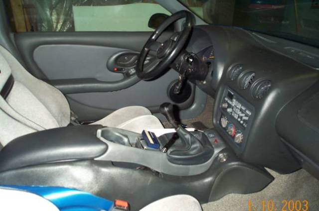

I'm getting real close to having everything bolted down in the final locations. Just a few more custom brackets and I will be on the road again.

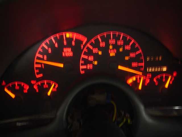

All of the gauges in the Firebird cluster work off of the stock Fiero analog senders, with the exception of the gas gauge. It is looking for a digital signal from the powertrain control module, which the Fiero obviously does not have.
The solution Roy did was to replace the gas gauge with an older analog version. I hope that helps.

Our 94-95 cluster with non digital odometer seems to work the fuel gauge the same as fiero.

I'm not surprised the older gas gauge works fine. My service manual states that it's a analog gauge in one section and digital in the other. So I fgured it changed somewhere along the way.
But I have the digital odometer and the more modern gauge overlay so I still like the one I have better.

what about the tach, can you adapt a v8 tach to a v6 is it hard to do, and wich one has a higher red line? are the speedos the same top speed or do they differ? I do realy like what I see and look forward to doing one of my own, do you have pics of the finnished car or is it not done yet?

This is a pic of a V6 firebird cluster with kms and no digital odometer.

PBJ's picture of course shows a metric speedo. Mine is from a 3800 V6 and therefore did not need to be converted. I have no idea how to convert a Firebird speedo or tach.
My speedo maxes out at 120 MPH and the tach redlines at 6,000. The actual redline for the engine is stored in the ECM so it doesn't matter what's printed on the tach.

That's interesting. Mine had to be replaced with an older gauge to work correctly. One thing I didn't try was to remove the resistor that was on one of the traces. Perhaps that would have removed the factory bias and allowed the gauge to regester properly. Not really a big deal. I already had the replacement gauge and it only took about an hour to install it.
PBJ -- Does yours register "full" when energized? That's waht mine did. I only had 1/2 tank of gas so I know it was wrong.
Roy
No it reads 3/4 of a tank, thats what the fiero one read too and is the amount of gas I have in there.

Well, maybe the 1/2" of water that the cluster was sitting in when I found it had something to do with my in-op gas gauge. I know it works now, I ran most of it out yesterday on a round trip to Mr. Mike's.

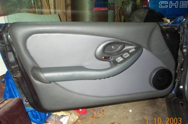

Here's a couple of pictures of my finished door panels. What do ya think?
Roy

wow... I like it.
now it needs matching grey Mr. Mikes seats!

Congrats, Roy. And I tip my hat too you
Thats AWSOME............

Totally awesome ...
Add the Firebird steering wheel and it would be identical to a Firebird.

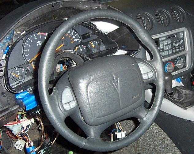

is the steering wheel in the all the way up position?can u drive it in that position and see all the gauges and the road,or are you going to move it down some?

For those that don't want to cut and weld, here is the final dash placement that I ended up with. Compare the gap over the steering wheel with the one earlier on the page. You can see how I squeezed the dash closer to the column. Also note that the cupholder is deployed!
I am still waiting to get my replacement gas gauge so the cluster bezel is not installed. The people I bought the gauge from have been stringing me along for almost a month now. I should have just gone to the junkyard
Roy

Hey guys,
Thanks again for the kind words.
DaRKLoRD -- Mr Mike has my check.
the need for speed -- It's a tilt column and in the picture it's in the full "up" position. When it's in the driving position, I have an unobstructed view of every gauge.
Smoooooth -- Like you've never had an original idea . We're bound to see a LOT of Smooooth-isms on other peoples' cars.
seadog -- Well, come one over!
BV Motorsports -- Maybe we can make a deal... I mount the dash in your car and a 3800SC motor in mine and you can wire both!
To everyone, Thanks.
Roy
