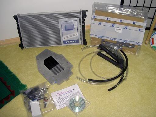

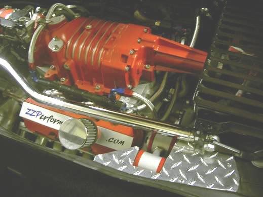

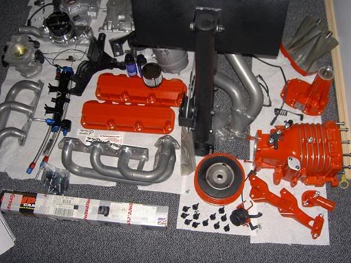

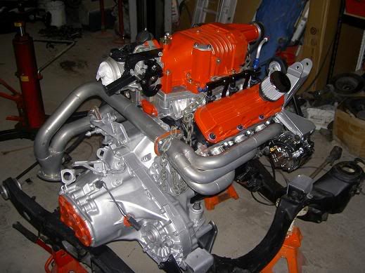

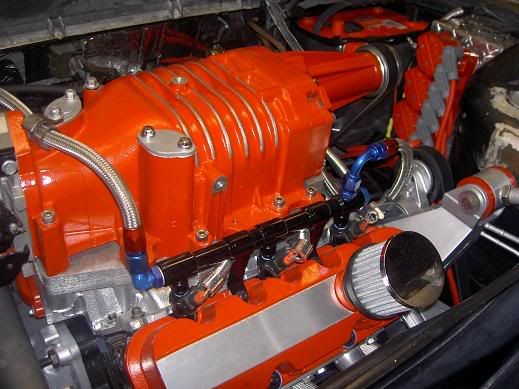

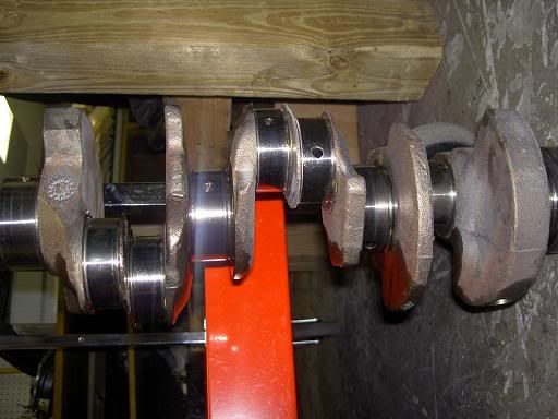

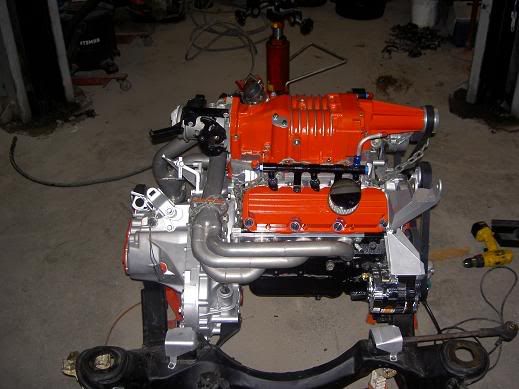

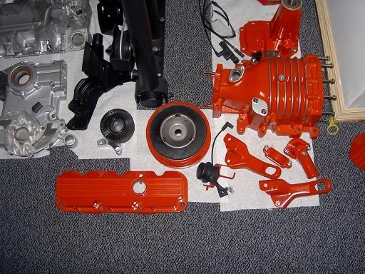

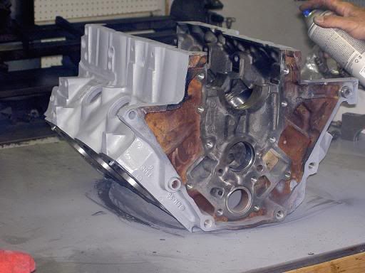

Phase 1:
The engine recieved its bath and the block was resurfaced. The beautification process began, hehe:
Forged pistons:
Crank!!
Machined intake:
Parts:
ZZP SS intercooler:
Electric waterpump:

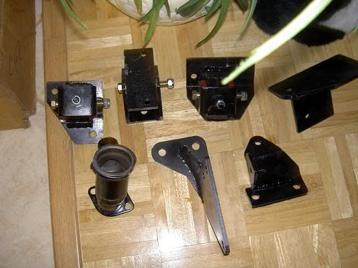

Purple Reign Poly mounts and filler tube, and low mount alt. bracket: (we used smaller pulley)

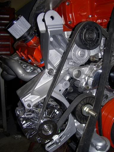

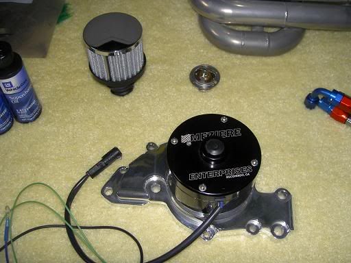

I know that electric waterpumps are common on SBC installs, but I don't recall seeing them used on a 3800 before. Is that a block-mounted unit or a remote one?
FieroGTRwideboby
Posts: 591
From: Socal (Pasadena)
Registered: Jun 2004
Report this Post04-20-2006 03:58 PM Click Here to See the Profile for FieroGTRwidebobyClick Here to visit FieroGTRwideboby's HomePageSend a Private Message to FieroGTRwidebobyEdit/Delete MessageReply w/QuoteDirect Link to This Post
What do you mean by block-mounted unit or a remote one. I mean It mounts directly to the stock location on the block, and with their harness ($15) all you do is plug it in. What I did was sent it to Loyde, so when he did the harness he incorporated it into it, now when the ignition is turned on the waterpump turns on, a type of insurance that it's running.
Alex

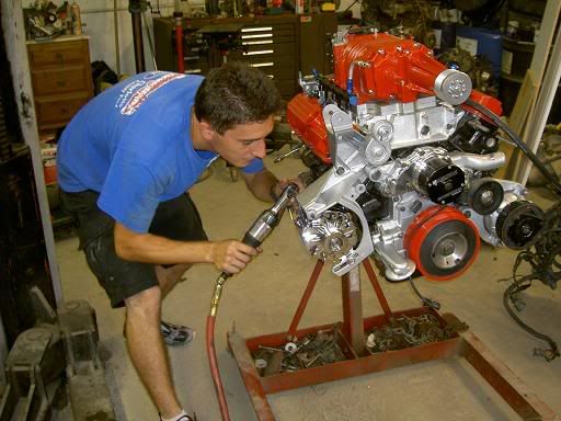

FieroGTRwideboby
591 posts
Member since Jun 2004

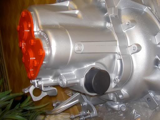

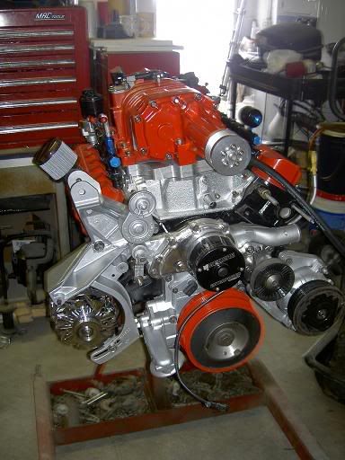

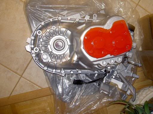

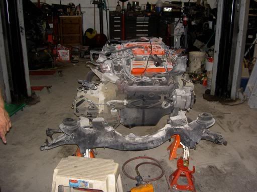

Now for the assembly and tranny:

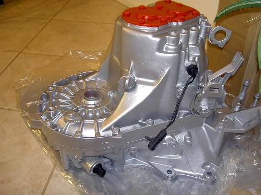

Out with the old, it had approximatly 112000, it ran like a champ, but just did not match the looks of the new more modern fiero.
The tranny after new parts and paint:
Machined intake on block:
Finally started assembly on the motor:

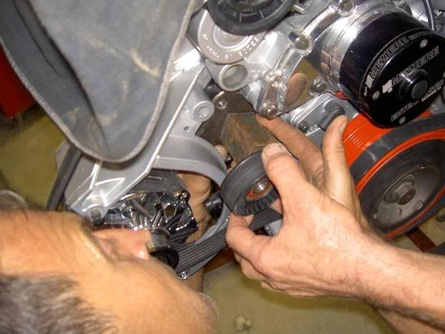

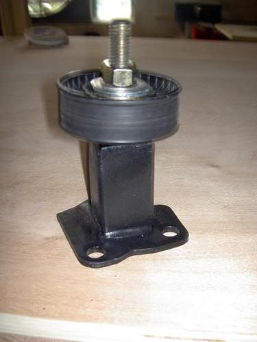

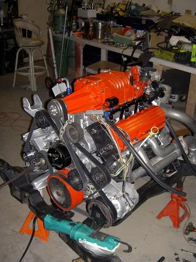

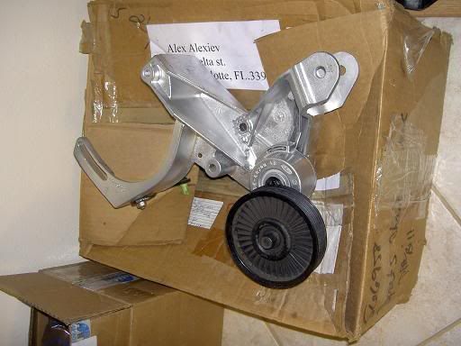

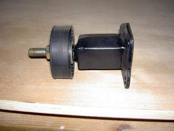

Since the electric water pump was istalled inorder to keep more tension on the belt, we had to make a idler pulley mount to stretch that belt between the alternator:
Shots of build up of idler...
After it was installed...
Alex
Alex - yes, that answers my question. On some SBC installs, people will use a remotely-mounted water pump (from what I've seen, the pump itself is generally located where the stock battery used to reside)... they then just plump coolant fittings/lines directly to the engine. It's a good space-saver for a tight install, but pretty spendy when compared to a normal electric pump.
I guess I just didn't even really think about the fact that they probably made them for 3800's too, as I don't recall seeing one before!

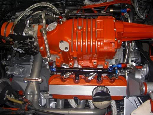

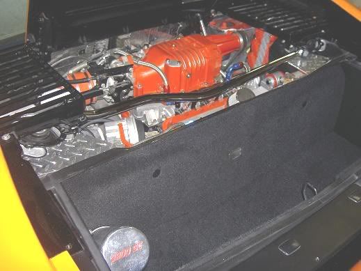

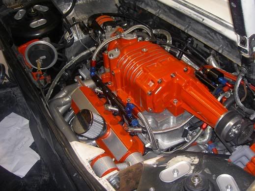

Here everything is ready to go back into the engine bay. I was amazed with the quality of Loyde's work, just flawless. WCF ceramic coated headers.
I have to give recognition to Fie Ro for the cool idea on the carbon fiber valve cover caps, but i made mine from alluminum.

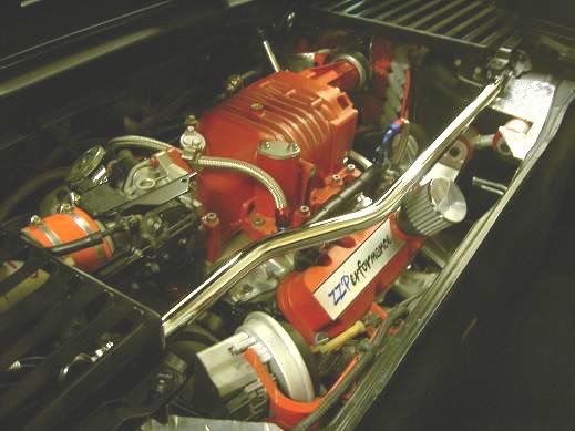

Here is everything in and ready for the first start up.
And after the final touches to finish it off:
The overflow tank was hidden in the left side of the truck behind the enclosures. the tank in the
back is the Heartlandfieros.com vacume cannister with the engraved 3800 SC. A Fiero Store strut bar was also installed.

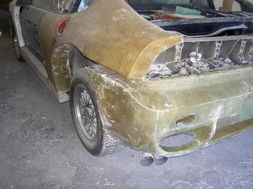

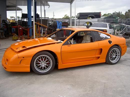

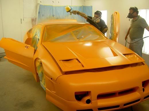

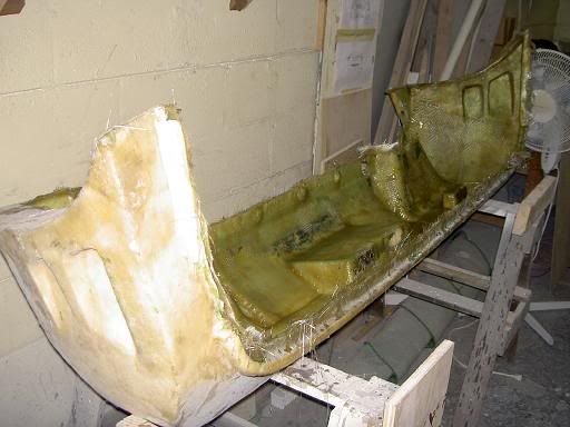

Alex, run this by me again... You made the plug on the car (wood, plaster, etc.) then made your fiberglass molds from that... cleaned off the car, made the parts and thats close to all she wrote for the body...? did you have anything between the panels and the wood / plaster ?
And if you did this again, what would you do diffrent if anything ? (as far as the plug, mold, etc is concerned)
~Tim Bonner
" Life is short, Live alittle and If you feel froggy, jump. "
FieroGTRwideboby
Posts: 591
Report this Post04-22-2006 08:05 PM Click Here to See the Profile for FieroGTRwidebobyClick Here to visit FieroGTRwideboby's HomePageSend a Private Message to FieroGTRwidebobyEdit/Delete MessageReply w/QuoteDirect Link to This Post

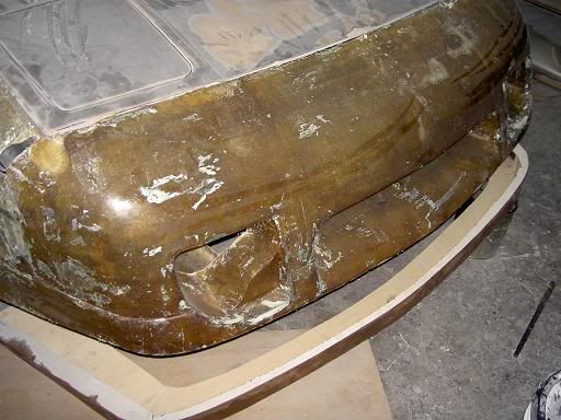

88GTFormula

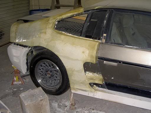

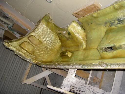

Let me get into more detail, sorry, I just speed through some things sometimes. Okay like you said, made a plug, from which we made the molds for the car. Once the molds were made the wood, plaster, styrofoam, old front fenders, ft bumper, rear bumper, and other original panels were removed so the new ones could be attached to factory stock locations.
In this picture you can see when we began to lay the fibeglass on the plugs to make the molds of the rear quarters:
once the mold was made the plug materials were taken off and the mold was cleaned out and polished.
Here is the part out of the mold not yet cleaned out of release (etc):
All the body panles are direct replacements for the originals, there is nothing under them from the plug, they are like the stock parts (not really hehe..) but fiberglass.

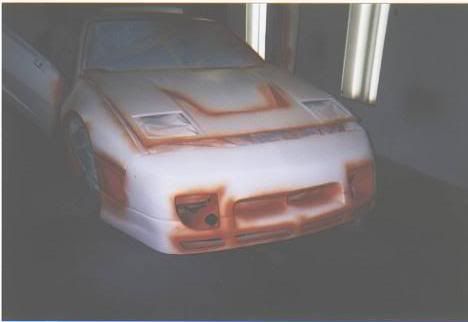

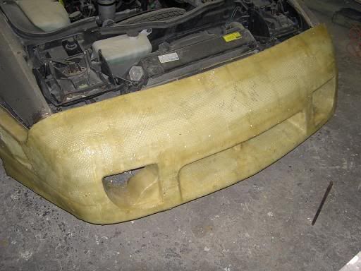

Front bumper mold:
and part pulled from mold, but not sanded or cleaned yet:
The rear was made the same way. The rear bumper is a "direct replacement" with nothing used from the original bumper...mold with fiberglass layed to make actual rear bumper:
Hope that helps explain the process, if not ask again,

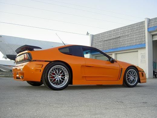

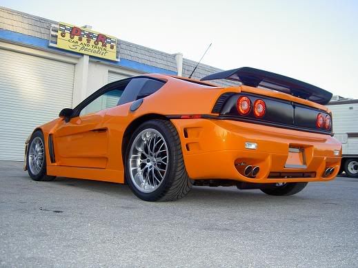

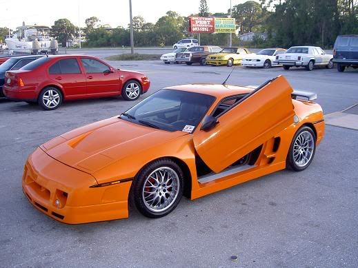

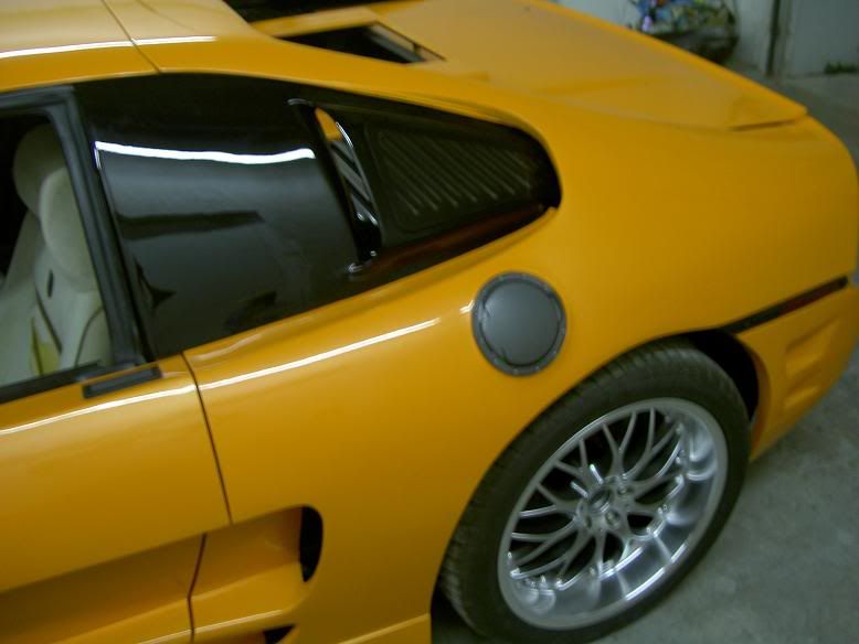

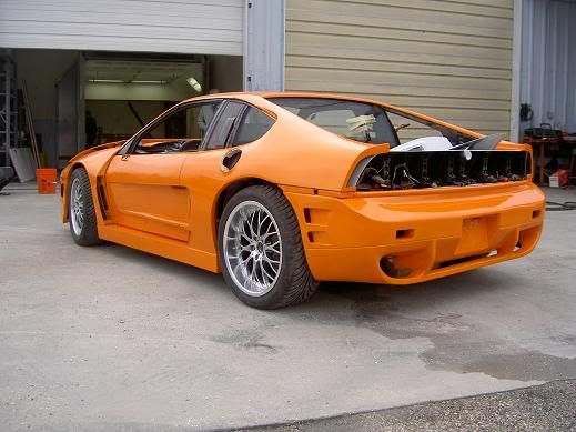

Report this Post04-29-2006 11:39 PM Click Here to See the Profile for FieroGTRwidebobyClick Here to visit FieroGTRwideboby's HomePageSend a Private Message to FieroGTRwidebobyEdit/Delete MessageReply w/QuoteDirect Link to This Post

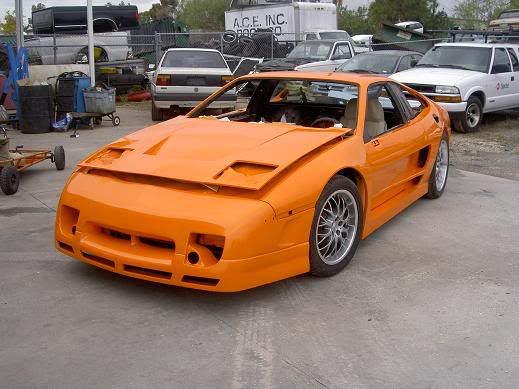

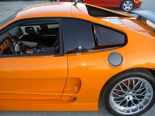

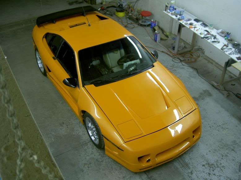

Took some better pictures when we took her out recently.
Tusch
Posts: 222
From: Dayton, OH
Registered: Mar 2006
Report this Post04-30-2006 12:13 AM Click Here to See the Profile for TuschSend a Private Message to TuschEdit/Delete MessageReply w/QuoteDirect Link to This Post
This thing amazes me more everytime I see it!

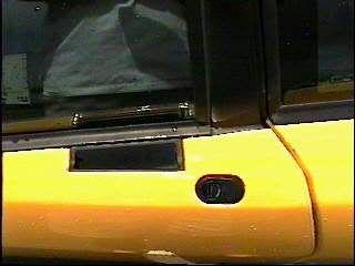

Yes, that was originally an archie dash, if you go to page 3 you can see how we modified it, and changed angles, ends etc.
Alex

I'm just the other way around, I'm not a big fan of body color painted rims. I think black and black with polished lip looks good on some cars but not all.
Can't wait to see some photochops, I say either leave them as they are, chrome, or black center polished lip.
Fie Ro
Posts: 3735
From: Soest, The Netherlands
Total ratings: 132
Report this Post04-30-2006 02:20 PM Click Here to See the Profile for Fie RoSend a Private Message to Fie RoEdit/Delete MessageReply w/QuoteDirect Link to This Post
a try on the wheels:
usually I am not a fan of colored wheels but these may look pretty good and matching with your widebody-cutouts !!
...painted pieces of the rim do make it look smaller and bulkier though....you'll want the painted part outwards as much as possible when theyre supposed to look big....anyway did I allready mention your Fiero looks great?

I vote for black with the chrome lip.

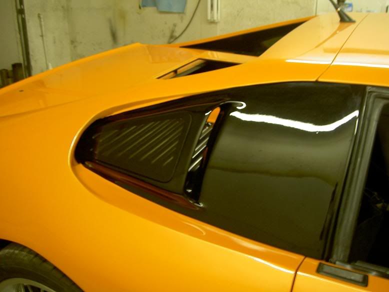

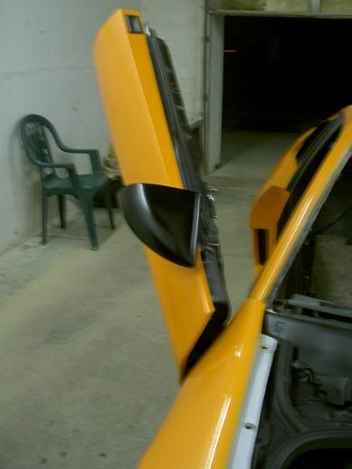

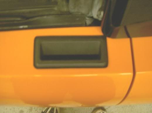

Hey Alex....do you have any more pics of the area near the sail panels? Nice detail in this area that some may have over looked. Thanks.
edit: I can't spell, hehe.
[This message has been edited by madcurl (edited 04-30-2006).]
FieroGTRwideboby
Posts: 591
Report this Post04-30-2006 04:39 PM Click Here to See the Profile for FieroGTRwidebobyClick Here to visit FieroGTRwideboby's HomePageSend a Private Message to FieroGTRwidebobyEdit/Delete MessageReply w/QuoteDirect Link to This Post
Madcurl,
I see you are very observant, many people probably missed that part. Well since we added the widebody door panels, with the lambo doors, it was awkward guiding it up since there was no handle. If you look at the picture of the car, the most recent ones, you can see how the original door handle is located under the new door, and on the top we added a grab to give the person somewhere to grab and guide the door up. Some saw it at daytona. Lamborghini did this on the Diablo, so i figured if they did it it must be usefull and a good idea.
Here is a Lamborghini door grab, and ours below.
Here's our version of it. hehe:

I'd powder coat the wheels.

Alex was this a panels off paint job ?
Do you have any pictures or plan to show any pictures of the car during the painting process ?

Where did you get the sail panels? from or did you make them?

IMO I'd go with your first pic...the chrome lip and black center. That look will no doubt be around for a very long time and will quiet the car down some allowing viewers to take it all in and makes your Fiero look "serious and agressive."
The second pic are "over-done." First off, the rim spokes are too big for the car and the painted orange lip are too phat. I've seen better ones on a Lamborghini Murcieo'logo with the same color but her outer lip or edge was painted and not the entire 3-piece. The only good thing about the second ones is: "If your rims are stolen, you'll find them in no time."

Madcurl,
How about if the wheels I have are in that color scheme. Black multispoke Evos
with Pearl orange lip. I actually wanted my rims to be colored.
Anyway I still can't decide, I like both.
I'll post some pics of the paintting process Exoticse.

Report this Post04-30-2006 09:42 PM Click Here to See the Profile for FieroGTRwidebobyClick Here to visit FieroGTRwideboby's HomePageSend a Private Message to FieroGTRwidebobyEdit/Delete MessageReply w/QuoteDirect Link to This Post

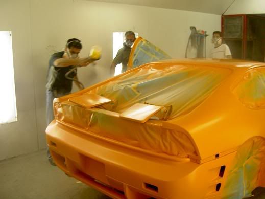

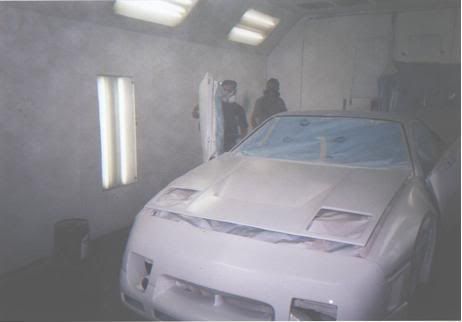

Sorry I will interept the wheel input for 1 sec for the paint process which Exoticse requested.
The unique charcteristics of a pearl paint job is where the "panel-off" paint job gets complicated, The painter Fransisco Vilalba of Ultimate Motors in Longwood, Florida, requested that most of the body be together, not bolted down, but parts nect to parts. The reasoning behind that is when spraying the pearl you don't want to have a variation between the pearl amount, for example between the hood, fenders and ft bumper. The panles that were on the car during the paint were ft and rr bumpers, doors, and rockers. The hood was in the front where it should be but lifted liek it was floating 2 inches above the fender level. The headlight doors were separate, the truncklid and sails, spoiler were also separate. The body panels were placed on the chasis but not bolted down during paint.
After the car was primered twice and wetsanded Phase 1 was done:
Phase 2
Once taped off the car got 2 coats of the special sealer that gives the car a single color starting point and also covers up inperfections, if present:
Phase 3
Cuts were made to ensure paint gets everywhere jams, lips, under doors, etc:
Phase 4
The car gets the color finally. Fransisco sprayed 3 coats color everywhere:
Phase 5
The 2 coats pearl sprayed:
Phase 6
The car received 3 coats of clear to top it off and guarantee a deep shine. The mornig after being baked during the night.
Hope that gives you an idea of the process and time involved. I beleive it we started aroung 4pm masking off, then by 6pm we had it all masked and ready for sealer. By 8pm sealer was done and cuts ins were applied, 10pm color was sprayed 3 times, 12am pearl was almost done, 2 everything was sprayed (clear) and done, the paint job baked overnight.
The sail panels are from MsLoriFiero aka Lori A Casto, they have stuff in the mall for sale often, great panles and are actually curved like the stock windows.
Thanks and now back to our regular broadcast programing: wheels???
Thanks
Alex
