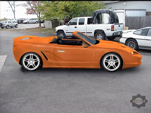

Well guys, We've got quite a bit done on the PFF Spyder this week.
We set a front clip, hood, door panels & the rocker panels on the car to see what it is going to look like.
I have several pictures of I have several pictures of it I'm going to post up tonight, but before I do that I want everyone to know that the car is not done yet. I know it needs to be lowered, I know it needs a wheel alignment, I know the header at the top of the windshield is not done yet.
Regarding the wing, we are trying to decide between the low wing as seen in the pics & the High wing & NO Wing at all. So your input is requested.
I wonder if any of the Photoshop guys can make it all one color for us.
We are very pleased with how it looks, Check it out.........

I do like the low wing. I would think that the higher wing on this car would look to.......'importish', but I'd like to see a photoshop of the wing on the car. I've seen some wings on convetibles that make the car look like a grocery cart and I'd like to see that avoided.
Color? Hmmm....I've got some ideas......
Looks beautiful!

Tomorrow I can work on it in Photoshop. What high wing are we talking about here?
Like what is on the Blue Fino:
Personally I like the look of the low wing. It looks more like Aus's pic from a side view. I would think the high wing would look too odd sticking way up in the air with the low profile of the decklid.

Low wing.
And its lookin great. Its Mcdonalds - I'm lovin' it!
Either leave the wing low or ditch it. Roadsters need to look low and mean.
--Will
Best I can do so quickly.

I like the no wing as in the first RED photo that was used as a concept car..... that looks great! Low and mean!

Definitely not the high wing.
The low wing looks good, but I think it might look pretty good with no wing, too. Can't really picture it in my head, though.

thought it was going to take a lot more work around the rear fenders where the wing roots in . . .
then i saw the pic with the wing on it. very NICE.
definitely the wing shown

Report this Post10-16-2004 11:24 PM Click Here to See the Profile for doublec4Send a Private Message to doublec4Edit/Delete MessageReply w/QuoteDirect Link to This Post
Here's what I've done....
pylon orange anybody hahaha

Report this Post10-16-2004 11:47 PM Click Here to See the Profile for LZeitgeistSend a Private Message to LZeitgeistEdit/Delete MessageReply w/QuoteDirect Link to This Post
Yeah, 'no wing' looks pretty strange...
What about adding somewhat of a 'ducktail' on the rear edge of the low wing? Nothing huge, just sort of an upward bend?
