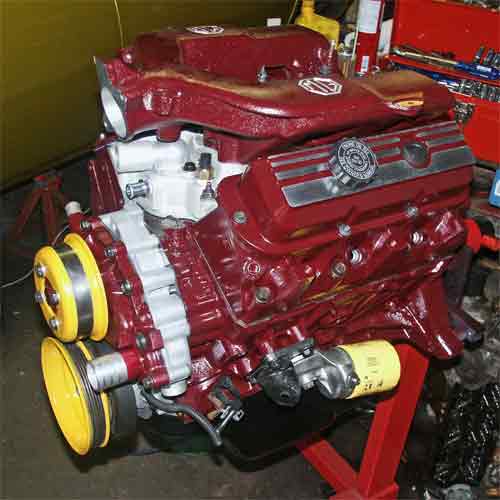

When I stuffed a 3.4 into a 1956 MG, I useed the Fiero valve covers - they look a heck of a lot better than the stamped steel used on the 3.4 engines. You just need the right bolts and you need to grind a tad off the underside of the upper plenum.

After a long time again worked on the 87 t-top
the car is almost ready and I can not wait for the engine to start
only ordered a few parts to get ready
Fiero GT 1988 2.8V6
Fiero GT 1987 3.4V6 T-top
Buick roadmaster 1956 5.3V8
my_fiero@hotmail.com
[This message has been edited by my-fiero (edited 10-08-2013).]
