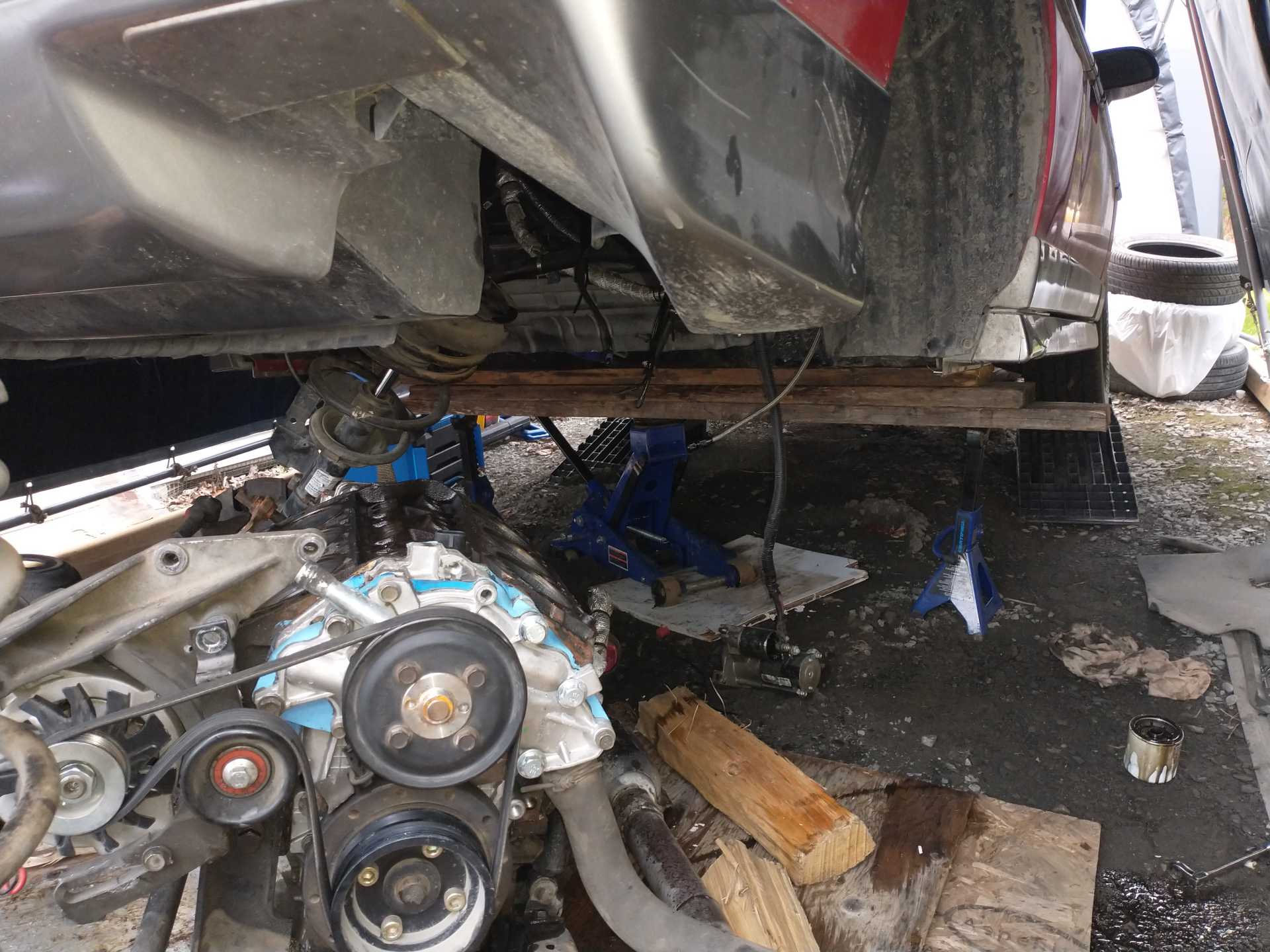

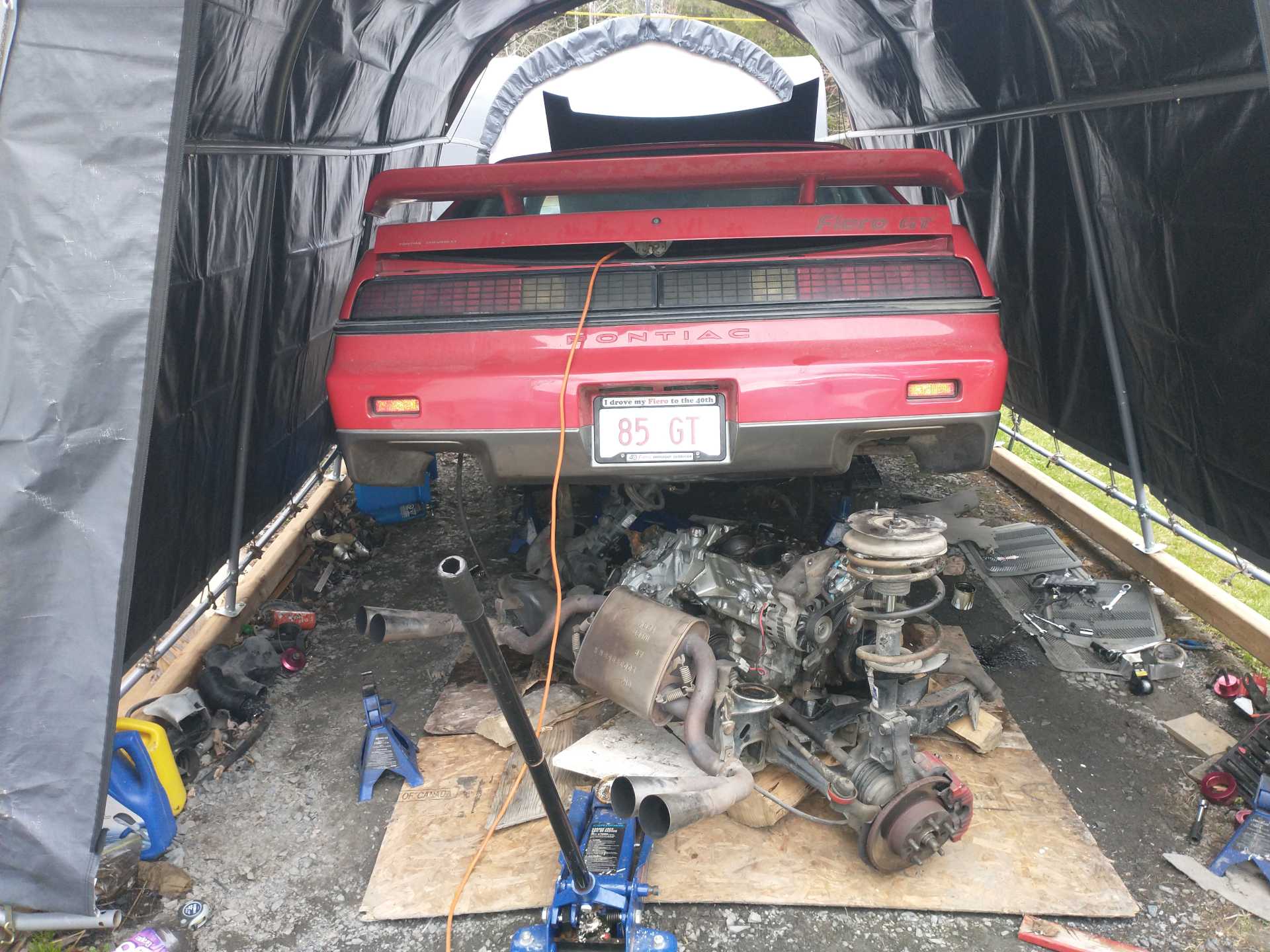

Well, bad news, although I don't understand it, some Jehovah's witnesses seemed to have leaked into my oil pan, yep, I have a knock. What I don't understand is why, I had one very brief lean spike during normal operation (I had the afr safety on full blast), and I've had no knocking/detonation/pinging, the engines run smooth as a top. I used a mechanics stethoscope, and the noise is louder when touching the oil pan than the heads, so I guess that would rule out a lifter/rocker etc. (and it was still firing on all 6). I replaced all the main and rod bearings measured clearances, they were on the high end of within spec, but they were within spec, I've never lost oil pressure, even now, although it is reading a little lower than my old 2.8 (I changed oil pressure senders, and the 2.8 was basically pegged to full almost the whole time, so I didn't think to much about that, this was 35psi ish at idle (above the red), 55 at 3000+, estimate based on the gauge).
Rock auto has a remanned crankshaft and bearing set for 200 CAD, so I'm going to drop the cradle, take the oil pan off, see what's up, and hopefully it'll just be the crank and bearings, and the rods and block are fine.
What did I do wrong, was it just the slightly bigger tolerances, 5w30 oil (I know pmBrunelle runs thicker oil, maybe there's a reason for that), and as for tuning I don't see how anything could have gone wrong, things have been running super smooth and the afrs have been rich, and if that one tiny slight lean spike I got this morning was enough to attract the Jehovah's witnesses, then that's rather disconcerting.
pmbrunelle
Posts: 4661
From: Grand-Mère, Québec
Registered: Sep 2008
Total ratings: 63
Report this Post05-05-2025 10:28 PM Click Here to See the Profile for pmbrunelleSend a Private Message to pmbrunelleEdit/Delete MessageReply w/QuoteDirect Link to This Post
It doesn't sound like you were pushing the engine hard, seeing as you just started running/driving the car. Also, you didn't report hearing any knock, so I would be surprised about a tuning-related problem. After changing to the distributor trigger and changing settings there, I suppose you verified the ignition timing with a timing lamp?
Maybe there was some dirt/contamination in the oil which made its way into a bearing, ruining it.
This could have been a metal chip left over from inside a cheap turbo, dirt inside the oil hoses (I washed mine with water and then let them dry before use), maybe rocker arm balls that wore. Perhaps just dirt from the shop.
With thicker oil, the bearings have greater load capacity. Racers won't do this because the added drag from thicker oil costs power. Automakers won't do this because the added drag reduces fuel economy.
[This message has been edited by pmbrunelle (edited 05-05-2025).]

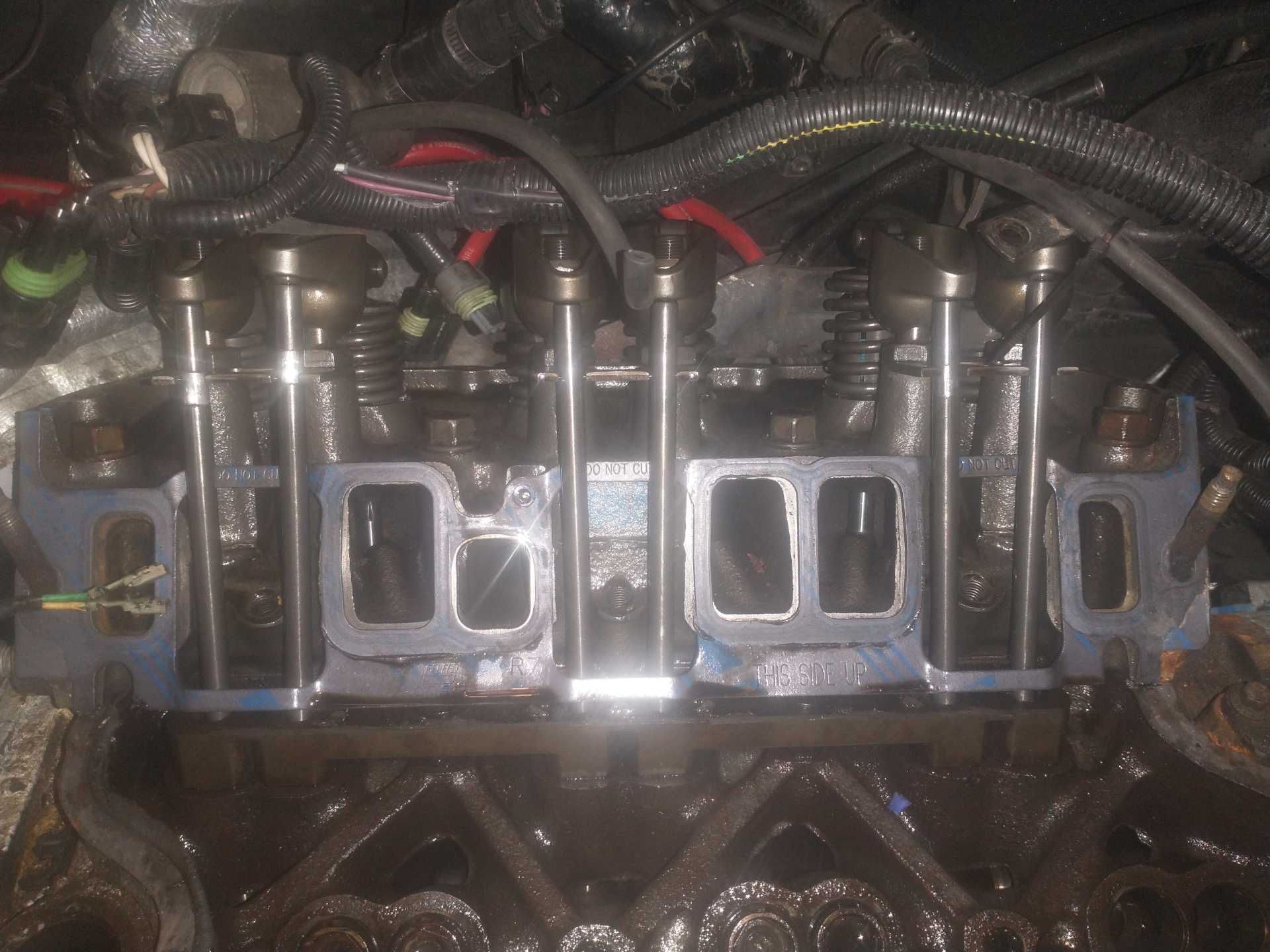

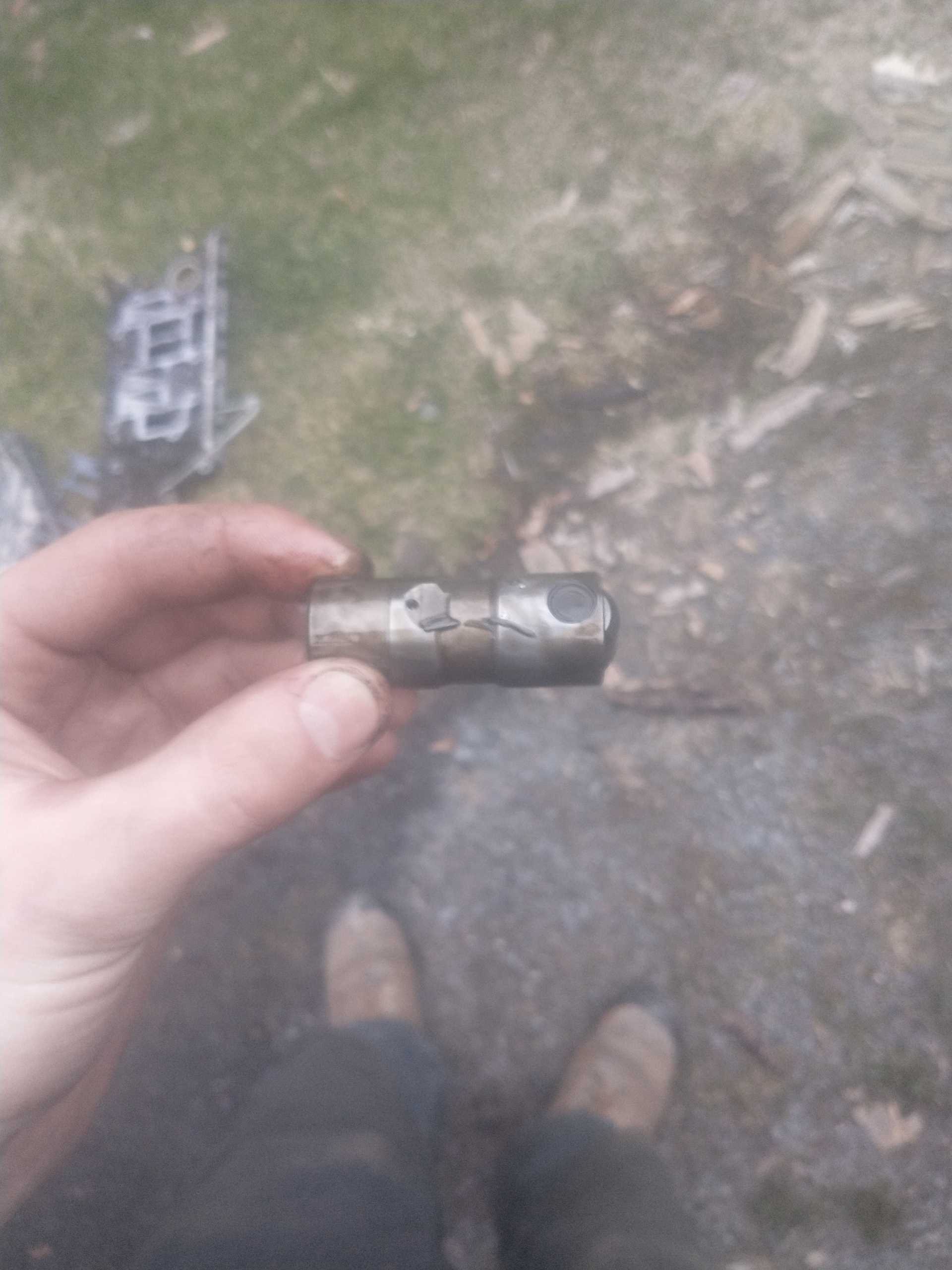

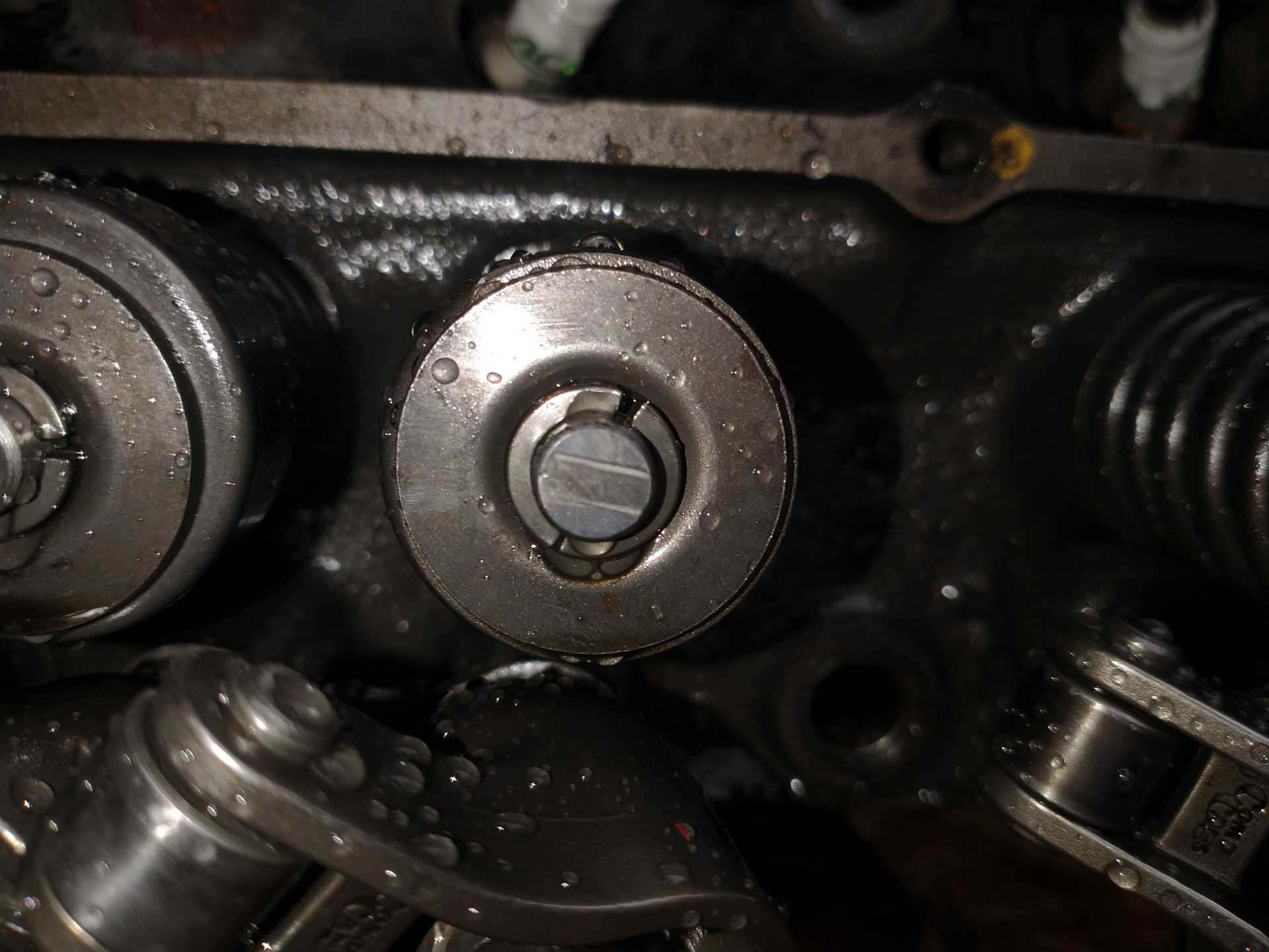

well I took the top end apart this evening, found several things, all related, any one might have caused the rest.
So first thing I found was a collapsed lifter, it was collapsed several mm, and the pushrod was loose. All my rockers look perfect, they're not an issue. Second thing I found was several pushrods were severely worn where the guide is (this one the worst)
I removed all the lifters, and found some of them had metal in the oil groove, the amount of metal seemed to correspond with the pushrod wear, although it doesn't appear to be the same metal, (this is the worst one, the same cylinder as the pushrod above)
Long shards of metal, and there were little pieces in the oil hole. All the lifters came out of there bores smoothly and without play (even the ones with the metal in that groove), although some/all of the lifters had some side to side play on the part the pushrod sits on, the little piston thing.
I haven't done anything underneath yet, but I did crank it over with no lifters/pushrods, and it does still sound like it's rattling, especially at the end of the second crank:
So that tells me the bottom end is also very very unhappy.
So, any ideas what went wrong? Was it a lower end bearing that went, metal got everywhere, took out at least one lifter with it, and caused a looseness in the pushrod seat of the others bad enough to wear the pushrods on the guide?
Or was it lifters, which wore the pushrods, which took out the bottom end?
Or was it pushrods wore, which caused that metal to take out the lifters and bottom end?
So at the moment I know I need lifters, the pushrods are probably fine, I'll clean up any sharp edges with some sandpaper and maybe open up the guide slots a little bit. With the amount of metal everywhere, and the rattle when cranking, it's probably safe to say the bottom end is dead, so probably the crank and all the lower bearings need to be replaced. I also saw some pitting on the camshaft, not consistent with any of the other damage (probably from when it was sitting?), so theoretically that should be replaced to, I guess the cam bearings wouldn't have liked this metallic adventure either.
So with all that, I don't know, it might be beneficial to find another engine entirely, but who's to say that will be useable either, so I guess I could:
Repair this engine as best as possible,
Get second engine that may also have issues,
Find something remanufactured, I found a remanned 3500 for $1250us, it would just have to be freight delivered somewhere in the States, so that might be tricky.

The 3400 uses fairly standard rocker arms, with their pivots bolted solidly to the cylinder head. A pushrod with spherical ends fits between the lifter and the rocker arm (which each have spherical sockets).
The Chevrolet small-block V8 engine, and the Chevrolet 2.8 V6 use a special design, where the rocker arm pivot is spherical. Alone, a spherical pivot would allow the rocker arm to flop around. To make this design work, guideplates are used to stabilize the pushrods; it is the pushrods which keep the rocker arms aligned.
There is friction/rubbing between the pushrod and the guideplate. On an engine that uses guideplates, the pushrods need a special hardening to prevent wear; not all pushrods have this.
Could you have made a mistake with pushrod selection?
1985 Fiero GT
Posts: 1207
From: New Brunswick, Canada
Registered: May 2023
Report this Post05-06-2025 10:42 PM Click Here to See the Profile for 1985 Fiero GTSend a Private Message to 1985 Fiero GTEdit/Delete MessageReply w/QuoteDirect Link to This Post
I see, yes, I only paid attention to the length, these are from a 3900, same rocker design as the 3400, no guides, so clearly they weren't hardened, and I have no wear on the current guides, just to some of the pushrods.
...sounds like this is what happened.
Probably you could repair your engine, but you would have to strip it down to the bare block (remove all bearings) and then clean all the metal from the oil galleries. Depending on the damage, it might be easier/cheaper to get another engine.
When assembling an engine, there are a number of details that need to be right, so take your time and check everything!
Yeah, I understand, and I thought I did haha, I looked on rock auto, and the pushrods I got have the exact same description, same look, color, advertised material, etc. to the same brands pushrods for the 2.8, no advertisement for "hardening", so yeah, not even something I knew to look out for, or something that was advertised. I think the "easiest", "cheapest", and most "safe" option will be to get another junkyard engine, but also get a remanufactured to spec crank and bearings, obviously find better pushrods. What sounds best to do?

Well, got the cradle out, which was a challenge for sure, but it's surprising easy to manipulate, this time I've jacked it up by the center of the car with some wood, and because I'm on gravel, I laid wood under the jack, and under the cradle, I also have several logs under the cradle acting as both support to keep it off the ground and high enough to get the jack under, and allowing it to "roll" around. Definitely much less optimal than the last time I did this, on a level garage floor indoors, but it's working. I have 2 Jack stands under the wood spring the car as well, and this and the jack are sharing the load at the moment, the jack is solid in and on the ground, Jack stands less solid, but more than good enough. Is it sketchy? yes, will it work? Probably haha. I only need the engine out another foot or so to get it off the cradle, I've left it like that so I can close the car tent and everything won't get rained on, another evening or 2 will have the engine out/off the cradle, then it's a matter of waiting for the next engine and whatever I order for it.
So for a few years of use with another 170k km junkyard engine, I don't need to replace pistons or rings, as long as there are no obvious issues with the new engine, but I should get new main and rod bearings (and measure the clearance). I don't need to get new lifters right? Cam bearings will be fine, even if they are slightly leaky and higher tolerance, this engine is priority mains oiling, so that shouldn't matter, crank and rods I'll assume good, oil pump I can reuse from the dead engine (clean out, it was a high volume pump), I'll order a new timing set, from the older 3400 engine (like double the thickness of the new one that got put on the dead engine), new head gaskets (this time I'll get the felpro permatorque plus or whatever, it's apparently a MLS head gasket, my dead engine just got the normal head gaskets), new pushrods, I should probably get new head bolts (these have been used 3 times now, pmBrunelle, what head bolts did you use?), and new gaskets for everything

They have over 5000kms on them with no color change or evident wear, 5000 on the 2.8, 100 on the 3.4.
Best picture I have at the moment.
Your rocker issues weren't just with the roller tipped ones, you also had issues with the regular ones, and your valve springs were indenting your heads, so I think coil bind was the issue with the rocker arms wearing and breaking.
