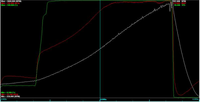

Success! I tightened it by 3 turns, and that did 3 things. It made it hit 175kpa much sooner, 2997rpm instead of 3200, it mostly got rid of the fluctuations (now it fluctuates max peak to dip across the whole run 7kpa, which is much better than 23!), and it actually increased the wastegate value to 195 ish kpa. I wasn't necessarily looking to do that for a while, but it ran good once I raised the safety to 200 kpa, still very rich, still no ping, and now it pulls right up to 5000+, instead of dipping off with the fluctuations.

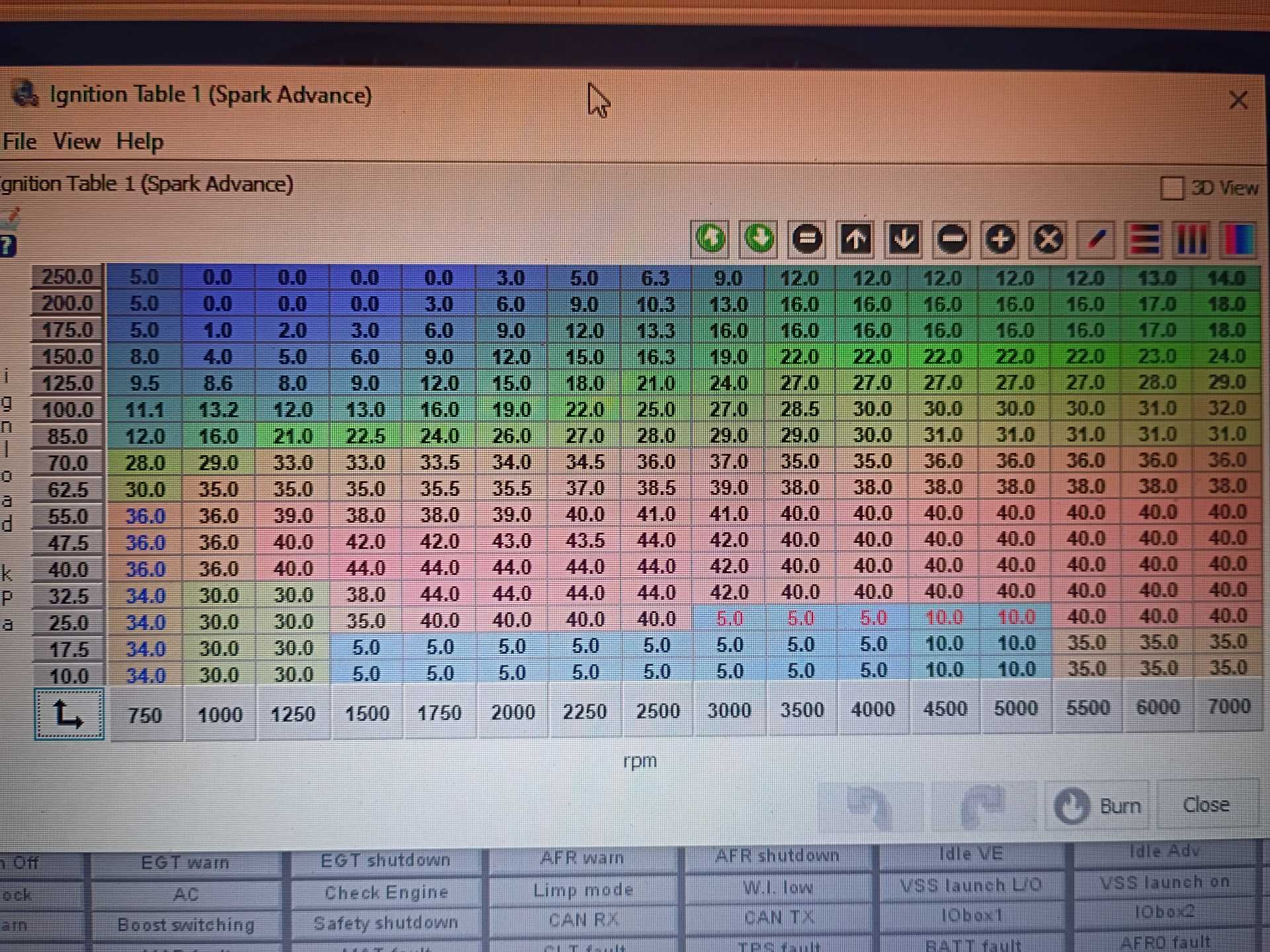

More driving today, now at 3/4 tank 93 octane, 1/4 tank 90 octane, still had the ping, and this evening I actually hit boost cut again (was pretty cold and rainy out, so that confirmed that temperature effects boost, somehow haha).

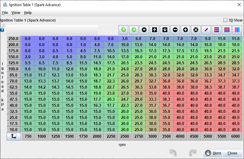

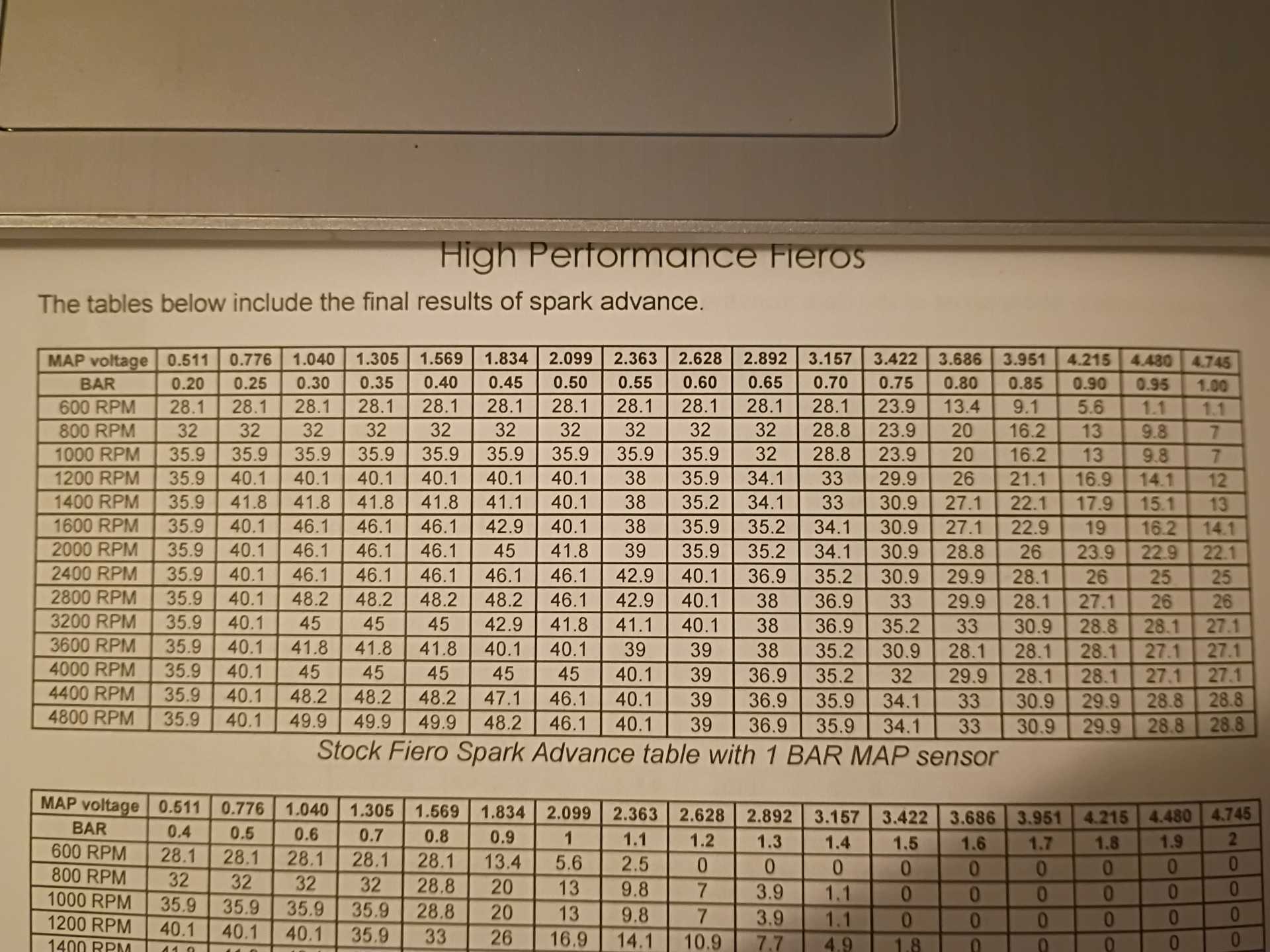

I was looking at the spark timing I was using (from an older tune from the White Bug), and looking at the spark timing other people have used (some other msqs from the megasquirt forum, and the tables from the book "high performance Fieros"), and I see that under boost (specifically 200 kpa), the timing was between 10 and 18 degrees more advanced (in the book, they use a 3.4l, iron head, and the timing is 0 across all rpms @ 200 kpa, whereas I had up to 18*, others on the megasquirt forum (Ericjon262 was one I saw I think) were in the 8* range, in my initial setup I had lowered the timing 4 degrees from what it was (so up to 14* at 200 kpa, seemingly without effect), so now I've put in the table from the book (above 100 kpa, no point messing with the vacuum timing that I know works fine), tomorrow I'll see if that finally gets rid of my pinging, if so I'll wait for a good hot day to increase it incrementally until I get the ping back, then know what the limit is. Afr is at 10-11 across the rpms at 200 kpa, so I know I'm not going lean.

It is knock, and not the “spark blowout”? “Spark blowout” is a misnomer as it designates the failure to initiate a spark when the cylinder pressure is too high. Reducing the spark plug gap is one way to facilitate spark formation.
Removing and inspecting the spark plugs may give you some hints about how the engine is running.
Is your intercooler working with water/antifreeze circulating?
Excessive ignition timing retard is not necessarily "safe", because the exhaust gas does not fully expand (and hence cool) inside the cylinder. So the exhaust valves and exhaust manifolds are subjected to high exhaust gas temperature.
You may need to reduce the boost pressure if you have a knock problem that you cannot otherwise solve.

I don't think it is spark blow out because I've had the same symptoms intermittently everywhere from 175 kpa to 195kpa after the wastegate adjustment, but always around the same rpms. It was a hot day today so I did some driving at 0*, no symptoms at all, then I split the difference to what I had, so now it peaks at 7* at 200kpa, and I had no symptoms again. By that point I was overheating (can't hear the knock with the windows down or fan turned up and no AC) so I didn't test any further. I can check some plugs tomorrow, I had them gapped to 0.040", with an MSD coil, fresh wires and distributor, what should I look for on them/what should they be gapped at?
To the best of my knowledge the intercooler is fully functional, whenever I stop driving, it is cool/cold (compared to the rest of the engine bay) to the touch, and there is a noticeable temperature difference between the silicone air tubes going into it and the ones going out of it, I also see the iat sensor (installed in the water line) go up a few degrees when doing an acceleration, then return to ambient or very close.
My thoughts are that my setup is different enough from yours to significantly impact correct spark timing, for example using the distributor vs the 7x wheel, putting more play into the measurement, and of course the little bit of uncertainty around the balancer marks. Hopefully my knock does not return, I'll look at some spark plugs tomorrow.
Would minor spark "blow out" or any other things give me those symptoms, a very small rattle like sound, no loss in power or other change in the way the engine is running or feels. I almost feel it is something totally different, maybe something related to drivetrain movement, or something, just because of how small and quiet it is, and how random yet reoccurring it has been.

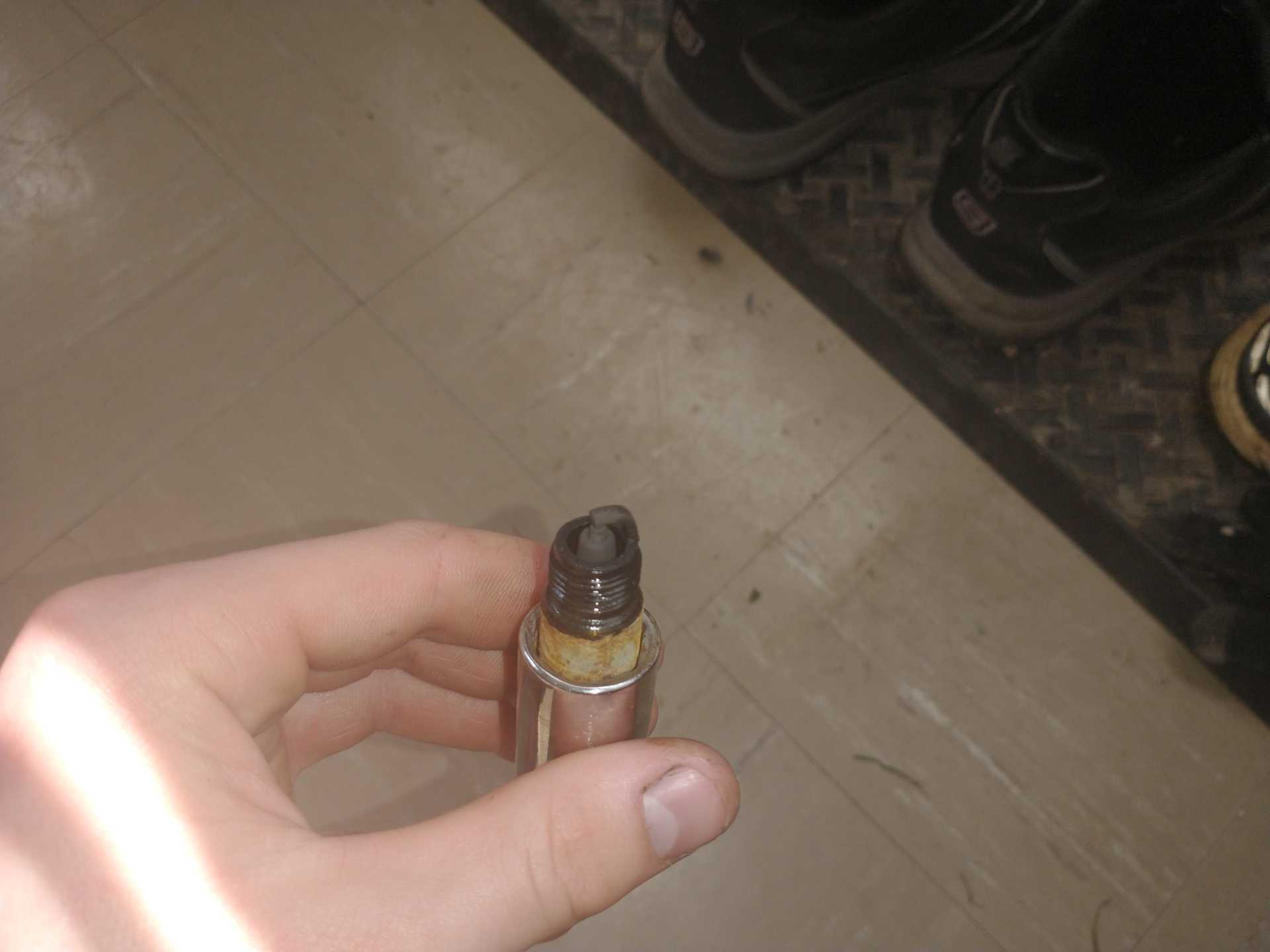

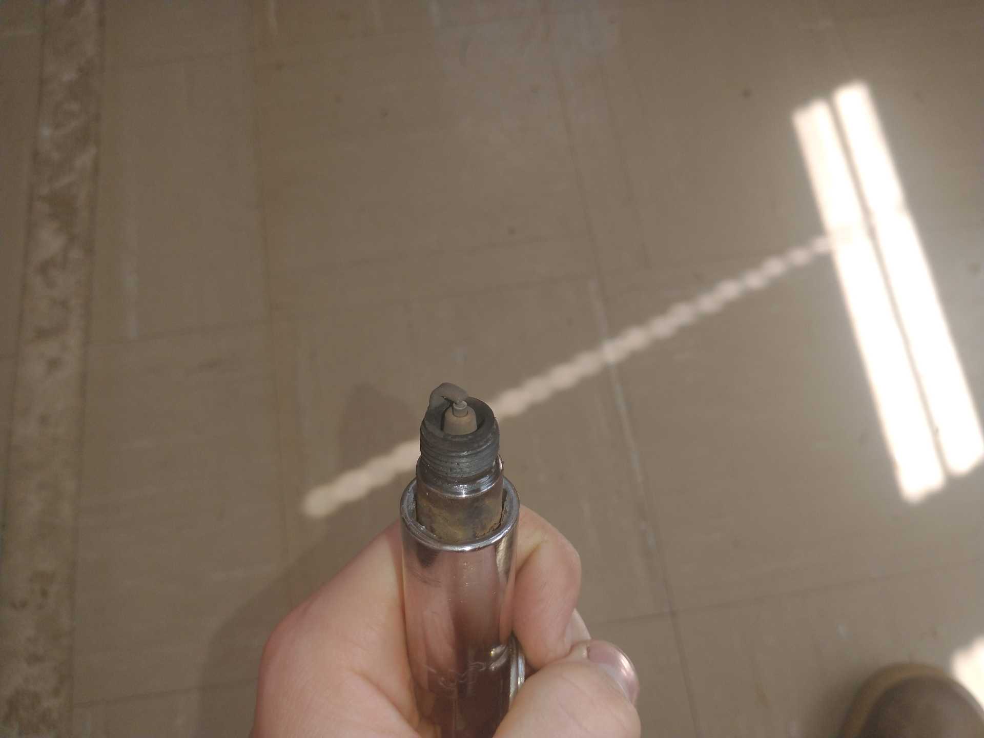

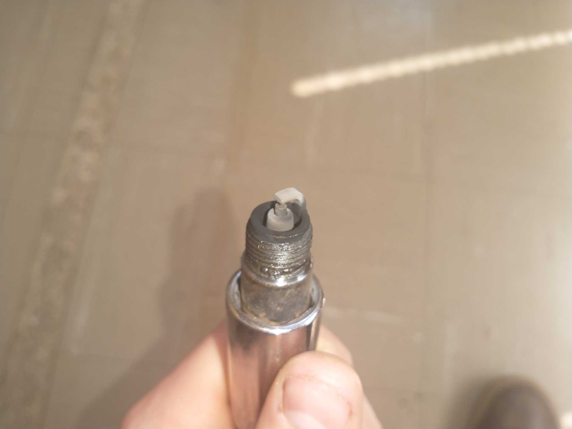

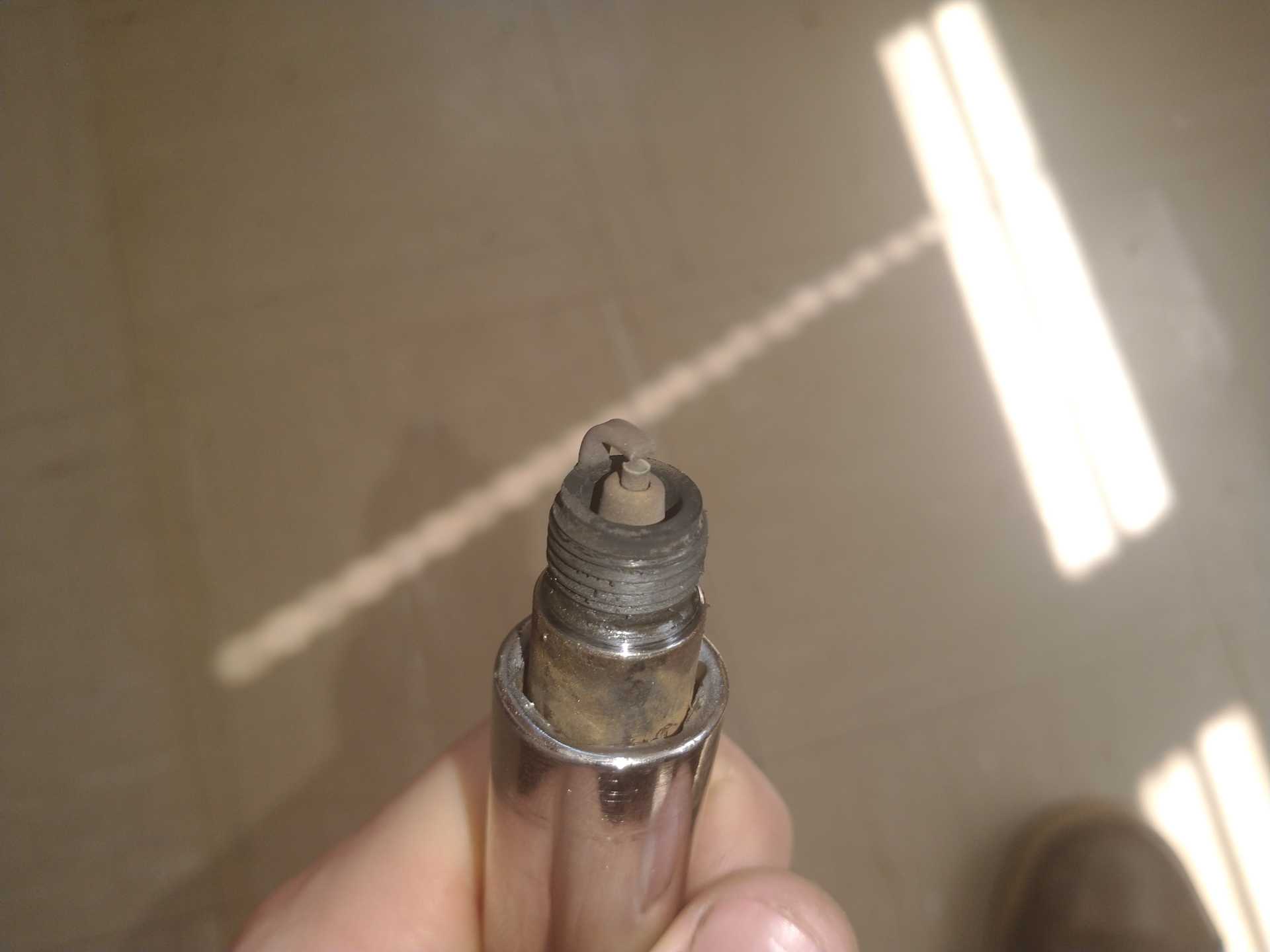

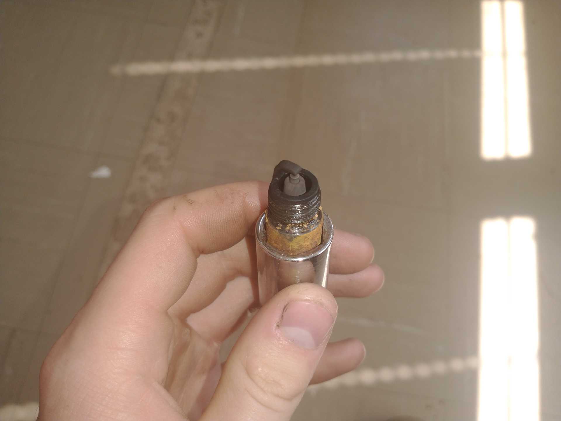

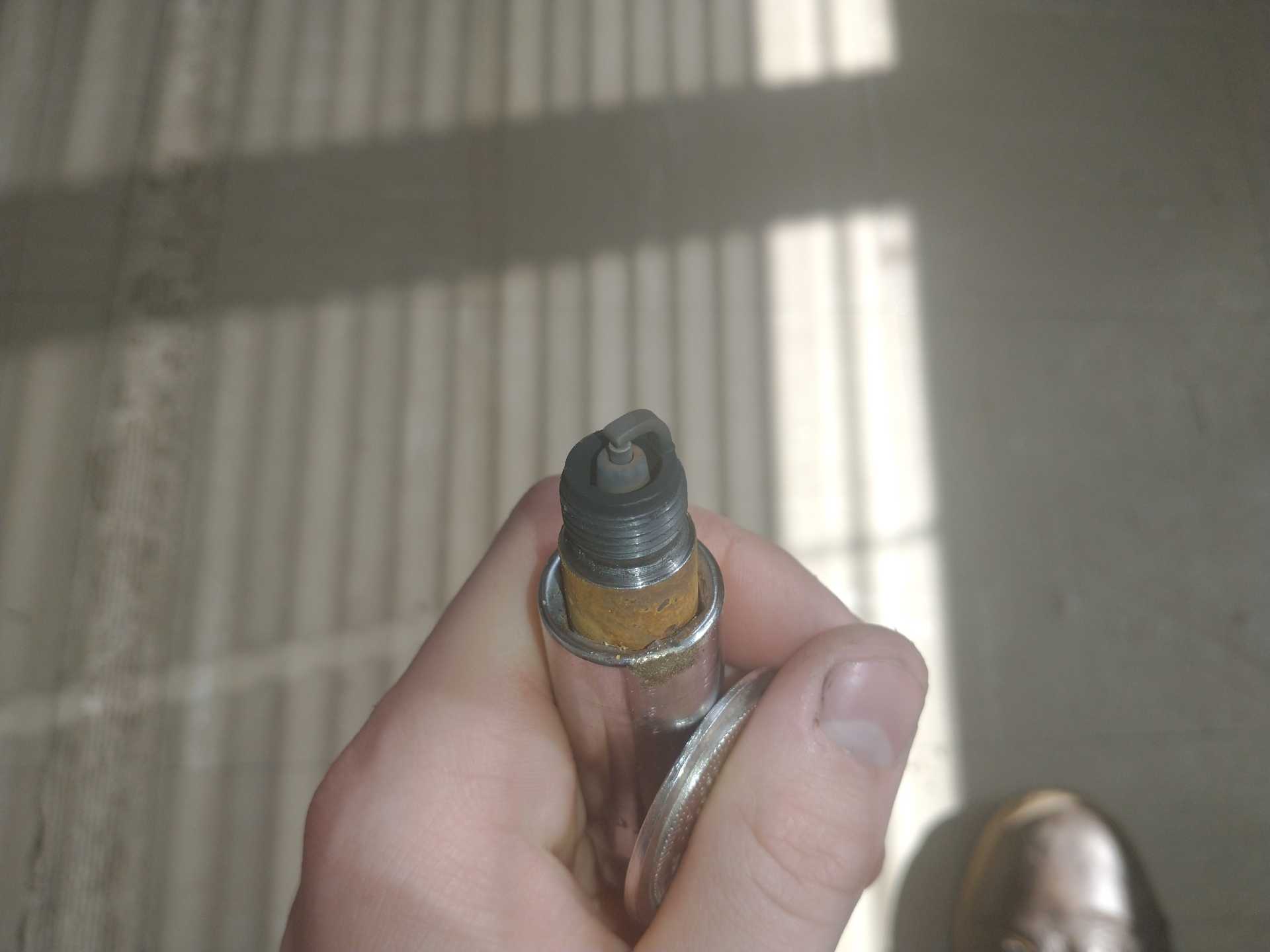

Report this Post07-09-2025 06:12 PM Click Here to See the Profile for 1985 Fiero GTSend a Private Message to 1985 Fiero GTEdit/Delete MessageReply w/QuoteDirect Link to This Post
Checked my spark plugs, a little sooty, but the insulator and tip are a lighter gray. No buildup, erosion, slime, etc.
Plus 1-6
All of them looked very similar in person, my phone camera is pretty bad, number 1 and 3 are the closest to how they look in person the other ones showed up darker on camera than they are.
Spark gap was at 0.045", with one at 0.050". I lowered them all to 0.040" to be on the safe side, and then did a little more driving, with no ping/knock.

Report this Post07-09-2025 08:57 PM Click Here to See the Profile for pmbrunelleSend a Private Message to pmbrunelleEdit/Delete MessageReply w/QuoteDirect Link to This Post
I ran 0.030” spark plug gaps for a long time, but in more recent tests in the 210-215 kPa range, the engine misfired, so I backed it down to 200 kPa. In my next steps, I think I will try 0.025” gaps and then see if I can increase the boost again.
A misfire will be accompanied by a power loss. Knock will not necessarily cause a power reduction.
I don’t see anything horrible on the spark plugs, but obviously the idle/cruise mixture seems like it’s still too rich. I guess it’s on your to-do list.
Are there any altitude changes with your driving? The greater the altitude, the greater will be the pressure ratio (and therefore temperature rise) of the compressor. Hotter air will be more knock-prone.

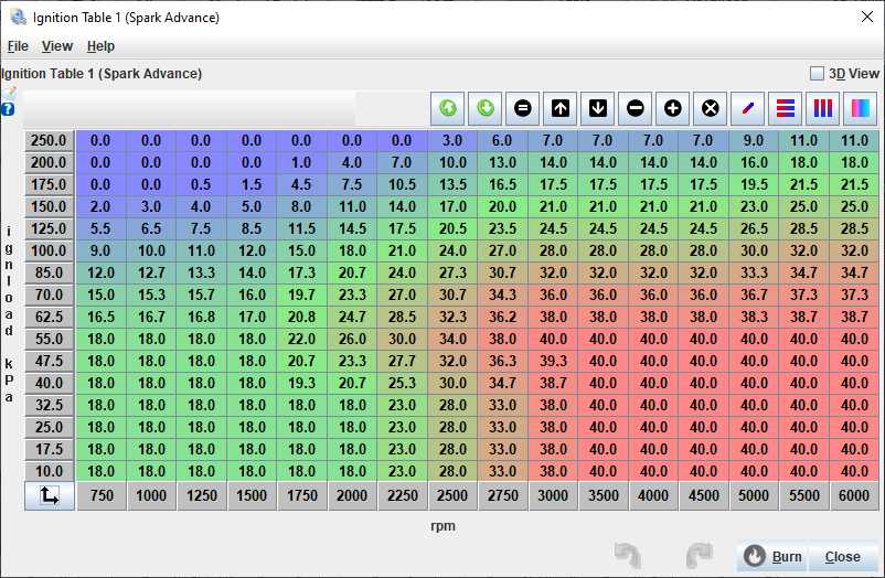

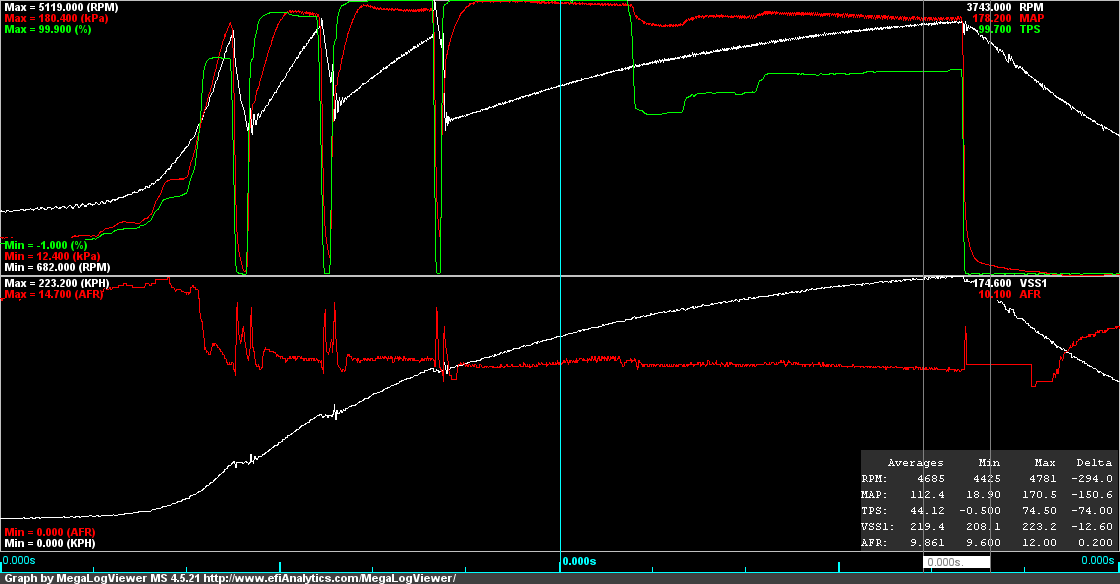

Ok, now that bothersome ping seems to be gone (I raised the advance to up to 10* at 200 kpa now, no ping has returned), I felt confident enough to take it to some higher rpms, up till now I've done 1000 kms shifting at 4500 or below. I did a couple of accelerations up as high as it would go, which immediately showed something wrong, as it was like a soft limit at between 5000-5300 rpm, boost remains at 195kpa, there's no breaking up, no extra noise, no detonation, it just rapidly falls on its face between 4500 and 5000, and tops out at 5000-5300, when the throttle is being applied. If I stay at 30-40% TPS (like 110 kpa), it pulls smoothly at that amount up past 5500 (highest I've gone), but as soon as the throttle is floored or increased enough to go into boost (spooled from 116-140kpa, with increase in throttle, and a slight decrease in rpms), it falls on its face, release throttle a good bit, it goes as normal. I removed my plugs and regapped to 0.030", no change.
So I'm thinking this is exhaust back pressure? If it were spark blow out then I don't think it would feel/sound so smooth, it is still firing normally on all cylinders, but somehow that isn't translating into power. Same reason I don't believe it to be detonation. I don't think it's valve float because it drives fine at no boost with little throttle, and just using the throttle I can go from normal accel no boost to full boost with no acceleration at all. Literally the only symptom is that it falls on its face at 5000 rpm under boost.
I can try disconnecting the downpipe from the cat flange, and just have the 2 feet of exhaust coming down from the turbo and see if the restriction is post turbo.
Any ideas?

Boost applies pressure to the intake valves and tries to open them. I suspect you are seeing valve float and need stiffer springs.
Without boost you are able to rev a little higher because boost is no longer helping to push the valve open.

But then wouldn't that same level of boost be opening them at lower rpms? I hit 195 kpa at 3300 rpm and it stays there all the way up. Also wouldn't the valve train rapidly get very noisy if the intake valves are being held open, then the lifters and pushrods and rockers would just be flapping around. At 5000 rpm, transitioning between low throttle and higher throttle, there's no change in valve train noise, no additional noises at all other than the turbo, but the engine falls on its face. Also at that rpm the bog isn't just happening at 195 kpa, it's happening with as little as 50% throttle and 150 kpa when I quickly increase the throttle pedal while already at those speeds.

Misfires feel like hitting the rev limiter... the rev limiter is a series of "desired" misfires.
I think that valve float could happen smoothly without any bad sounds.
Valve float happens when the valve spring is not stiff enough to apply enough force to keep the lifter in contact with the lobe as it descends. The faster the camshaft is spinning, the stiffer the valve spring needs to be to maintain contact.
Boost pressure on the intake valve counteracts the valve spring force.

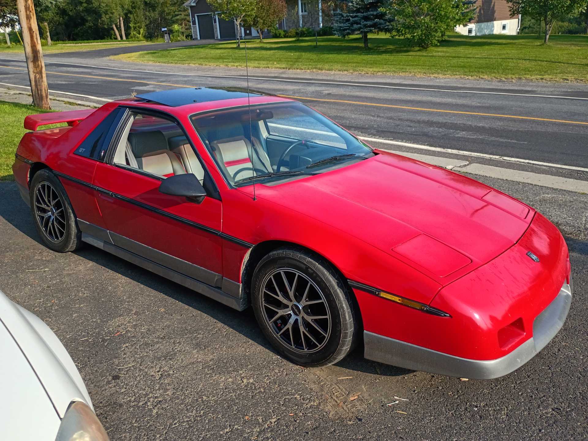

Valve springs changed a while ago, now it revs much more freely.
I got some touren wheels, 16x7 42mm front, 17x7.5 42mm rear, and Firestone Firehawk Indy 500 tires, 205/55r16 front, and 235/50r17 rear. I wanted a significant outer diameter increase for the rear, as I wanted a lower cruise rpm, now 2400@110 km/h. I might have wanted wider rear tires, but they aren't available with enough sidewall for the bad roads here, and a large enough diameter to put the rpms where I want. The only matching rims front and back with different widths I could find were only half an inch, in my budget, that's why I don't have wider tires on the rear, the tires match the rims pretty well and have a good sidewall and diameter.
I put coil overs on the rear, 10" 250lb eibach springs, and did my best to calculate flat ride and shift the balance slightly towards the rear because of my rear sway bar (it was slightly more oversteer than I could want) and to match the rear to the front (Camaro springs cut down) but some calculation was wrong as I didn't have to cut the springs down as much as I expected (first cut was supposed to be a safe, tall cut, instead was basically right on my intended final result). Anyhow maybe it isn't matched as well as I thought, but it rides great, basically feels like it did, but just a bit stiffer. Also lowered the front bump stops, jacked up the suspension with no spring to make sure the wheel clears the wheel well and lowered the bump stop to get it closer, ended up being about 5/8" shorter.
With the wheels being spaced farther inwards, and 205 front instead of 215, steering effort was greatly reduced, like by a lot, I'm also experimenting with removing the steering shock, now that the wheels have higher offset, bumps don't act on the steering as much, and I like it, slightly more movement of the wheel going over bumps than with the shock, but much less than my dad's stock Fiero with seemingly a blown steering shock. Perfectly drivable and enjoyable, and makes inputs feel even lighter and quicker.
Stock (but great shape/fresh premium pads) brakes feel slightly less effective with the larger diameters, but still good, and I don't mean less effective in total stopping power, as the old tires locked up before the brakes topped out, but everything requires a little more brake input, but I can still get the tires to squeal/lock if I want to.
I have an autocross tomorrow, so I'll see how everything is balanced driving on a course, I know on the road everything feels great, but I haven't had a chance to take some corners to feel the front/rear traction balance much yet.

I did the autocross, my Fiero feels much more balanced now than before with stock suspension and a rear swaybar. The tires grip very well, and the engine and transmission were great. I myself tend to get lost on autocross courses, especially the huge one here at the closed Loring AFB, so my times weren't very good compared to others in my class, but they are much better than they were 2 years ago. upon exiting the autocross area, there's a closed 1.5 mile taxiway/runway you drive down, and I opened up the throttle, I hit 223 km/h @ 75% tps, 170 kpa, and about 4800rpm (first time going that fast, so I was easing into it, that is I was until the headlight doors popped up, then I slowed down. Also to verify the calculated ecm datalog speed, I calculated the speed based on rpm, gearing, and tire size). Definitely had much more to go, but that was enough for me!

Sounds like the car is running well.
How is it at 223 km/h? Does the front end feel light in the steering?
I see you still have the hardtop. You are autocrossing the car, and handling does seem to be important. Are you sure that the T-top modification is a good idea? It is going to be a weight adder, and a strength/stiffness reducer.
How do T-top Fieros drive?

It is so far!
Planted, solid, almost serene. It feels no different going straight at 220 than straight at 110, there were no curves or bumps, so I can't speak about that, as it didn't need hardly any steering input, I mean I felt comfortable enough to take a hand off and wind my windows up at about 160 (it was getting a little too hard on the ears haha), it certainly feels much much better at those speeds than my dad's Fiero at just 80, it has a lot of bad bushings and a bad alignment.
I've autocrossed only twice now, I've never driven a t top Fiero, so I don't know how that will effect stiffness, and while handling is indeed important, my Fiero is not so much a sports car in your definition. I like the GT designation, comfortable for Highway driving, good, not necessarily best handling, a fun amount of power, but perfectly drivable and smooth when required, a nice combination of luxury/performance. My Fiero doesn't have AC, and I like driving with a lot of airflow, and being in more of a "fishbowl" with lots of glass or open air all around me, so for the looks inside and out, and the added airflow, it will be worth less chassis stiffness. Realistically with these tires and springs/sway bars/bushings I have, it handles almost a little too good, my 140lbs is losing traction in the seat before the tires! If this were a track car or more sport over touring oriented, I would likely have racing seats or something with better side support, but for me the Mr Mike's seats are staying, no question about that haha. I also don't think the weight will be increased much, the whole roof panel can't weigh more than 25 pounds extra, and the sunroof I have already is pretty comparable to the 2 t top panels, they almost seem to be a thinner glass, I don't know.
If I get a chance to go that fast again, I'll make sure to pop the hood first, to relieve some of that air pressure. Speaking about performance vs comfort, I don't want to do a hood vent, because then my only source of air with a closed cabin would be heated up by the air from under the hood, I enjoy how cool the air comes in compared to front engined cars, if I had AC that wouldn't matter either, but I don't so for me maybe having slightly cooler vent air is more important than maybe having less pressure buildup over 200km/h.

I have been working on the ve table, getting things leaned out significantly, and normal driving more efficient, that's going pretty well. I also did more looking into the spark tables and compared what I had (fairly close to an older table from PMBrunelle), and the original 2.8 table as shown in the book "High Performance Fieros", and the stock table has spark advance much much higher than I was running. I don't know what PMBrunelle has settled on at the moment, but for the last few days I've been running the stock table in the vacuum section, and I haven't noticed any pinging/noises/whatever. I haven't necessarily noticed a power improvement, because when I'm heavily scrutinizing all the sounds and whatnot coming from an engine, I don't notice power differences, I will likely switch the tune back and forth a few times to compare when I'm not specifically scrutinizing everything else. I'm also experimenting a little bit to try and get back the burble my stock engine and my dad's Fiero had, I haven't finished that, but that's why I have some very retarded parts at the bottom.
This is my current spark table, based as close as possible to the Fiero original, erring on the side of less though for in between values where the tables didn't line up.
The book values for the stock table:
The less dense the air/fuel mixture, the slower the flame propagates through the combustion chamber, so the more spark advance is needed to maximize work on the piston. The stock timing table reflects this tendency.
This is what I was running last with the Muncie (such as during the ride I gave you):
Below 55 kPa in the lower RPM ranges, I'm having the timing advance become more retarded rather than more advanced. I was having bucking/oscillation problems at low throttle, and shaping the timing table like this (retard in the problem area, with gentle transitions to the rest of the table) mostly fixed those problems. This behaviour was sometimes implemented on older cars with the vacuum advance canister being connected to a ported vacuum source, rather than to manifold vacuum, sometimes to reduce NOx emissions at low throttle.
If you don't have driveability problems, then there's no reason for you to shape your timing table like this.
With my Getrag F23, I expect to cruise on the highway at lower RPMs, perhaps around 2500 RPM, so I adjusted the spark timing table to have more advance in that area than before:
This will need to be tested when I get my car running again.
How does the car drive if you keep the MAP between 17.5 kPa and 25 kPa? Does the timing jump around too much?
Ok, makes sense. For your tires (255/40R17?), should theoretically be ~2350 rpm@100 or ~2575@110km/h
Originally posted by pmbrunelle:How does the car drive if you keep the MAP between 17.5 kPa and 25 kPa? Does the timing jump around too much?
That is almost impossible to do, it idles at 28-30kPa or so, and 0% throttle engine braking is 15-20kpa, I've only seen 10kPa in the datalogs a couple of times, at the initial release of the throttle after an acceleration, before the idle valve starts to reopen. When driving, the only time I see the timing starting to retard is when I am fully or almost fully engine braking, but certainly not at any point where I am cruising/maintaining speed.
