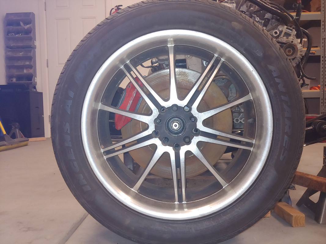

Since I finally have figured out how to post photos (I think), here is my progress so far. Most of these are mounting the engine/transmission to the cradle. The last few are the way I chose to get a VSS signal. Please be kind with comments. I'm old you know.
Daryl

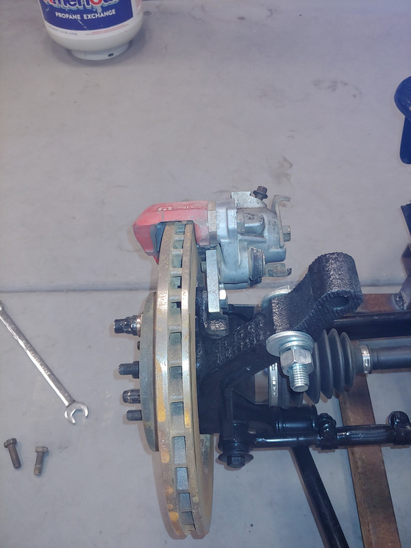

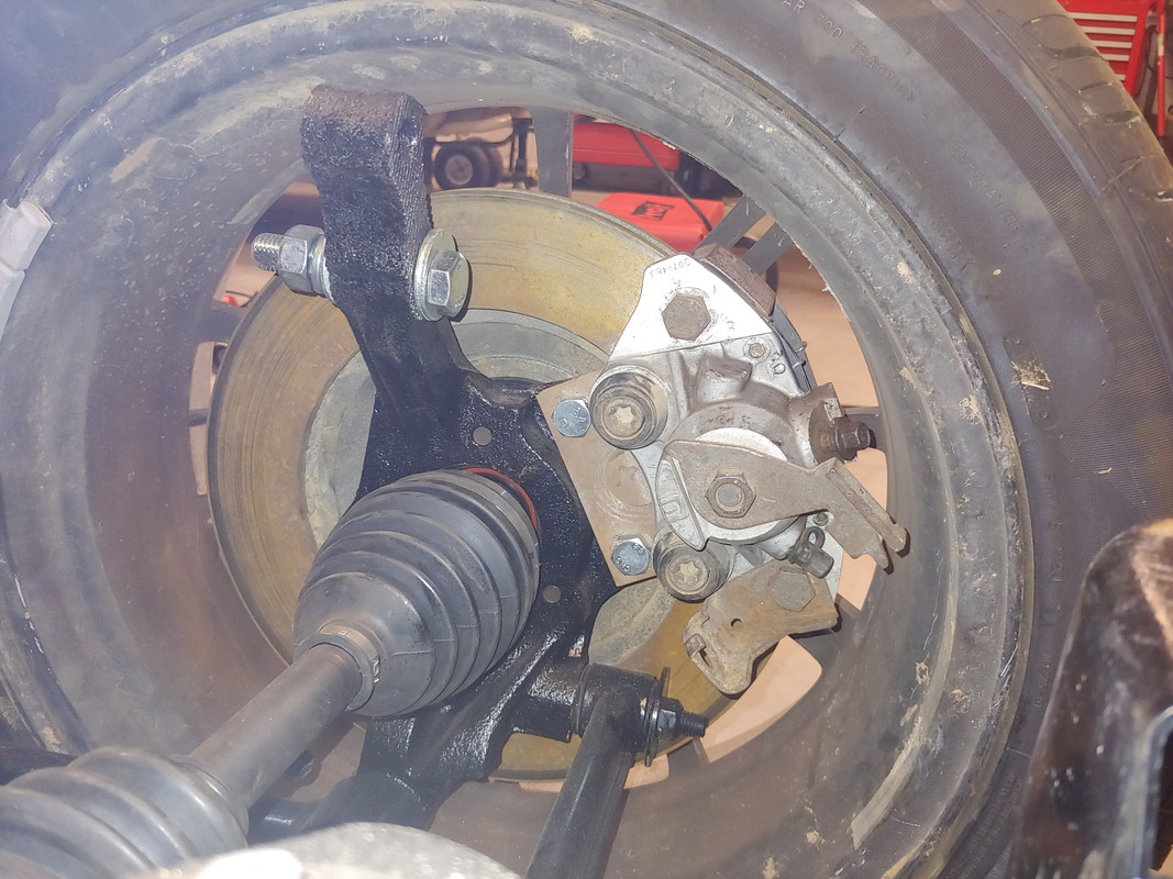

Fitting brake mods today.

I set up this up compensating for proper ride height just to look at axle angles and such. Anyone see anything I should look at? This is the first swap I've done so don't be shy.

Report this Post01-22-2019 05:59 PM Click Here to See the Profile for WillSend a Private Message to WillEdit/Delete MessageReply w/QuoteDirect Link to This Post
What axles are you using again?
If the combo hasn't been tried before, you may want to cycle the suspension through its full range of motion to make sure you don't run out of inner CV joint plunge depth... in either direction.
Although that will be difficult to verify without the upper strut attachment in place.

Report this Post01-22-2019 06:25 PM Click Here to See the Profile for Daryl MSend a Private Message to Daryl MEdit/Delete MessageReply w/QuoteDirect Link to This Post
Will, already checked for that. Kept the hub face perpendicular to the floor. Moved through the range of motion without moving too far in or out. I think I am OK there, but thanks for the suggestion. That would be a problem if missed.

Report this Post01-22-2019 06:33 PM Click Here to See the Profile for fieroguruSend a Private Message to fieroguruEdit/Delete MessageReply w/QuoteDirect Link to This Post
Even if the axle setup has been used before, placement of transmission could be different, so it is always good to cycle and verify no binding or over extension. Ideally I like to do this with the tripot boots removed. To do this, install the drivetrain with the suspension, but leave the springs off the struts. Then you can raise and lower the suspension while turning the wheel bearing by hand.
Here is a sample picture of verifying this on the driver side.

Report this Post01-22-2019 08:07 PM Click Here to See the Profile for pmbrunelleSend a Private Message to pmbrunelleEdit/Delete MessageReply w/QuoteDirect Link to This Post
Maybe Daryl needs to put the engine + cradle into the car to perform this verification.
I as progress in my own engine build (not even a swap), I'm arriving at the conclusion that I will need to temporarily install and then remove the engine + cradle a few times, just to take measurements and see how things are fitting.

Report this Post01-22-2019 09:52 PM Click Here to See the Profile for Rickady88GTSend a Private Message to Rickady88GTEdit/Delete MessageReply w/QuoteDirect Link to This Post
This is true. There is no way you could get an accurate measurement on the axle length/tolerance. As has been said, take the springs off of the struts and install the drive train and entire suspension. Then lift the suspension up all the way to the bump stop and turn the wheel hub the entire time as you lift the suspension. I used a floor jack and from full droop to bump stop, check many times that no binding grinding or (in the case of a short axle) make sure it does not fall out of the tripot. Do this several times on each side. And it is great advice to have the boots off aswell.
My engine swaps went in and out easily a dozen times checking for this or that.
