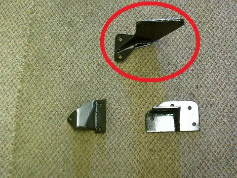

not lining up. hmm.... :\
this is a L32/Getrag combo.
Wow, after seeing that previous page, I think I need to say that his work is top notch and a damn good service to provide us. Gotta remember he's doing this in his spare time. Good things come to those who wait.
This is common on the manual swaps. GM's hole stamping in the cradle varied quite a bit. You may need to make the slotted holes in the cradles longer. Sorry i can't get a mount set to fit every application.

OK guys i got a tip. I don't have your mount but do have the west coast mount which is very similar. I did not line up. I was off close to what you showing.
I Unbolted the motor mount from the engine all together.
Bolted the rubber mounts all way around loosely to the cradle. Enough i could slide as i needed
Set the engine setup down and got one trans mount lined up and nut screwed down so the threads where flush with the nut.
Set motor mount on the rubber engine mount and slowly lowered the engine down while another person worked on lining the motor mount to engine holes up.
At this point I had the one trans mount in and the motor mount in but other trans mount was off half a hole. Took a pry par and Slightly pried the rubber so it moved. It popped in and I then tightened everything down.
Took a total of 5 mins and two people watching everything very closely. But I didn't have to modify anything. And the rubber mounts were not strained at all they just need to be lined up. All motor mounts have that little bit of give needed to line things up even polys. Hope this may help you out a little.
