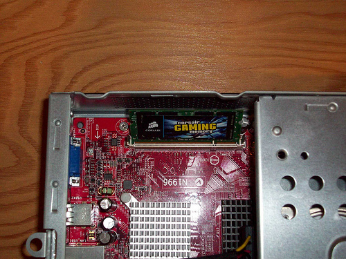

3. RAM.
Again if you don't have it laying around, the Wind takes 200-pin DDR2 notebook memory, up to 2GB. You can get this at Newegg for about 20$.

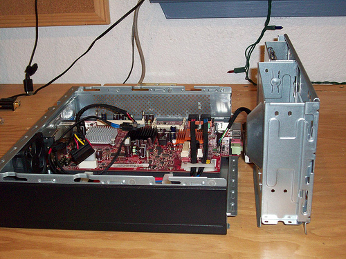

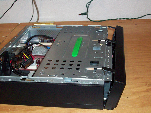

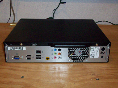

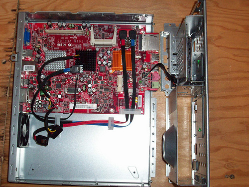

2. While that is burning put the Wind together. Remove the two top screws in the back of the case then slide off the top panel.
Then remove the face plate (undo the three tabs at the top and pull forward).

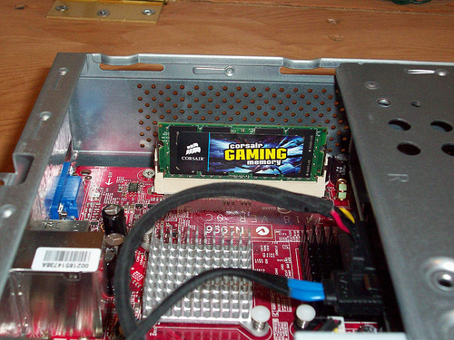

Then remove the two screws holding the drive rack on. Once you have done this put your drives in.
If you are just using a temporary DVD drive leave it apart for now and just make the internal connections,
otherwise screw the drive rack back on. Now, plug in the sata and power connections for both drives, and clip the front panel back on. Before you put the top cover back on install the ram (you have to install at an angle then clip it upright).
Finally, replace the top cover. You now have a fully constructed Wind!

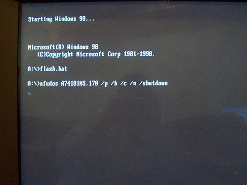

3. You can skip this step if your BIOS is version 1.50 or later. If you are like me and got your Wind with BIOS under 1.50 then this is for you.
Install the HP format utility from the downloads page (here). While this is installing, find a flash drive. Once you have found the drive (probably in a pair of pants) back up all needed files on the drive onto your computer. Extract the Windows 98 boot files to a folder on your desktop or something (not the flash drive). Now run the HP format utility, check the DOS boot files box and browse to the win98 files. You can either format the drive as fat or fat32, (didn't try ntfs) and apply. Once this is done extract the msi Wind bios update to the drive root and eject.
Plug the drive into your Wind and mash the F9-F12 keys while booting to get to the boot menu. Select your flash drive. The Windows 98 DOS screen should shortly follow when it does type in "flash.bat" and hit enter,
after it is done your Wind should restart, pull out the drive. Your Wind may come up with a bad BIOS checksum error (mine did) ignore it (hit F2) and proceed.[/color]

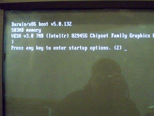

5. Now insert your scratch free, fresh sharpie-labeled disc into the DVD drive and boot (you may have to mash the F9-F12 keys again to select the DVD drive). An all text screen should pop up asking you hit any key to boot from disc with a little timer counting down,
hit any key. Another screen should pop up with a bunch of text, your screen may flash a couple times and it should take no longer than 5 minutes.

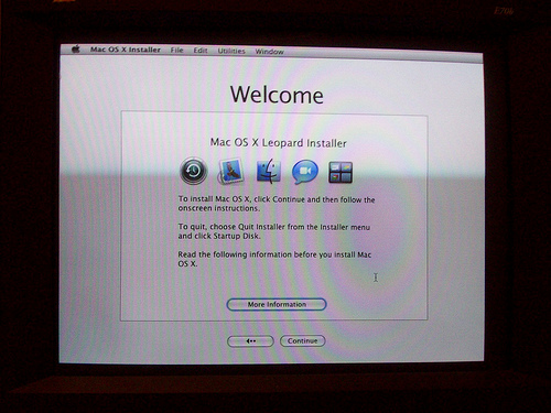

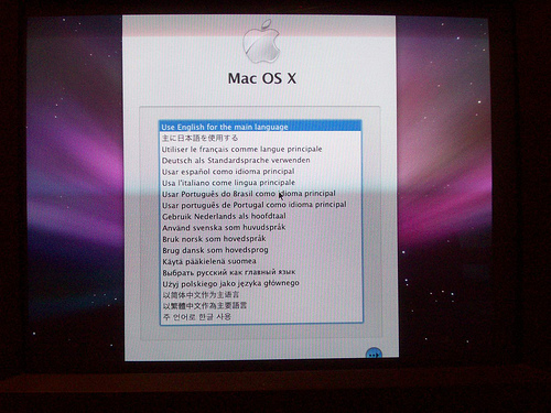

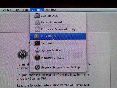

6. After a short time a grey screen will come up, select your language.

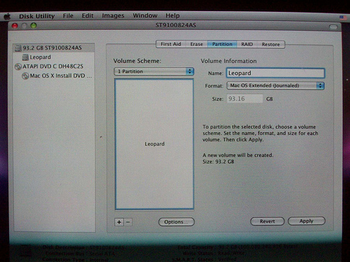

Now at the top bar got to Utilities-> Disc Utility.
Part 3:

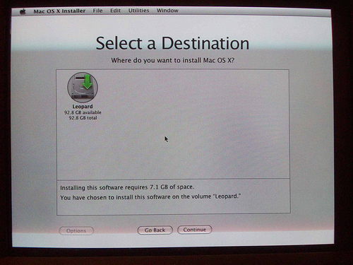

Now follow the steps to partition the drive 1 partition as Mac OS journaled (name it something pretty like Leopard),
hit apply then tell it to apply again. When you get to the license agreement *do not read it;* a small kitten may die if you do.[/color]

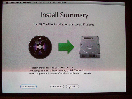

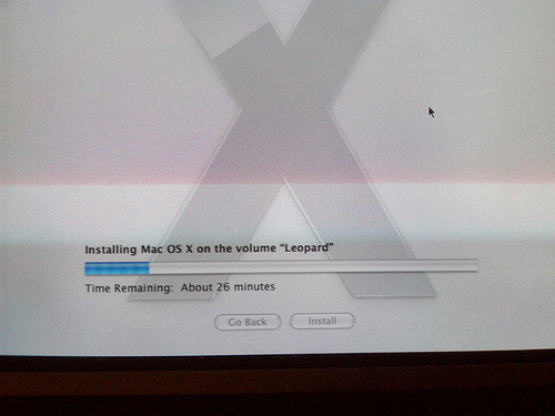

7. Follow the rest of the steps to install, selecting your new freshly made partition.

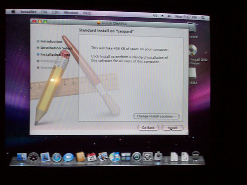

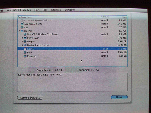

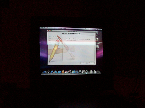

*Before you install, hit customize.* Now expand the Patches section until you see kernel and uncheck it.
Now install, which should take about 30 minutes, give or take a few, and then restart.

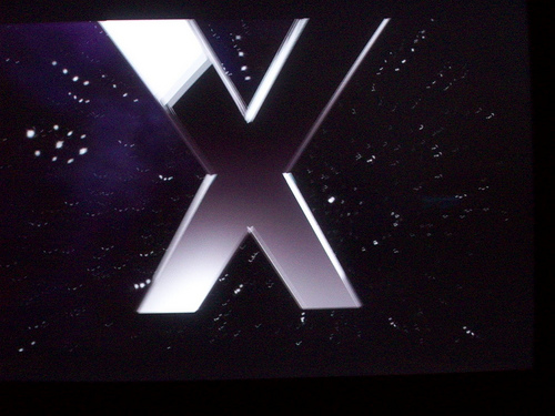

8. The screen that asked you hit any key to boot from the disc should come up again;

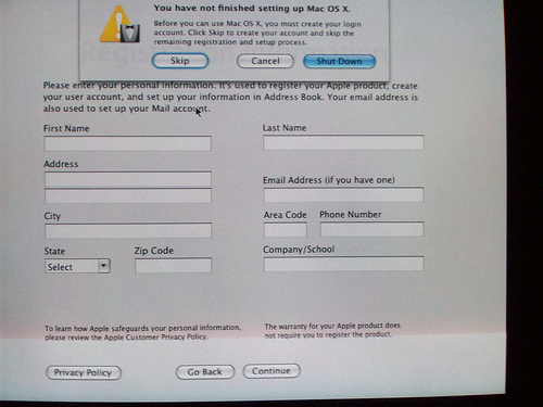

this time just let the timer run out. It will take a minute but the OS X set up will come up, just follow the very easy steps.
Part 4

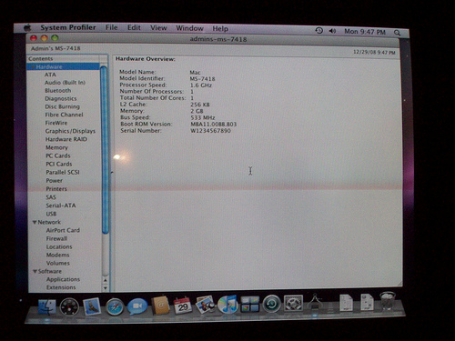

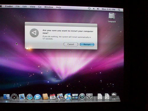

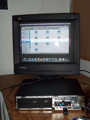

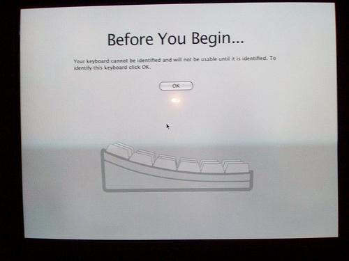

Once it gets to the desktop restart the computer so the Ethernet will work.[/color]

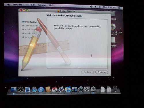

9. After it has restarted, open and unarchive the other file that you downloaded, install the GMA950 package, and restart a final time.
10. Congratulations! OSX is installed on the Wind, and you can remove the install disc as you won't need it again until your envious friend wants to make one for himself. I suggest you visit Lifehacker for a bunch of tips and tricks for OSX. Also, doing the non-program updates (system updates) will screw it up; they attempt to modify the modified kernel. For now just update iTunes and the like. If you have any questions or need any help, feel free to email them at guides@uselessninjas.com and don't forget to visit their blog for our latest exploits/hacks/spouts of boredom.
