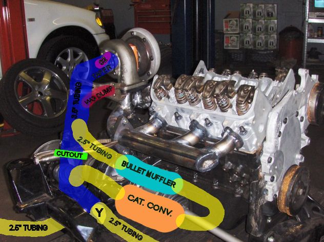

Originally posted by ericjon262: careful with "bmw guru" see "project Midturbo"
Yes, I dropped the ball on that swap. I dropped the ball by letting the customer design the swap, provide the parts, and control the build. We did the best we could until we just gave up out of frustration.
This is what I was told to build with the exhaust by the "engineer". The cat is after the muffler which will never allow it to get to temperature to fire off, the o2 is too close to the turbo, and there is no way in hell all that tubing would fit....and I was instructed to not cut the trunk. I didn't disclose a lot of what went on with that build, but there was a lot more behind the scenes than either me or Alltrbo let on.
[This message has been edited by bmwguru (edited 10-29-2012).]
