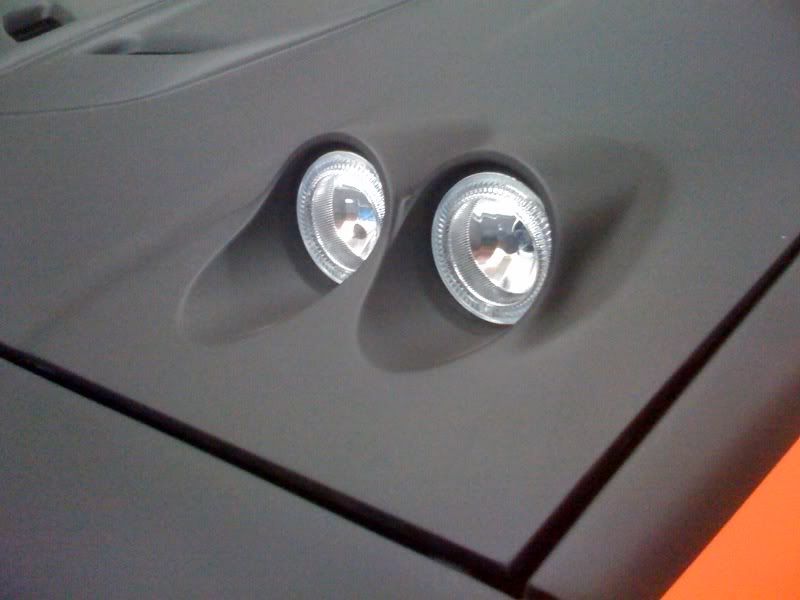

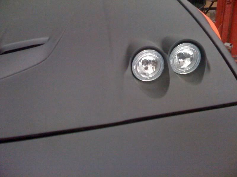

heres a few requested pictures of the headlights.
Ive still got some wiring to do, these are just temped in. Im putting HID's in there, but I havent decided which ones I want yet.
The lower door sections were glued on with a product from Norton called SpeedGrip panel bonding adhesive. Part number 06115. Uses a special applicator gun thats like $40, but it works. You will find a lot of uses for this adhesive. You can literally glue a wet fish to a piece of drywall and it will stick. Its incredible. You could glue your entire car together and not use 1 bolt and it would never fall apart. anyway, hope this helps.
