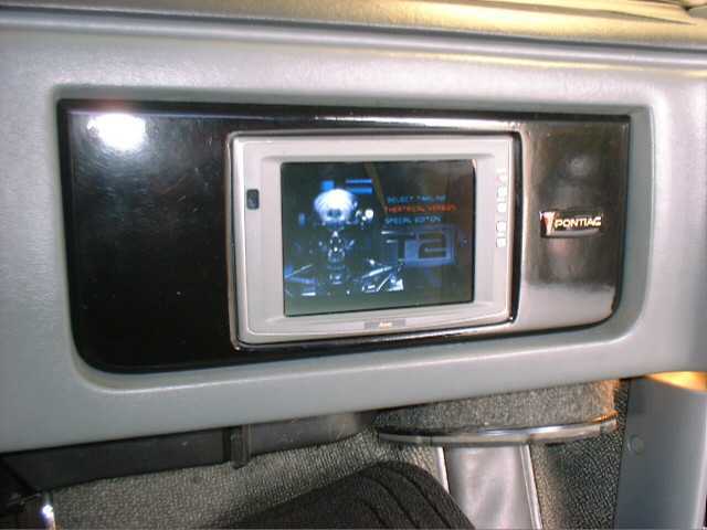

Originally posted by AutoTech: I was going to cut out an appropriate size opening between the window switchs and mount this flush.
About the idea and product - AWESOME!! that would be way cool in the space between the window switches
So cool I would consider giving up my power mirrors LOL... J/K
Any other ideas where to mount it ? They should make a BlueTooth version so we can mount it on the steering wheel.
(just don't try operating it in a turn LOL)

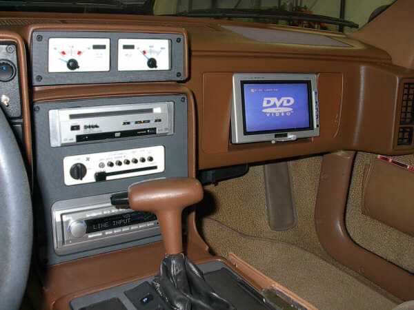

My suggestion is to move the power mirror switches. How often do you adjust the mirrors, compared to mousing/shortcutting?
A good spot would be a) under the trunk release switch (if that spot is blank), or b) on the left side of the steering column somewhere. (where it's supposed to be ) (passengers should not have access to the mirrors -sensai says )
That location is just too great to pass up on an input method.

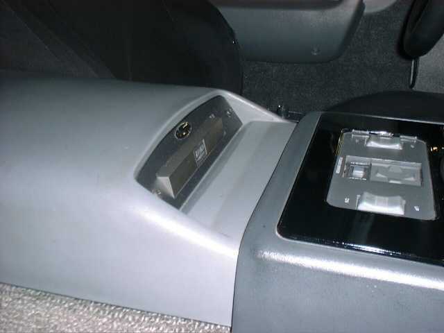

Capt Fiero
Posts: 7658
Registered: Feb 2000
Total ratings: 260
Report this Post02-28-2008 02:15 PM Click Here to See the Profile for Capt FieroClick Here to visit Capt Fiero's HomePageSend a Private Message to Capt FieroDirect Link to This Post
Will post better pics and a breakdown of my "carputer" LOL. Its a Pocket PC, running windows mobil 6, loaded with assorted movie and music players, TomTom Mobil Navigator and such. Checks all my emails for me and because it is my cell phone, it can upload/download everything on the fly. Including running Internet Radio stations. I have a docking plug for it that I will post later, its plugged into an external Mic and the Car Stereo to use it as a true car kit.
Its pretty cool, oh and it is a touch screen to boot.
[This message has been edited by Capt Fiero (edited 02-28-2008).]
Mister
Posts: 1975
Registered: Aug 2004
Total ratings: 56
Report this Post02-28-2008 02:25 PM Click Here to See the Profile for MisterSend a Private Message to MisterDirect Link to This Post
Talk bout an "All in 1" plug an play gadget. If it would make coffee and ...................... you can marry it
Just kidding Fierochick
[This message has been edited by Mister (edited 02-28-2008).]

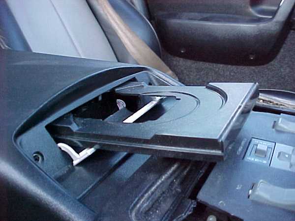

Capt Fiero
Posts: 7658
Total ratings: 260
Report this Post02-28-2008 07:23 PM Click Here to See the Profile for Capt FieroClick Here to visit Capt Fiero's HomePageSend a Private Message to Capt FieroDirect Link to This Post
Sorry about the pic quality, but here it is closed up and a few shots of the charge/USB/audio output jack.
Its a pretty slick little setup and we find ourselves leaving the laptop and Streets and Trips setup at home. The only limiting factor to this setup is the storage. I currently have a 6gig Micro SD Card in it now and there are larger cards, or owning several 6gig cards. But it would sure be nice to have 80gig of HD space on hand. I guess being solid state I never have to worry about drives crashing though. LOL The cards just slide in the side so you can do it on the fly and they are hot swappable. The Audio manager interface is very much like the I-Pods. Sort by Genre and so on. We just bought FieroChick an HTC Touch, which is basically the exact same device hardware and software wise, it just does not have the slide out keyboard and weighs about 1/2 of the Tytn. It has the exact same screen though. I do have to say that gaming on the go with it kinda sucks if you want any decent 3D game support. The phone itself unfortunately costs more than some cheap laptops. When I got it, retail on it was around $700 however on a contract with my wireless Carrier it was only $250. If you know someone looking to buy either one, make sure they do there research on the exact model that there carrier is selling. I have found some sneaky company's up here, that sell gimped versions of the phone IE Bell Canada sells there Touch with the WiFi portion disabled so you have no choice but to use their internet Data Packages. Fortunately we are with Rogers and they don't gimp their phones. I was even able to update all the software myself to enable a few functions like Video calling that were not enabled by default.
On a side note, I realize Laptops are the easiest way to set these carputers up. However has anyone tried in a Fiero, to simple use a mini-ITX board with a small UPS to sustain power, running a laptop drive and put it in a shoe box sized enclosure. Many if not all the current model UPS's have a feature to run a shutdown on the PC if it see's power drop off IE shutting off the car. You could probably load Windows onto a flash drive for even more data stability.
Mister
Posts: 1975
Total ratings: 56
Report this Post02-28-2008 07:41 PM Click Here to See the Profile for MisterSend a Private Message to MisterDirect Link to This Post
Looks very good Capt.
Could you post one driver POV picture so we'll see how it looks in the car.
My personal flavor in car customizing / upgrades is making things look like they belong there (as close as possible to stock) or better off invisible when not in use
Capt Fiero
Posts: 7658
Total ratings: 260
Report this Post02-28-2008 07:47 PM Click Here to See the Profile for Capt FieroClick Here to visit Capt Fiero's HomePageSend a Private Message to Capt FieroDirect Link to This Post
I am actully posting from it right now. Sitting at the tax office. LOL. When not in use it sits in my hip pouch. The mount is just a single suction cup on the glass.

Originally posted by Wheels1:
https://www.fiero.nl/forum/A...19-1-027960.html#p22

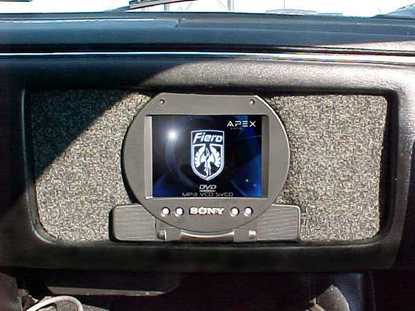

Originally posted by David Bartlett:
https://www.fiero.nl/forum/A...030819-1-027960.html
Yeah, I have the Apex1100 1meg in my car. Check out the thread. It works really well, but requires a little bit of work, the hardest part is getting the console solid enought that it doesn't bump the player. Road bumps are not an issue.

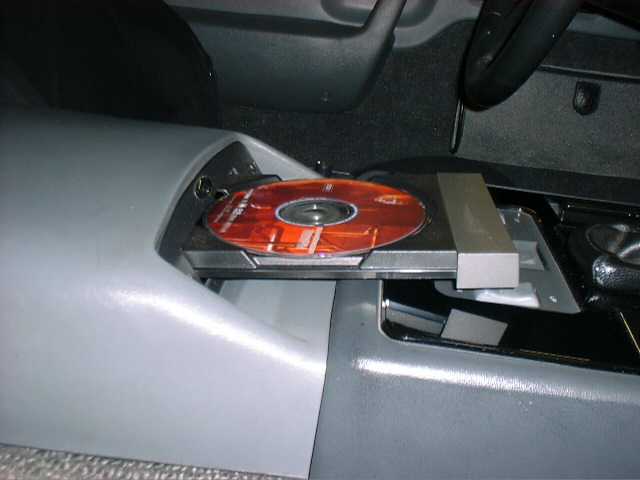

Originally posted by edbone:
https://www.fiero.nl/forum/A...020319-1-011861.html
Here are the pictures that I promised of the tv dvd and more. The dvd took alot of custom work internally underneath the console and also the dvd itself. Had to disect the dvd and move components around to make possible
unfortunately this entire setup was stolen in 2002

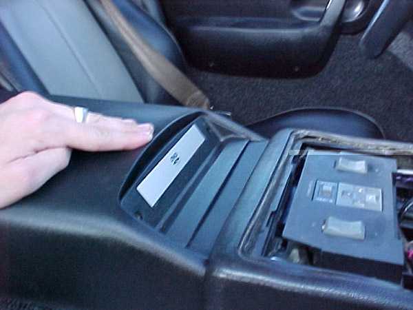

Mister, I found a great idea for "stealth", as an anti-theft device. ( I had that idea for quite a while, but now I actually found someone that has done it actually)
http://www.avic411.com/forum/viewtopic.php?t=13332
Here are the pics form the link.
It's been done before and is a good disguise for your stereo

Report this Post02-29-2008 10:17 PM Click Here to See the Profile for Capt FieroClick Here to visit Capt Fiero's HomePageSend a Private Message to Capt FieroDirect Link to This Post
I love the DVD Drive in the console that is the coolest thing I have seen done.
However I have seen the Dash mounted screens behind the pocket and to be very honest and blunt. I hate that. It is too far from the driver and at a poor angle to be anything more than a movie screen for the passenger. In my honest opinion, the only good place for the screen is in the center of the car either from the stereo area pointing up for mounted on a flip down from the overhead light area. My Pocket PC sits just above the center gauges and slightly to the left. The foot of the mount when installed actually rests one corner on the speedometer cluster.

Today's updates...
Had a few hours work today and improved some aspects of the install:
1. Heat disposition:
Found an old computer fan to try and fit into the console
And this stock opening in the console was just calling for it
Fits perfect between the insulation pads
The fan just barely fits between the back of the console and the ECM (The console sits about 3mm out of place)
Fan was connected with an RCA quick connect to switch power
The fan would be pulling air from the Laptop compartment towards the ECM and out the side vents
Drilled / cut an air outlet hole for the interior X41 vent
(Pic from below the console)
2. Console door solution (maybe temporary) Industrial grade Velcro
3. On / Off docking station push pin
As Austrian Import suggested I've found a golf tee and also an exercise-ball air plug
And the winner is...the air plug a quick drill through the left vent - and it's a perfect fit and function (have to paint it Grey)
Day's final status
Now I'll have to run some tests to see how the CPU temp acts...

One more update
I've purchased a Creative Xmod external USB sound card.
http://us.creative.com/prod...ry=668&product=15913
This unit will solve a few issues:
1. The X4 docking station I used has no audio out connection
2. The X41 build in sound card is of lower sound quality (and produces a "click" at the end of sound clips)
3. The Xmod is a designated sound card that uses the newest technology to improve and enhance all-around sound quality
4. Easy to reach and operate volume and mute control
Here is the Xmod unit
Now, again...do you see where I'm going with this?...
Some of you are not going to like this part...
It requires some Trimming of the plastic skeleton (trust me, I didn't like it myself)
And more aggressive trimming - of the ashtray courtesy light
This is the result - Both plastic pieces surrounding the ashtray were trimmed to accommodate the Xmod and wires plugging in. (line out & USB) I've kept the minimum required to support the ashtray door.
XMOD in location under the console
In the install process I've found that I can actually open the laptop in it's location which helps a lot when software mods are needed
I'm extremely happy with the final result It fits like a glove and works great
Comments about the sound quality will follow when I'll get a better chance to explore it.
