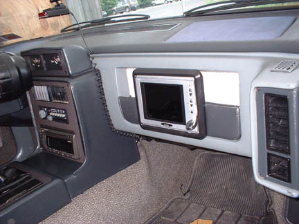

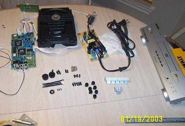

If you put "installed" in quotation marks then I have one installed.
I'm still working on the fiberglass piece that closes out the top of the dash.
I found mobile DVD still too expensive for my taste so I got an APEX 1100W home unit for about $50 and tore it apart. It works great in the car. Just used it on two road trips, (including Houston to Daytona Beach Florida). Sure helps the miles to pass when you are listening to a movie along the way.
If you find my advice useful, then please give me a positive rating, thanks...

Dang jscott1! That is a sweet set up!

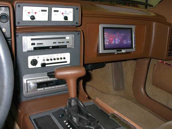

i have a tv and dvd set up in my 86 gt . i wanted something the kids and the wife could watch on long trips. but didnt want it by the shifter. i mounted it in the map pocket , have the dvd behind the seat and all the sound goes through the radio. or the passanger can put on ear phones and watch a movie and i can still listen to the radio. with where it is both the driver and the passanger can see it with no problem . plus with all the sound going through all the speakers in the car it makes for a great sounding movie.

Wiccantoy, Very nice set up!! Is the screen removable? What size is it?

Hi Chris, I remember you were a really cool guy, and your system was awesome too. Mine will look a whole lot better when I get that cover built. And I have some interesting thoughts about how I am going to control the DVD.
There was another guy who put an Apex 1100 in his center console. I got the idea from him to use a home unit. I don't know if he's still on the forum or not though.

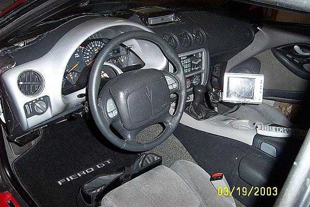

David Bartlett
Posts: 1090
From: Ancaster, Ontario, Canada
Report this Post04-16-2003 12:03 AM Click Here to See the Profile for David BartlettSend a Private Message to David BartlettDirect Link to This Post
Yeah, I have the Apex1100 1meg in my car. Check out the thread. It works really well, but requires a little bit of work, the hardest part is getting the console solid enought that it doesn't bump the player. Road bumps are not an issue.

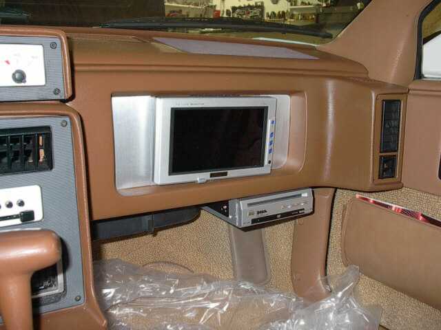

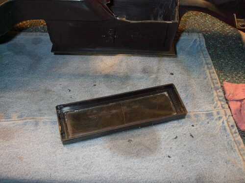

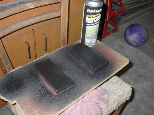

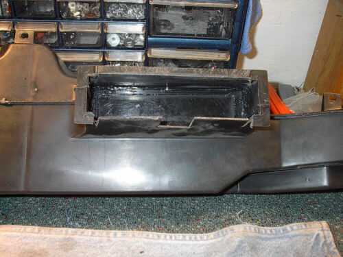

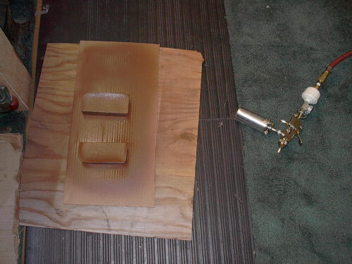

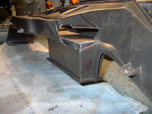

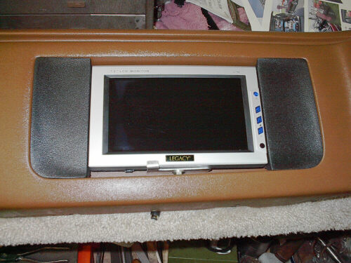

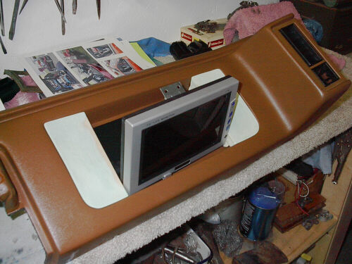

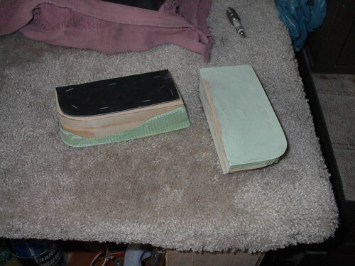

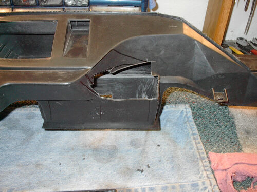

OK.. Here is what I did. The first pics is the set up W/ Boss DVD Player & a 7.2" LCD screen. I didn't like the DVD in the open & the screen looked out-a-sort.
I liked the idea of being able to tilt the bottom of the screen out to make it better for viewing & putting the pocket back over it, looked like nothing was there...
So I moved the player to a better location, I removed the center vents & cut the back of the vent housing out & sealed the hole so it would not get any hot or cold air from the vents. I also cut holes in the back plate so the wires would come out & then I sealed it with peel-no-seal.
After getting the dash back in place I then worked on the screen, I didn't cut the back of the dash out, but I did cut a space in it, to put a hinge that I mounted to the back of the screen through the dash & then riveted it to the dash. This way it is secure & the bottom of the screen can be moved out about 1 1/2" & then put back down to be flush. I then put a piece of stainless steal on the back of the pocket so it can cover the screen. Here are some pics.... I'm not done yet..... I'm going to do more to the screen in the next week... LMK what you think. Yes I did all the work! Thanks, Chris.

Simply awesome Chris. That is one of the nicest installs of anything! Very well done and professional!

Chris, that looks awesome.
You did all that in the last three weeks?
The only question, I know it gets hot in KS, don't you kind of need those center vents? I couldn't live without mine here in TX.

Fantastic install Wheels, very high quality work. I wouldn't want to lose the center vents either, but to each his own. I'm actually working on a new center console right now, and I've had to make some sacrifices in order to keep those vents there. The funny thing is, my AC doesn't even work right now because it needs vacuumed and refilled with 134 again!!

Chris that looks exactly like what i am trying to do. I couldn't figure out exactly how the best way to do it was though. Im using a bumper repair kit to try and mold the cover into the dash, so you can't tell where it is. and i to am trying to think of a way to cover the screen, the best i came up with so far was a "curtain" with a pegasis logo on it. i haven't done that yet, cause i don't think i can, so more info on what you did would be awesome. it looks very nice
No..in the last 2 weeks. I didn't show the pics of my needles on my gauges & lots of other stuff I did. "VENTS" I thought about that a lot... I really didn't want to lose the air flow. But If you completely block it off so that no air moves through, where does it all go?? To the side vent's. If you've got the vents on & your on say 3 (fan speed), you don't feel the side vents at all, it's all blowing in your face. Well with the center sealed off, it ALL goes to the side. When I got done, I drove my car with the A/C & just outside air on..... "WOW" It's like a having a ceiling fan in there... the air now comes around you, not just in front of you. If some one close wants to take a ride LMK..... Here are a few more pics of the install.
Thanks Everyone...
Wood & bondo.. easy to work with & sand to fit.
The hinge that goes through the back. testing the sides (again)
undercoat works good for fake vinyl. Just stay back about 2ft when spraying.
Test again...
Color matched vinyl paint,(yea right! that is one of the things I'm fixing!) sprayed on.
Will continue in a second, PIP says I have to many pics.

Report this Post04-17-2003 07:16 AM Click Here to See the Profile for Wheels1Click Here to visit Wheels1's HomePageSend a Private Message to Wheels1Direct Link to This Post
Wheels1
945 posts
Member since May 2002
Continued..
The back of the vent. I know it looks like hell, but you need the extra space (1") to get behind it W/ wires.
Piece made for the back of the player & vent. Other pics to show angels.
As always if you have any questions , post or send to ME!

Wheels- 1st off that is definitely one of the coolest installs I've seen! It's good to see that so many of us think along the same lines- it's even better to see that people like you just jump in and do it! Excellent job!

DVD Tutorial to follow:
Mobile DVDs are coming down in price but they are still more expensive than a home unit ($122 USD vs $48 USD) Granted you need an inverter, but I already had one laying around and you can use the inverter for other things as well, (charging camcorder batteries, laptop, etc).
The second advantage is once you disassembly the home DVD you have a lot more packaging options. There aren't many places that the larger mobile units will fit without major cutting. On my car I have just the mechanical part in the upper dash and the electrical parts are located in a different part of the dash.
Third advantage is that the home units are a lot more popular so it's easy to find a hack for them. There are forums devoting just to hacking the APEX DVD players.
Regarding the APEX 1100W There are at least three models that were sold in the US alone. An old 512K, 1 MEG, and the new 512K. I have the new 512K and I am having trouble changing the background image. The 1 meg versions were a lot easier to hack. There are reportedly other versions that were sold outside the US. The forums can help to identify which one you have depending on the serial number and the features displayed on the box.
Now when the mobile DVD players come out that are DIN sized and reasonalby priced, that will change everything.
I hope that helps
