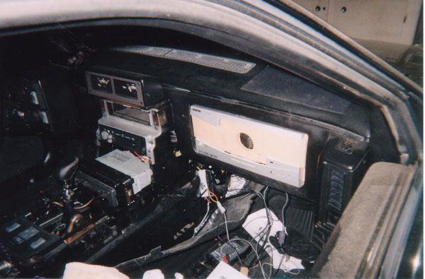

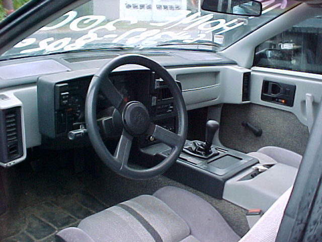

Hi all,
First off, I got this idea from Edbone who had a similar install, and I thought it was a great idea, so I built project "Fiero Vision" incorporating some of my own ideas. The dvd player itself is an Apex 1100w (yes its a home unit) that I disassemble and built into the small confines of the centre console. (Just a reminder for anyone attempting this... there’s not really any room for anything more then some Canadian penny's.)
Here’s the dvd player before.
And here is the after pics
(closed)
(open. P.S. I haven't vacuumed, so all that dust is from the install, better pics to come)
The Apex 1100w playes DVD, VCD, SVCD, MP3, XVCD and Audio CD's. Don't forget that it has a flashable memory to add your favorite fiero screen savor and Fiero Background.

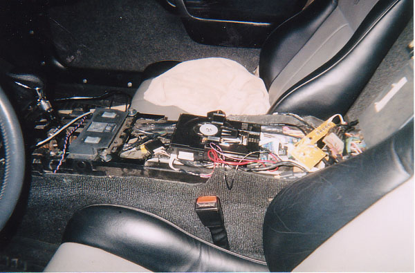

Ok so I left out the LCD screen and the construction photos. They're coming as soon as I get them developed.
Total Cost $129.99+tax Canadian

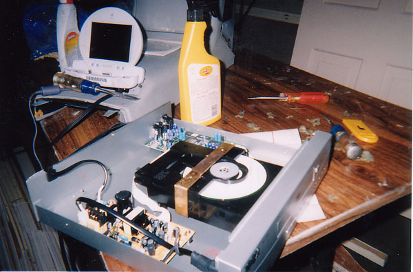

isthiswhereiputausername? - I skipped over the transformer board and made a little circuit to adjust the voltages for the drive to run. Basically it needs similar voltages to your computer +12, +5 ground etc.
But during my test runs I used an ac to dc converter that worked just as well.

Ok I wasn't going to post the pics of the lcd to it was finished (it's in a temporary stat right now) but what the hey. I'll post the final when its done.
And if you wondering how I got that start-up screen I flashed the eprom.

longtermgt - The apex 1100w has internal springs to compensate, plus its mounted on a little kit I made that has 2 strips of soft rubber. I think I've had it skip once while playing an SVCD when I hit a huge pothole in Hamilton. Other then that its in the optimal spot.
Cliff Pennock - the PSONE LCD is a 5inch and it easy to read (including very fine text), I am also able to view the screen from a variety of angles. The only draw back is that LCD's arn't great in direct sunlight, but with window tint it shouldn't be much of a problem.

Ok I wasn't going to post the pics of the lcd to it was finished (its in temporary fit right now) but what the hey. I'll the final pics soon.

More Pictures.
*my cars not normally this messy. I ended up making the wires all nice looking and the circuit boards were mounted properly.
This is how I originally entended to mount the player, but I found it was too flashy.
To flash the firware you need some software, a cd burner and some time. More info at a site call
http://www.nerd-out.com/forum/viewforum.php?f=25
