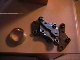

Well I just got off the phone and the inner rings are done, the brackets should be back completed this week is what he was told. And he was going to wait until the second order of rotors came in to start redrilling them but I am going to have him start on them now so we can just get the first half of the orders filled and I will just pay a second set up fee.
As I know more I will post more!

Just got off the phone with the machine shop we should be shipping later this week, the rings are done, the rotors are done and the brackets are getting completed as we speak.
YA were almost there!!!!!

I was going to get a deal on the bolts but the local guy I deal with is going to be gone for a few weeks on a cruise. Lucky ass, anyway I don't think you guys want to wait for his return. The bolts I used for the calipers are M12-1.75 X 55mm socket head cap screws ( caliper to adapter bolts) The adapter to knuckle bolts are M12-1.75 X 25mm socket head cap screws.
I am again going to strongly advise you guys to also use the stainless steel braided brake lines, I am still looking into getting a good price for those. As most of you know the stock brake caliper is used and using a high material brake pad is best and needed.
I am suppling everything else needed: the inner rotor rings, the calp. support bracket, and the 12" redrilled rotors.
