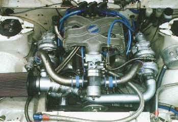

Its possible to achieve 300hp with a 2.8 ..heck some guy had a Datsun 510 with a 2.8 GM swap and it had the stock Fiero type manifold with twin turbos that was putting out in the neighborhood of 500 or 600 HP and it was street driven. It was said to be untouchable in a race.
That is NOT a Fiero intake. That is the S-10 TPI intake and it was modified. The injection system was changed to Direct-Port, the throttle body was 68mm Porsche Turbo model, used an aftermarket injection system, water injection and "O"-ringed heads. On the 510 Forum he states he had 334hp to the wheels once he went to the larger turbos and 3" exhaust and pumped up the boost from 16psi to 20psi.
The engine was built and designed by an expert race engine builder.
NOW tell me again how a 9psi supercharged 2.8L is putting out 300hp????????
Sadly, This past January he passed away due to injuries from a car accident.
Quoted from page 5 of a CarDomain site: http://www.cardomain.com/memberpage/590616/1
"Tom Wyatt "TURBO TOM" Legendary Turbocharging Guru Tom's life was full of all things motorized. His work revolved around designing and building engines for racecars and experimental airplanes. Tom was a consultant, teacher, propulsion expert and adviser for Experimental Aircraft Association chapter 690. He was a specialist in computer-controlled engine management systems, a test pilot for experimental aircraft and engines, and wrote technical articles for enthusiast publications like Kitplanes and Sport Compact Car. He loved flying gliders over the Smokey Moutains and was currently building his own RV-8 experimental aircraft." Tom's mechanical knowledge, experience and expertise enabled me to own one of his creations a 510 Datsun Twin-Turbo v6 He designed and built What a car.
Tom was killed along with his girlfriend, Barbara Creamer in a car accident on January 27, 2005. May They rest in peace."
I had the mag that had the build up and I remember it saying it was putting out 500 to 600 hp depending on boost at one point. He may have detuned it ..Regardless, I said the stock Fiero type intake. Now that may not be the Fiero manifold but its very similar, the only real difference being the throttlebody intake neck being off center to allow for the dizzy. The stock flow rate would be similar between the two. As far as modified, so what if the intake is modded, the Fiero intake can be modded as well. With the many mods done to the 510's 2.8 it only shows that it is possible to get alot of power out of the 2.8 with the right combination. I could build a 2.8 to put out close to if not more than 300hp on 9psi of boost
sad to hear about his demise
334 rwhp ~ 390 at the crank @$$uming 15% driveline loss. That's at 20 psi boost which is 34 psi manifold pressure. 300 is 3/4 the HP and should only take 3/4 the manifold pressure, which is about 25.5 or roughly 10.5 psi boost. Still seem completely outlandish?
Now what do you mean "converted to direct port"? That intake uses EXACTLY the same lower and middle as the Fiero... meaning that it's port injection from the factory. I don't get what you're trying to emphasize here.

Originally posted by Erik:
Is this setup possible to fit in a fiero?
Kohburn
Posts: 7349
From: Oriental, NC
Total ratings: 188
Report this Post04-08-2005 09:59 AM Click Here to See the Profile for KohburnSend a Private Message to KohburnDirect Link to This Post
with some creative plumbing you can put a twin turbo setup in a fiero.. but it'd be for bragging rights more than performance
It does NOT use the factory fuel rail. The Fiero is "Multiport" meaning 3 injectors fire for each cylinder. Direct- port is one injector per cylinder. It has the injectors in the same location, But the injectors are larger and only one fires per cylinder. This make power gains and tuning much easier. As for the intake on the actual car, The entire intake was extrude-honed, polished, and tuned for the twin turbo's. The flow thru it is a lot more than the Fiero intake. If you look at the magazine article on the building of the Datsun, The intake set-up is heavily modified even though it appears stock looking.

It seems to be that most, if not everyone thinks that power and speed = race car (unbeatable)....but it seems that no one concentrates on getting it togther with real performance ie. handing / control. I only think one thing especially if you have a fiero ....why the heck would you buy a mid-engine for....?

2Extreme,
Thanks for sending those pics... I doubted too when I read your claims... but WOW... that represent A LOT of work. I can hardly find the motivation to change the oil, and you've got lambo doors for gosh sake! So let me apologize for being an early skeptic... we get so many talkers around here...
There was one guy PFF busted for posting a faked time slip. V8Fiero400 or something like that... He actually fessed up and was apologetic about the whole thing. Anyway, I am pleased to see your a 'doer' and not a talker. I like your vision for that car.
Couple of things...
1) I really like your hood scoop. It seems to flow very nicely.
2) With weight savings in mind...are you running a stick? What kind of tranny, and what have you done to it?
again, good stuff. I look forward to following your adventures with this ride!

Thanks...there is alot of hard work involved, and mostly all done by me. The trans. is a stock 5spd. with aluminum flywheel and ceramic disc clutch. The front hood vent flows all the air that chanels out from the radiatior (free flow) but some of the sheet metal behind the radiator must be trimmed about 4" to have smooth flow of air out of the hood. The car is currently undergoing a paint job (Fiero Black) and I will soon be driving this car soon, but mostley for track use only.
Correct me if I'm wrong, but that looks like the MPFI intake on the High Output 2.8 L44 V6 Chevy Citation X-11.
It was one year only if I'm not mistaken..... 1985?
May have been used on Citations, but it's also used on S-10's.
Unless you see something on that picture that differentiates it from the S-10 intake...

Correction... LB6 2.8.
I was right about the year though.
Here is a site I'm sure your aware of...
http://www.geocities.com/citation_x11/history.html
Fiero L44 uses the same block (67mm). The cams, pistons, timing chains, and heads are the same. For the FI models, the intake, fuel rail and lower plenum are the same, but the top plenum is different. All of these parts will work in the LH7 or LB6.
Did anyone ever test one of these upper plenums to see if it flowed better than the Fiero upper plenum?
Sorry if this was discussed already, I jumped in here way too late.
[This message has been edited by Skybax (edited 04-13-2005).]

I'd guess that the RWD plenum flow better than the FWD plenum because the TB neck of the RWD setup comes off straight, but the TB neck for the FWD plenum has to jink around the dizzy and compromises flow because of the reduction of cross sectional area.
It should flow better due to the short neck, But the problem would be fitting it on the car. The Fiero plenum has the long angled neck to clear the distributor. The RWD points off the front of the engine. So it doesn't hit the distributor and the thermostat housing isn't the tall one like on the Fiero so you can't reverse it. This is the same problem with using the F-body 3.4L plenum, The distributor is in the way.

Nothing that starting with a DIS shortblock and wiring for DIS wouldn't fix
