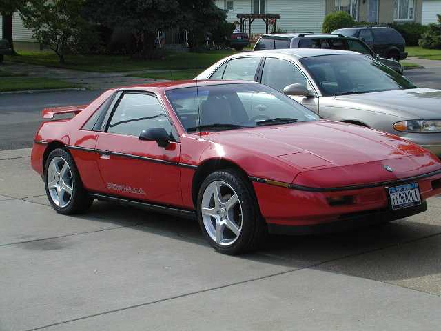

I run 17 X 7 Konig Imagines on my Formula.
The offset is 40. I am running Yokohama ES100's 225/45 - 17 all the way around, lowered 1.5" no problems at all.
I am going to go with 205's on the front when I need new tires and 235's on the rear.

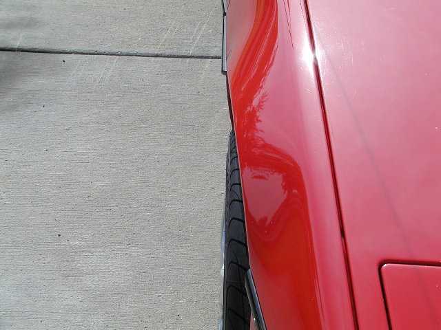

I've got 17x7 Konig Absolutes on mine. 40mm all the way around.
215/45s on the front. 235/45s on the rear.
One thing I noticed is that dropping the front of the car by around 1.5" (one coil ) gives the illusion of tucking the front wheel in, just a bit.
