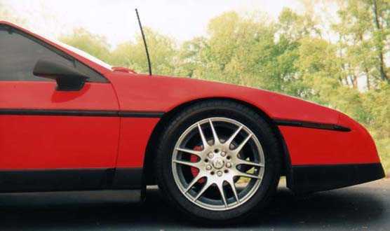

I have American Racing Carrera's:
front is a 16x7" wheel on Falken Ziex 502's
225/50VR16
back is a 17x7.5" wheel on Falken Azenis's
225/45ZR17
Maybe it's because I have a notchback, but if I go any wider in the rear it will rub the seat the strut sits on. Right now, I can barely get a finger in between the tire and strut.As of now I am not lowered at all, That strut "seat" is stationary right? After I lower, it's not gonna drop at all, correct?

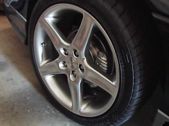

TSW 18"x7"x50mm with Falken GRB FK451 215/40ZR18 on front
TSW 18"x8"x35mm with Falken GRB FK451 245/35ZR18 on the rear

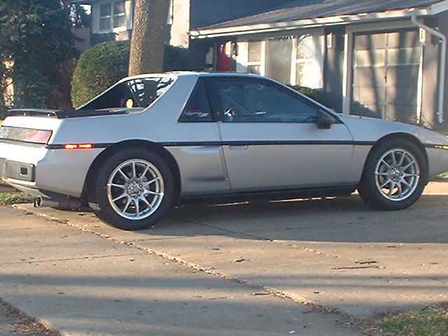

Heres a pic of my Winter wheels.
CAM Racing 16"x7" 40mm offset with 225/50-16 (front & rear) With lowering springs.
