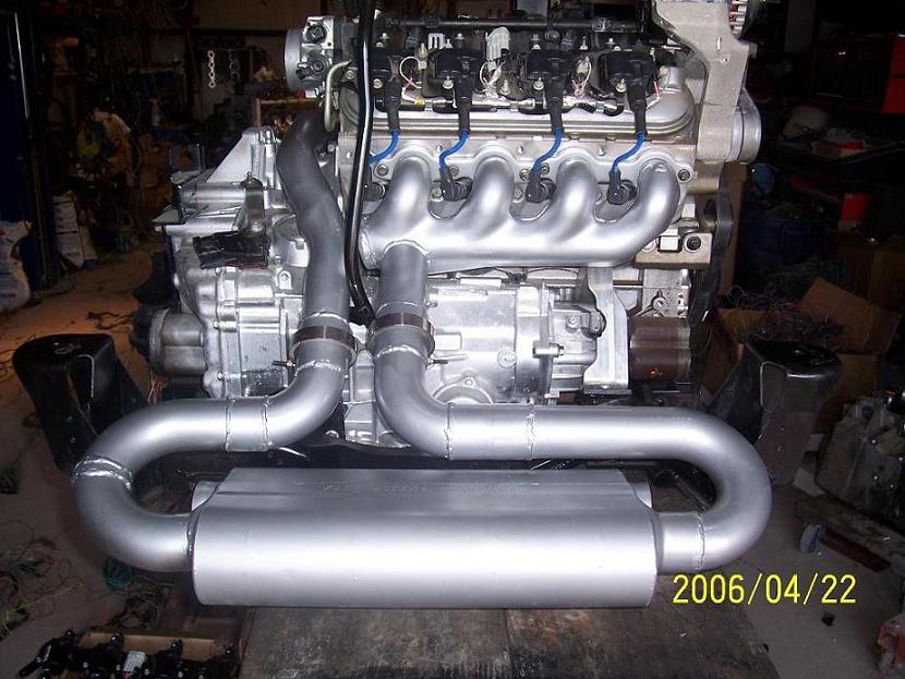

Dammit cant find the thread, but heres a nice exhaust on a Nstar
FastFieros
Posts: 2698
From: Dallas Texas USA
Total ratings: 265
Report this Post03-29-2007 12:03 PM Click Here to See the Profile for FastFierosClick Here to visit FastFieros's HomePageSend a Private Message to FastFierosDirect Link to This Post
I have one of these 355 mufflers. It is very large and heavy. I think it is all stainless steel. I had purchased one for my LS1 setup so it had true duel exhaust.
I ended up using the camaro duel inlet muffler instead.

Originally posted by Deabionni:
Myself, I don't care whether a Ferrari muffler sounds like a Ferrari in a Fiero. The reason I want the Ferrari muffler, is so that is has a nice, mellow tone at idle; and yet can still flow enough air at WOT to keep the N* happy.
You going to install that Ferrari exhaust valve to flip between the idle/WOT muffler paths? Using the single idle muffler path will give you a quiet exhaust, but a restricted flow. The WOT muffler path would be the opposite. Can't have both without that valve.
[This message has been edited by ryan.hess (edited 04-01-2007).]

Originally posted by Sloshua71:
The way to achieve a similar note to a ferrari with an american V8 is to combine the exhaust pipes in a way that puts an evenly spaced pattern of pulses into the headers. To do this you must combine one specific header pipe from one bank with 3 from the other bank. This leads to headers that resemble what is often called a "bundle of snakes"
180 degree headers works...
180 degree crank works...
but for those of us on a more realistic playing field, you can get very close to that ferrari sound just just a few simple mods.... (see above audio clip)
If I can figure it out, I'd hook it up with that valve in place. Using it in that fashion sounds like I'd achieve exactly what I'm looking for.
Do you trust that sound clip? I only ask because an LS1 video that sounded almost exactly like that on torquecentral turned out to be a corsa exhaust on speed-meaning sped up by about 50%.
That said, what would you do to duplicate that sound with a northstar in a transverse install?

I do not agree with the term 180° crank. I would think split throw crank and maybe flat plan. Split throw cranks break, makes for uneven crank load in most applications. I just read a little bit on this V8 crank it is like a 60° V6 crank and I am familiar with it. One application used a twisted cross plane or 90° crank. I am not 100° positive that the 05 + engines are this way.
This leads to different exhaust pulse timing:
American= pulse-pulse-pulsepulse
Ferrari= pulse-pulse-pulse-pulse
The American V8 has a rumbly exhaust note due to the close exhaust pulses producing a strong sound in the middle of the other sounds. The uneven exhaust pulse timing also necessitates a larger collector design on headers leading to a deeper exhaust pitch.
Ferrari V8's have a smooth exhaust pitch due to even exhaust timing. The even timing also allows for smaller collectors on headers causing a slightly higher pitch exhaust note.
Good point. It's the only LS1 I've heard that sounded good, so maybe it is a fluke/artificial clip. But then I'm not really searching out LS1 clips or anything...
Equal length exhaust is a must. That means compensating for the front ->rear crossover pipe with some extra length on the rear manifold. "X" pipe/crossover is a must to equalize the double firing pulse mentioned above (the even-odd-odd-even-odd-even-even-odd...) Short(er) headers, with staggered collector entry points.
