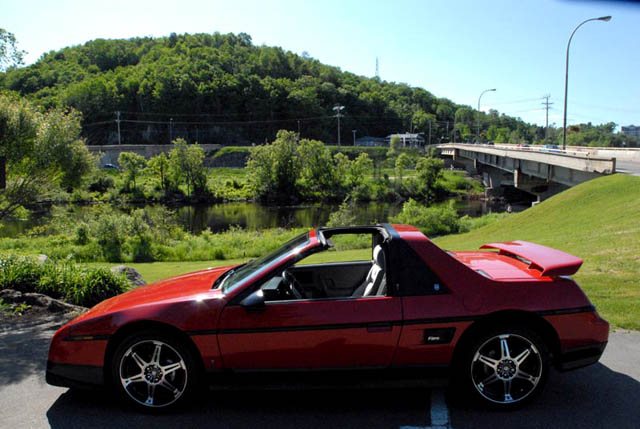

Hi all, the following is a true story, the names have been changed to protect the participants...and why I call it a story? This is not an official "how to" manual, just my impressions and snapshots of chopping off my most prized possession...My Fiero
After 4 months of intensive searching, having to resort to the "Reward system" (which paid off big time) I've finally arrived at acquiring the extremely desired T-Top conversion kit.
I got it from a great Fiero enthusiast in Ohio. (His wife would not let him chop up a perfect 88 GT, so I was the lucky guy to get this kit and I thank both of them a lot)
Another person to bring into the story and thank (a million) is my Fiero buddy/mechanic/mentor who goes by PFF name spookything. He gave up a lot of his time and skills in the making of this project and many more.
As for the decision to buy another T-Top Fiero or the chop mine ?
Both options were considered, and after finding 'the kit' I decided the conversion should not be too hard to accomplish and I keep my good known Fiero, not having to deal with the unknown problems of another 20 year old Fiero.
Some good inspiration came from Houston, Texas where jscott1 and his brother did this conversion in one long weekend http://www.fiero.nl/forum/A...040710-1-029407.html
We did the 10 hour round-trip from Toronto, Canada to pick up the goods. After a quick tour of the seller's Fieros collection and the exchange of funds we headed back home. Crossing the border after midnight has its benefits, we declared full purchase value of the parts we had in the trunk and got to cross without any questions or paying a cent in taxes ...
Some of the parts from the kit i got prepped after sand-blasting and paint

After a couple of prep days (sand-blasting and painting) reading the installation manual 7 times and running virtual mock ups we embarked on the project.
~Custom made frame spreader bars
~ Interior removed
~ Measure 5 times
~ Cut once
~ Rear section cuts
~ Sunroof section removed
~ Targa Top Fiero ...Sexy
~ Some light trimming on the back...
~ And some heavier trimming on the front
Windshield Header Reinf - glued and riveted
Roof Frame Asy Insert
~ Slight modification on the rivet gun to prevent injuries (bad design)
~ Frame glued and riveted... Frame spreader bars come off
~"B" Pillar Bracket
~ "A" Pillar Bracket
~ Front Roof Outer Molding
~ Rear Roof Outer Moldings RH
~ Center Frame
~ Weather seal retainer cut
~ Roof Weatherstrip Seal
~ Silicon on the seams
~ Interior trimming
~ Hard-Top Headliner
~ Fiberglass resin for reinforcement
~ Installed for measurements
~ Headliner fabric installed
~ Headliner Lock Molding
~ "B" Pillar Cap Trim
~ "A" Pillar Cap Trim
~ Glass Panels installed for the first time
~ The Fiero was now drivable again in it's new form
From CHOP to TOP the project took three work days including all steps required and overnight dry time of the glue and paint used.

~ And... The maiden voyage in day time...T-Tops off...Cruising to a Fiero get together in Ontario...Can you see I'm loving it

Weekend camping...Some pics for your T-Top viewing pleasure
Some rare T-Top images (by Miss T)
Posts: 16348
Total ratings: 329
06-16-2007 06:43 PM Click Here to See the Profile for PatrickClick Here to Email PatrickSend a Private Message to PatrickEdit/Delete MessageReply w/QuoteDirect Link to This Post
Originally posted by Mister:
Heh heh, clever shot of the T-Top.

Those last pics are great! The t-tops make the car look so much more exotic and expensive
