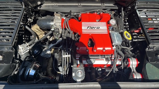

Thanks! Here is another pic of the engine bay.
