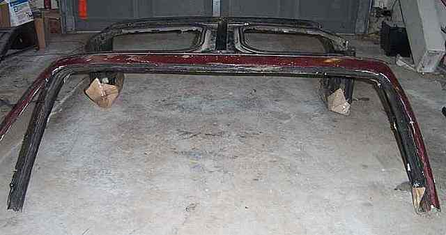

The donor, an entire roof section from an 1987 Med red metallic SE, (non CJB of course). I don't know anything else about the donor because I bought it from JubJub2m6
I had it shipped from Idaho to Houston

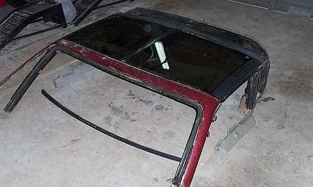

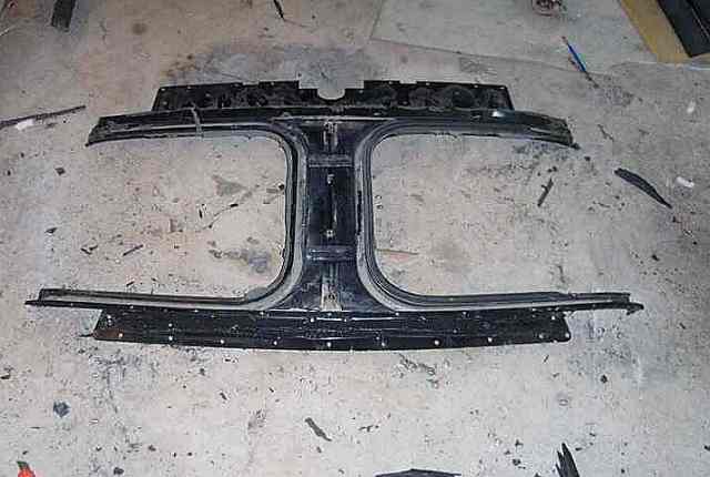

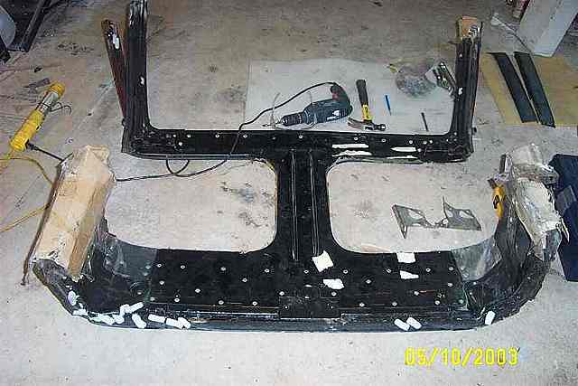

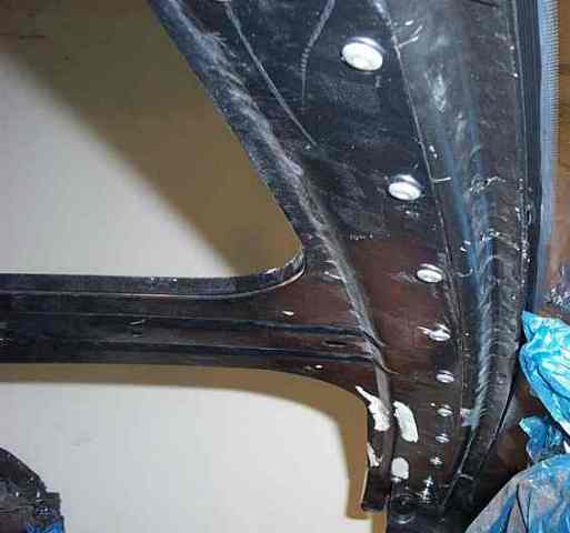

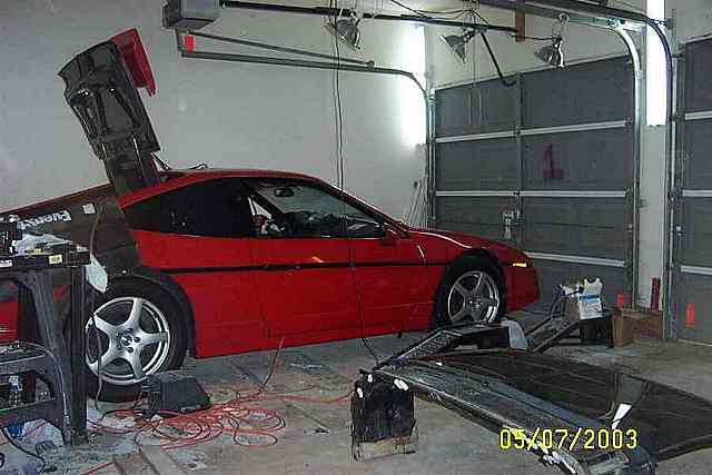

Step one, remove frame from donor car. There are about 50 1/4 " rivets that have to be drilled out. That sounds harder than it really is. You just need a good drill. None of that cordless stuff.
JetroGT

It looks bent.

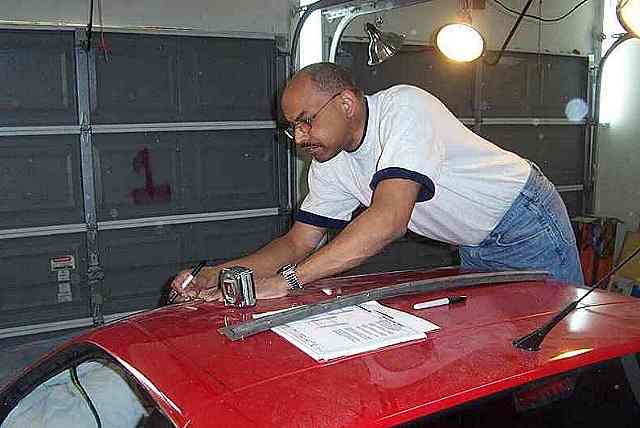

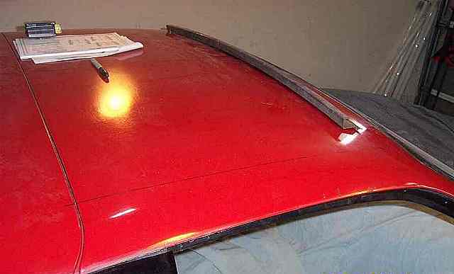

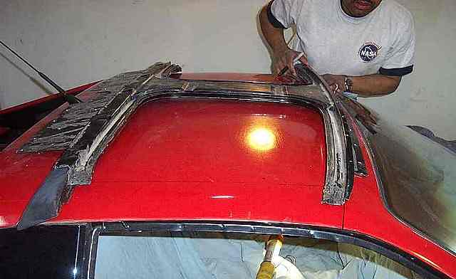

Steps 2 through 10, measure, measure, ...
(added note: yeah the frame was bent...the donor car was hit on the driver's side, it's real flexible once removed and it was bent back into the proper shape)

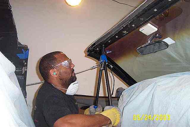

My brother was in town for the weekend, he did all the measuring...
A little reality check with the frame.

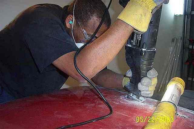

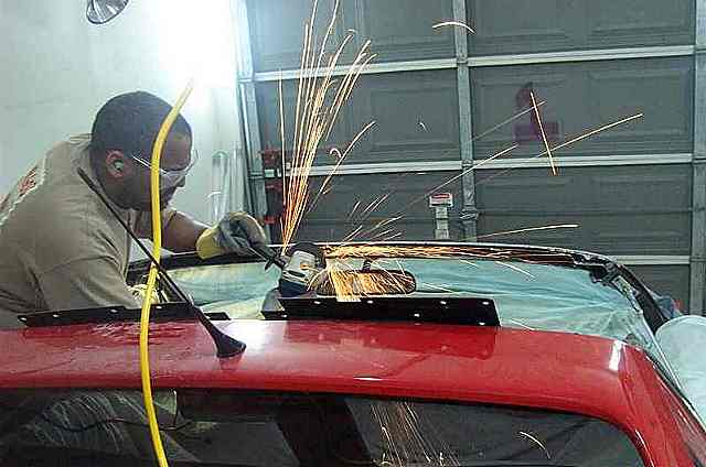

My job was the cutting:
[This message has been edited by jscott1 (edited 05-25-2003).]

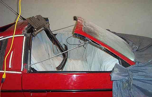

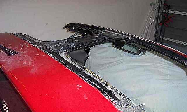

Report this Post05-25-2003 10:58 PM Click Here to See the Profile for jscott1Send a Private Message to jscott1Direct Link to This Post
jscott1
21676 posts
Member since Dec 2001

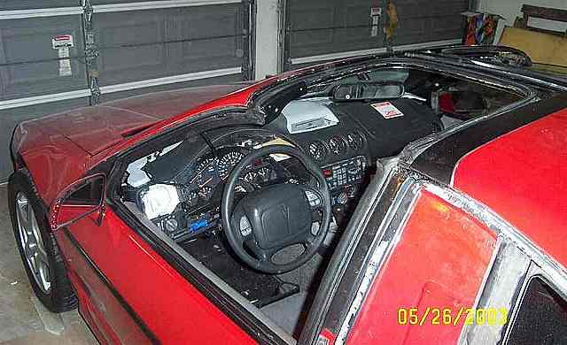

Old roof gone and home made spreaders installed. Boy that Targa looks great, but the frame has to go in there for strength.

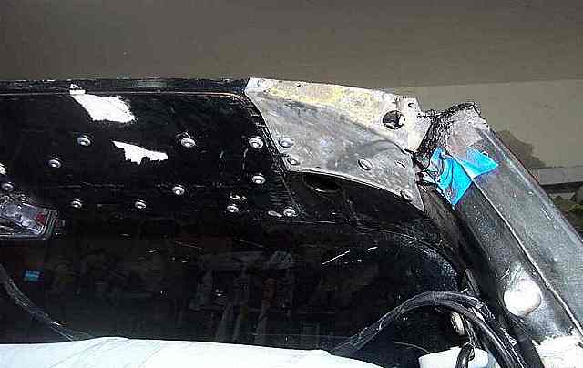

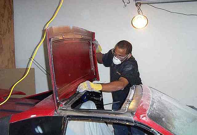

A bunch of rivets to put in:

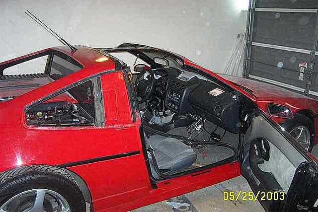

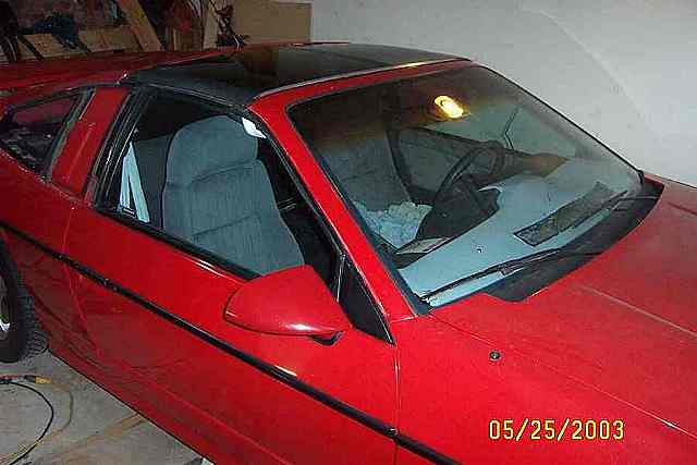

Here's the first look at Proud-2 with the T-tops and the Firebird interior:
All that's left is the trim and the headliner and put the quarter windows back on.

jscott1
21676 posts
First Test Drive
My brother and I loved it!!

My 7 Fieros: as far a PITA you are drilling overhead for the most part so I had hot metal bits falling in my face. ouch. Notice that I had my interior completely covered to protect it, (it would be safer to remove it, but I didn't want to remove it after I spent 6 months putting it in )
Fierotech: I would have loved for you to slice into my car, but my Brother works a lot cheaper than you do
As far as tools, I should mention that I needed a couple of tools that I didn't have such as a 1/4" riveter, and they are not a common tool that you will find at Sears or Home Depot. I had to order it from Harbor Freight.
And I needed an angle grinder. I purposely cut on the inside of the line, so I had to manually grind away a little metal.
The other thing is that although the C&C installation manual is great, some of the drawings are confusing. I would have found it a lot more difficult if I didn't have the donor roof there to compare and take measurements from.

Despite all that work you put into it, you make it look easier than riding a bike, very nice job man..

Thanks for all the good words...
The glue for the weatherseals is still curing, and I have a few loose ends to fill in before I try the leak test. I know that factory T-tops of the Fiero era tend to leak anyway, so I won'd be too upset if I get a drip or two.
I am getting closer to that dream Fiero I always wanted...Red, 88 GT, 5 sp, T-tops, what's next?
RossT, it would have been easier just to buy your car, but not nearly as much fun.

Man do I hate people with Talent, Knowhow and Ambition. Actually, I changed my own wiper blades once.....Without any help!!
Seriously...A FANTASTIC job, and a POSITIVE rating to boot. One question...On a car with a sunroof, do you feel it would make the job any easier?
Thanks

Outstanding work! I wonder how many folks are gonna booger their roofs after watching that install. Man, you made it look easy. Anybody who has the 'nads to take a sawsall to their sweet ride gets a "+".

Looks killer dude. It'll help show off all that hard work on the interior. T-tops rock. I miss mine already! I see another in my future someday!

Thanks again for all the good words, but my brother deserves a big round of applause. He had barely ever seen a Fiero before but he came in and made all the measurements. I had so much confidence in him I didn't bother to double check them, I just cut on the dotted line. It appears my confidence was well placed.
JKFIERO - As for a sunroof car, it would be a little bit more difficult, because you would have to remove all the sunroof hardware before starting. Once you make the first cut, the roof skin comes off and it doesn't matter whether you had a sunroof car or not, all Fieros have the same spaceframe.
If anyone is interesting in buying Skitime's kit, I would be glad to help in providing tips and instructions.
A kit would be a lot easier than getting the parts from 3 different cars. At one point the trim holes weren't lining up and I realized that the trim was from a different car was the reason.
Was it worth it?
YES!!

Look's awesomw like the rest of the 'proud family'... I am full of envy right now.... I am going outside to work on mine..

Hey Jonathan , You and your brother did an outstanding job ! Did you have to re-inforce the under carriage , like they do for Fiero convertables ?
Gave you a + rateing , for the nice layout of pictures ,and your ambition .

That's an excellent piece of work you have there. As some have pointed out above, it takes some guts to cut your car up. Excellent work, you da man.
