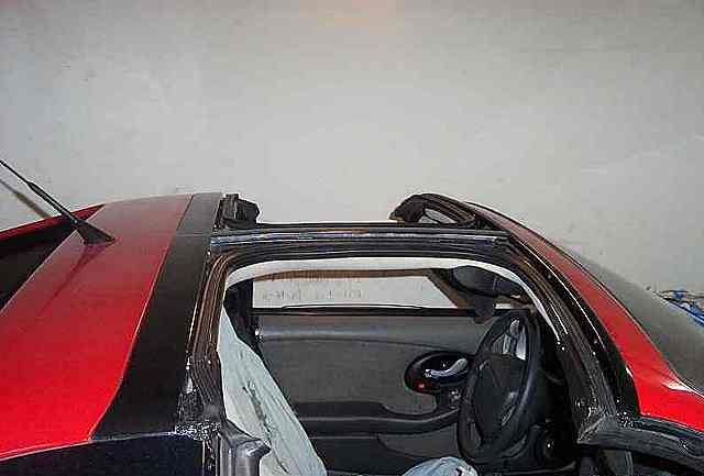

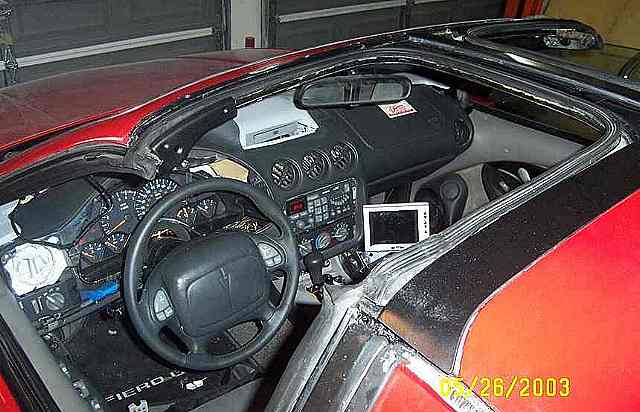

Thanks again for all the good words and encouragement. I purposefully waited until Sunday night to post my weekend results after I knew the outcome. I had to leave town for a few days so let me get caught up and answer some questions...
MrFixit58 - I wasn't sure back in March what I was going to do, but my brother talked me into doing it myself. While he was making the measurements, I created the temporary frame reinforcements or spreaders:
They consist of 3/8" threaded rods into a turn buckle in which I have cut the eye off of the lefthanded side and mounted it in a 1/8" aluminum bracket.
I got conflicting information as to whether or not they were needed, but I think they definitely helped. The windshield seemed pretty flimsy after I made the first cut, and I think the blade would have binded up without the support.
The dash filler is still in work, more sanding and filling is necessary, (typical for a fiberglass piece )
Revin, (and others) - The frame does not need to be reinforced for a T-top car. The "H" frame is riveted in with about 50 1/4" rivets and the car is just as strong afterwards, just ask Chester. I was thinking about him as I was driving those rivets..."if I have to go under a semi I want this car to survive"
As for looking better than Ski, Proud-2 is not quite in that league yet, but I'm working on it. His car is the benchmark for red 88 GTs.
Cruz - Those 1/4" rivets are hard to find. I didn't find them in any stores, I had to order them off the internet. They are mostly used by bodyshops and airplane manufacturers. I have a tube of Black RTV that I have to go fill in all the corners before I attempt a leak test. That's the next step.
MinnGreenGT - I know you will be able to find this thread in the future to help others I couldn't find any decent pictures anywhere of a T-top install to help me so I decided to take a bunch of pics myself. By the way, I actually took over 150 pictures so if someone wants to see some particular detail I probably have it.
edhering - I still have the roof panel. It came off intact as you saw it. It would make a great donor for a solid sunroof or a targa panel. Let me think about selling it, and I'll get back to you.
Here is a closer view of the seals and dash. I will be painting the trim this weekend and triming the headliner next.

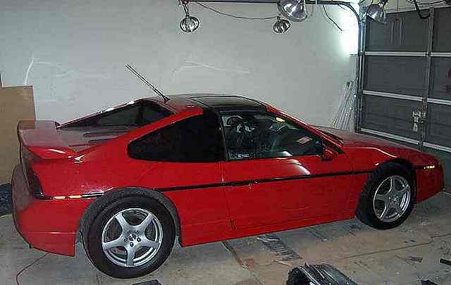

Report this Post06-01-2003 11:47 PM Click Here to See the Profile for jscott1Send a Private Message to jscott1Direct Link to This Post
Makin' a little progress:

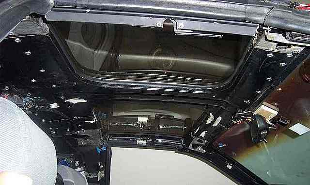

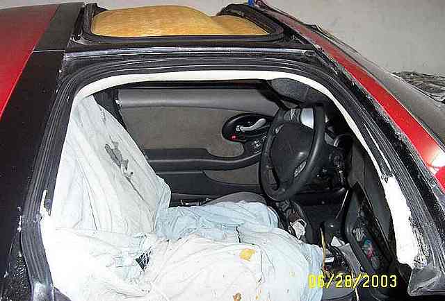

I finally got some garage time to make my new headliner. I often hear people ask where you get a T-top headliner...the answer is that you make it yourself.
Here is what it looks like without the headliner...kind of like something from Terminator-3 with all those rivets
For some reason I thought it would be a good idea to add some rubberized undercoating to the roof...
Then the next step is to reinstall the headliner:
