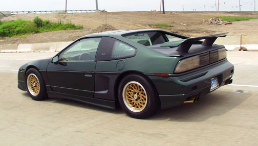

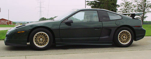

MinnGreenGT
Posts: 11545
From: Lakeville, MN 55044
Total ratings: 274
Report this Post07-22-2003 10:31 AM Click Here to See the Profile for MinnGreenGTClick Here to visit MinnGreenGT's HomePageSend a Private Message to MinnGreenGTEdit/Delete MessageReply w/QuoteDirect Link to This Post
I'm extremely impressed... especially with the rear bumper- every time I look at that pic, it makes me want to go out and get started on a new project!
As for the side skirts... there was/is more discussion here: https://www.fiero.nl/forum/Forum1/HTML/031215.html (I just got mine installed on the car Tuesday night before I left for Michigan... only a touch of blending left to do).

Report this Post07-23-2003 03:16 PM Click Here to See the Profile for MinnGreenGTClick Here to visit MinnGreenGT's HomePageSend a Private Message to MinnGreenGTEdit/Delete MessageReply w/QuoteDirect Link to This Post
I happened to notice the outward angle you mentioned prior to gluing mine up... so I actually removed all but the upper area (approx 1-2" depending on location) of the stock rocker before attaching them.
These are the only "finished" pics I currently have (need to take some with better light).
And they do sit quite notably lower... but amazingly I've never had them rub anywhere either (and my car has been lowered), even when running it hard at Waterford raceway last week!
BTW: I'd love to see your car finished in either of the modern dark metallics you mentioned... very exotic looking
