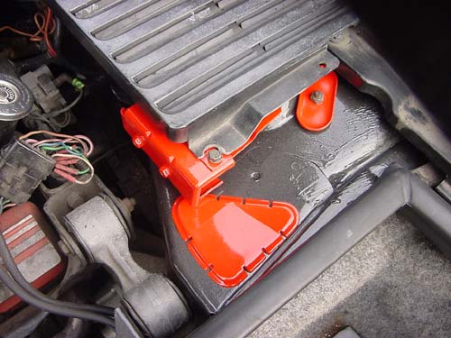

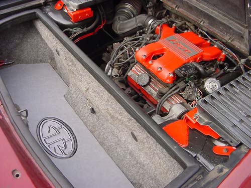

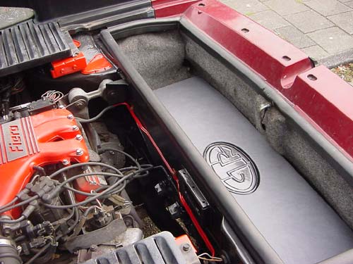

found another related picture:
1st pair is my backup set
second pair: the modified ones which are on my car for years now. (Kolja see I did your mod! )
third pair: the Honda prelude altezza's. Got them prewired now and almost ready to go in the back (finaly after 2 years!)

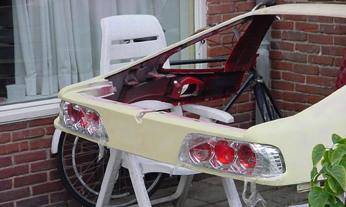

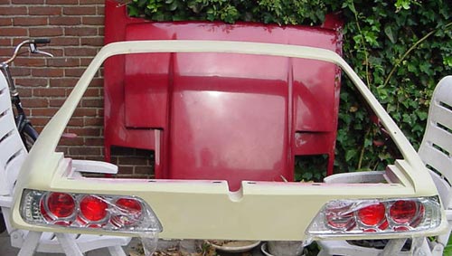

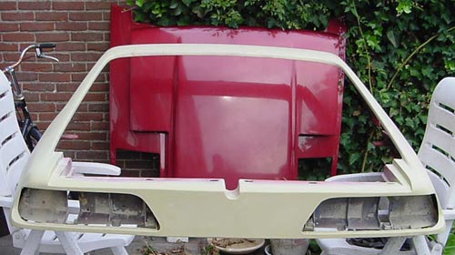

How did you make the rear lower facia addition?

the rear lower facia really is the original mockup.there is a small basic woodenframe which I covered with a kind of foam (L+R side) Then I sculpted the foam to the lines of the bumper. Covered it with some layers of fiberglass (thinner layers towards the original bumper). Then houres of smoothing and sanding. It sounds quite easy but I made many changes during the process...
Well.this was made from scratch!
I have several drawings made but the final product is totally different!
I have some doubts whether these two different materials will hold up. I have made a few repairs and drive the car like normal to see if serious cracks appear. If so I will have to make a mold and a one piece product.
I finally have the right gelcoat and release wax to make a good mold. I already destroyed some small molds due to wrong materials. So It takes some confidence to try that again...
But I better do the job well now, then discovering cracks in my fresh paint later

This is one of the new tips. I couldn't find a (good size) Y pipe so I had to make them myself with a bit of help
this is a GTR logo which I will paint and put in my trunk cover which I already made (pics when finished)

I have got myself a digicam for this weekend and I am using PIP now for the first time (and already like it!)...picture-attack!
the altezza's in the modified rear clip.
the altezza's when hondadriver came by and liked them
another angle

wednesday afternoon I decided to clean up the enginebay. I removed the complete Cruisecontrol assembly as I never use it. pulled out the insulation. Prepared the metal for paint (hammerite black metallic). I took out the vent brackets and the vacuum lines to paint them red. also put the GTR trunkcover in the trunk. These are the results
drove it already that evening. It still is a daily driver

i am freakin impressed.....specially how to modified the rear fastback clip there for the lights. I think we should become business partners so you can mass produce that product, and i'll sell them here in the states, whahahhaa. Again, GREAT work...thumbs up to you

Front has some minor changes now and the Crystal lights came in today! They seemed soooo big to me but when I placed them on the bumper I thought/think I can make them fit in there
