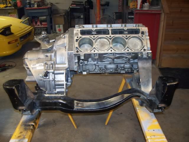

I'm really interested in seeing what areas of the cradle/frame you have reinforced for the extra torque. Any chance of some elaboration or maybe some pics?

To reinforce the cradle we used a 1/4 inch plate on the right side of the cradle going all the way front to back and used it to mount the front engine mount.Then used 1/8 inch plate to connect the open areas on the cradle like the area by the parking brake cables and welded any unwelded spots on the frame and touched up any welds that didn't look strong.In other words we boxed everything in for strength.

Did you reinforce any parts on the car? ie: where the cradle mounts to the chassis in the front or strut towers ect. Thanks for the info.
Can't wait to see this monster run.

Claytonto,I didn't add anything to the strut towers or where it mounts on the firewall.On my Too Far Fiero I pulled a lot of wheelies and it never moved anything there, so I feel there isn't going to be more stress than that.Sometimes welding on things actually weakens it even though you add more iron.

Don I am one step closer to you as of last weekend
but sadly a long way to go
I was able to get the mounts done with my mockup motor...
D.

Hey Dean,looking good.It was good to meet you and your neat car at the Dells.Had a good time talking to you and looking your car over.Everything takes time,don't rush it.It looks like you are using solid mounts and a manual transmisson.That means your CV joints and axles are going to take all the shock,make them strong.Things break when you have a lot of power and no give,just a word to the wise.Thats whey I use poly mounts and an auto transmisson.Good luck and stay in touch,if I can help in any way let me know.

sounds great Don. I am using Archies kit for the install and I will make the axles strong.
by the way the car we had at the Dells was Claytons car with the 383 set up the same way mine is.
I will keep in contact with you.
