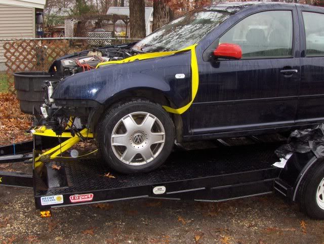

Hi all,
I might be a little premature for this, but I have officially started the physical part of the VR6 engine swap. The last three months were the research portion. What I have found is the pre 1999 manual transmissions have high failure rate. The 24v VR6 from 2003-newer are four times the price to make power with. So, i have settled on a AFP engine from a 2000 VW Jetta with a five speed transmission. These engines aren't cheap. Most wrecking yards want over $2000. for just the engine. I picked up a smashed up Jetta for a little over $2500.00 on ebay....not including $200.00 in gas and tolls to transport it back home.
I do have some concerns that I will address as the swap goes on. I had to wait until we were finished with a 1967 Mercedes 250SL that had been at my shop since March and it finally was done a few days ago. Now I have the extra room needed to do this project. If this project goes well, a TDI swap will be next.
For those of you that don't know what a VR6 is, here is a generic picture of one with the head off.
and here are the teaser pics of the donor car.....
More to come this week.
Dave

The head intake runner is longer on three cylinders, so in the intake manifold, the runners are two different lengths to compensate for that. Check out wikipedia. http://en.wikipedia.org/wiki/Vr6
Also, the engine is initially going in stock to work out the bugs and ensure that I can get it running like a factory car. The only mods are: port and polish and upgraded software. This was actually done on the donor car prior to my purchase. I will tear down and inspect to be sure it was done and done right, but the shop that did it is well known in the New England area for VW mods.
I figure the hardest parts are going to be the fly by wire throttle, axle adaptation (I'm using the VW trans), and shifter.
After this is done, I am starting the turbo VR6 project to go into this car. I want to make sure that it wil work properly in the stock form before I add 300hp.
Dave

I'm not 100% sure, but I think the Jetta is a 5x112. The Beetle and Audi TT are 5x100. I was thinking of trying to adapt Audi TT brakes on my Fiero, but that is later.
Dave

I just looked it up and the Jetta is a 5x100 with the same offset as the Fiero. I may have to see how the rims look on a Fiero....lol
