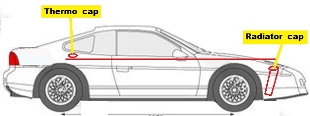

Filling the cooling system on the Fiero is a very exotic/unique experience....Normally on regular cars, you fill it at the radiator cap, and then add a bit to the overflow tank.
The Fiero radiator is very short/low to fit under the low hood, so a large part of the engine/cooling system in the back of the car is above that cap....Here is a diagram- look at the difference in height.....you definitely need to get the trunk lid open so you can properly fill the system.
And don't mind the confusion...most of us are getting older and crotchety-er so we tend to complain if someone doesn't say it exactly the way we would say it....Heck, I'm so old I can't reNember my name most of the time (Sometimes that actually makes me happy)
In his case, with some care and a flexible funnel, he'll be able to fill it without getting into the trunk, as his pictures show, the battery side vent is off, giving access to the cap, as for the confusion, that's what young people are for haha, albeit there aren't as many of us Fiero as a first car young folk now as there was at basically any time in the past, but the few of us that there are have this forum to learn and share information on, and to occasionally remind people what their names are!

First thing you need to do is properly fill the cooling system and we'll take it from there. Filling it from the radiator does nothing more than fill the radiator and perhaps the pipes running under your car.

4. Open the thermostat cap on the engine block and remove the thermostat. While out, start the engine and see if coolant is circulating through the block. Flow should be fairly vigorous. If not, consider replacing your water pump. Some pumps had plastic impellers that when they get hot, deform and slip on the shaft.
I've always wondered about this. If I run the engine without the cap and thermostat, instead of seeing a steady flow, it's more like old faithful. It will be spraying coolant everywhere.

Yes Cliff, you're correct!
Unfortunately, Mike in Sydney has incorrect information:
#4 - incorrect, starting the engine with the thermostat housing open will spray coolant "everywhere".
#5 - incorrect, the ECM is designed with a 195-degree thermostat; many members use a lower radiator fan switch which turns on at 210° than the stock 235° switch.
#6 - incorrect, not a premixed 50/50 as a fully flushed 2.8L coolant system has ~7 quarts of 'water' in the system, pour straight full strength concentrate antifreeze.
Disagree.
#4 - on my V6, when I open the thermostat cap, I see vigorous flow, not a geyser. Perhaps I’m low on water. Not running hot even this summer with the A/C on. I’ll have to top it up and see if I get a geyser.
#5 - I said the stock thermostat is a 195-degree unit. My suggestion is to install a 180-degree ‘stat. That’s what I did.
#6 - 7 quarts? That’s half the volume of the cooling system. when I drain my system after flushing, I open up the drain plugs in the coolant tubes and take the drain plugs out. Doing this, I get most of the water out and start with a relatively empty system.
I think what is trying to be conveyed about number 4 is that if you start the car with the cap off, it will spray, if you start the car with the cap on, then remove it with engine running, it will not spray.

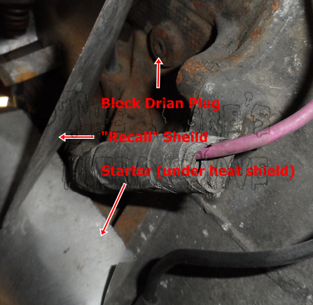

Even if you think that... The block, heater loop & even the Rad holds enough water after Flushing so Never Use 50/50 mix to refill the system.
Even when find & use block drain hole(s) often those won't totally empty the block. Most can't find them or too hard to use them for various reasons so block drains out whatever hose is lowest have more water.
Heater loop have the heater core & more parts that doesn't drain easy if drains @ all. In Fiero the loop can easily "trap" 1/2 gallon or more depending year & engine setup.
Fiero Rad holds More Water then most others when drained because of the angle it's mounted tilted forward.
So will have Weak coolant causing "Rust" ("" because contains Iron rust, AlOx etc.) & more problems using 50/50.
Example: W/ duke Fiero you never get to drain the block because the plug is blocked by other things like exhaust "shield" w/ "Fire" recall done. Even if you can pull it, any coolant is electrically conductive & right over the starter & solenoid. Had to relocate the air cleaner "pipe" just to take this pic...
Purple w/ heat guard tape goes to the solenoid.
I'm not sure you can drain enough more w/ that because right hose is so low. So several reasons why I & most others never bother to try removing that.
So draining what you can, I fit 7-8 quarts of 100% coolant then top of w/ water. If I can't get last couple Q of 100% in main system, then dump last in O-flow tank.
Not my experience... If I remove the cap with the engine running, it will still spray...
