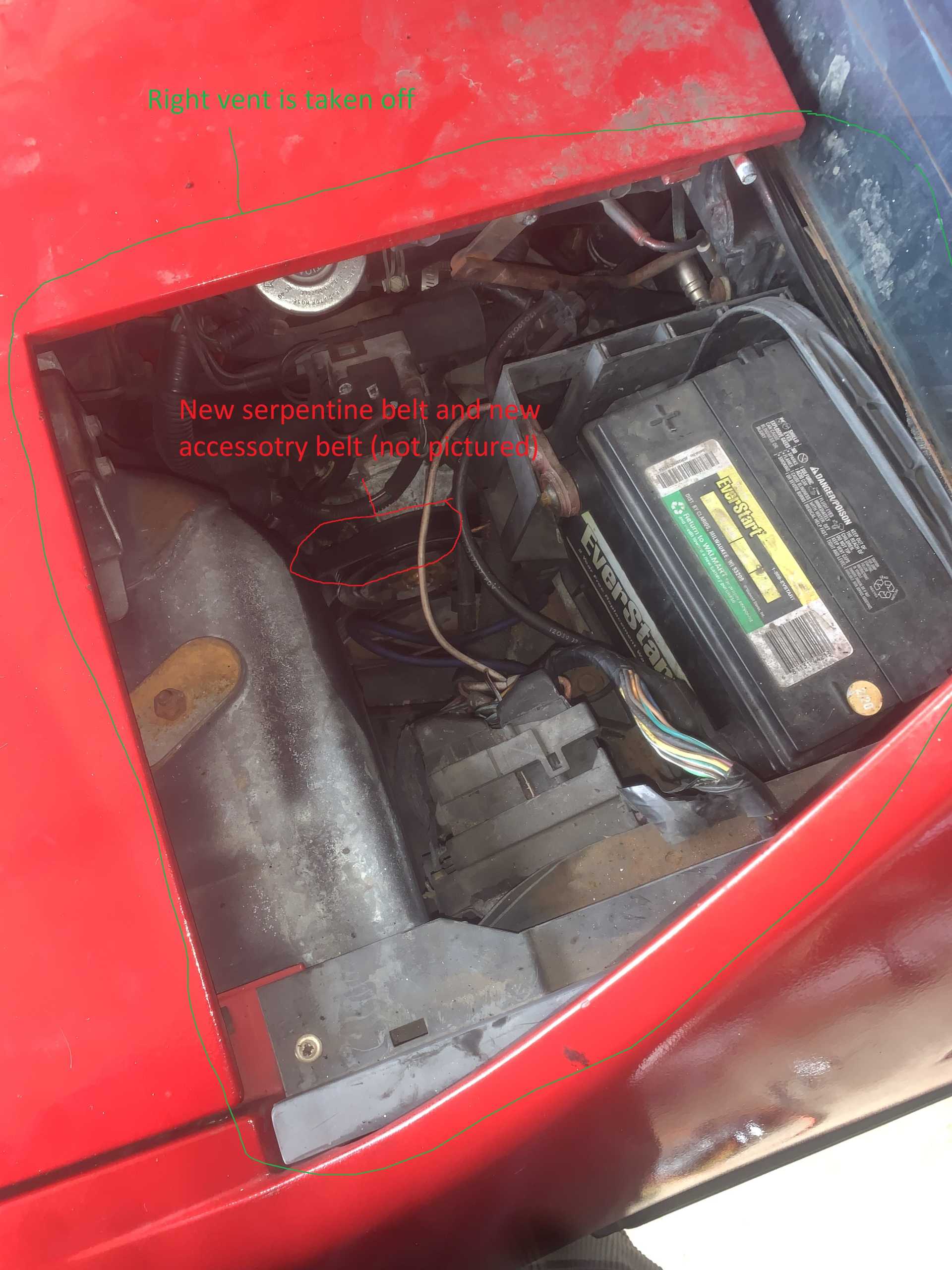

Hello,
My 1985 GT started overheating a few weeks ago when it was sub-zero temperatures outside, and I haven't been able to make it stop since. After running from cold for five to ten minutes, the car reaches around 260 and the dash indicators start popping up. During the several short trips it took to get it home without overheating, I could visibly see it smoking from the vents outside the vehicle. When I finally got to fixing it, I had to put in new belts as both were no longer present in the engine bay. My father and I figured that the radiator could be run from one of the pulleys, but the issue was still persistent. We've tried filling the radiator with more coolant, and turning on the AC does make the radiator spin, but the engine still overheats.
Any thoughts would be greatly appreciated!
- Hamfiero

Cliff Pennock
Administrator
Posts: 11899
Registered: Jan 99
Total ratings: 696
Report this Post02-04-2024 04:57 AM Click Here to See the Profile for Cliff PennockClick Here to visit Cliff Pennock's HomePageSend a Private Message to Cliff PennockEdit/Delete MessageReply w/QuoteDirect Link to This Post
The reason your post is confusing is because the things you describe are simply not possible.
If both belts were missing, the car would not run at all.
At first I thought you meant the water pump, since the radiator isn't anywhere near the engine (they're actually on opposite sides of the car, but then you say
So now I'm wondering if you call the water pump, radiator and radiator fan all a "radiator". That's confusing to say the least. 😊
The water pump is on the engine (and on the outside fortunately), a single belt drives both the water pump and alternator (which is the reason that without it, your car would not be able to run). The radiator is the flat thing in front that cools the coolant, and the fan is, well, the fan.
We are completely in the dark what you did here. If with radiator you mean "water pump", what exactly did you do? Because again, you either put a belt around all three pulleys, or only between water pump/alternator (in which cast the car wouldn't run) or between water pump/engine (in which case it wouldn't run). The only way the car would run (but without cooling) is if you put a belt between engine and alternator.
Smoke coming from the vents isn't a symptom of overheating, it's a symptom of a coolant leak. There are no over-pressure vents in the engine bay. Overheating is a symptom of a coolant leak. So at least we have established you have a coolant leak.
The radiator still didn't spin despite all the belts being present on the engine.
Do you mean the waterpump or the radiator fan? And what's your logic behind the idea the radiator fan would spin once you install the belt?
Unless you mean our assumption, then we were making it based on what we had seen on some cars before. I know the Fiero's a weird car, but it was worth a shot.
True, there are some very old/weird cars that have belt driven radiator fans. But those are all front-engine cars where the engine and radiator are in the same (engine) bay.
I'm not a mechanic. We made a guess and it was wrong. We thought we could fix two birds with one stone, but it only fixed one. I'd really like to drive my car, but no one has even tried to give me a serious response as to why this might be happening to my car.
Actually, you have gotten several serious responses, but we are completely in the dark about what exactly the problem is and what you have done so far to try to fix it. Because again, the things you say you have done are unclear.
My dad was just telling me that he thought it might be the thermostat, but we weren't sure where it was or how to check it.
Not to be condescending or anything, but if you can't find the thermostat on a Fiero, maybe you shouldn't work on the car before you have bought a workshop manual or a haynes manual. If you open the engine bay, the thing is staring you in the face. The thermostat housing is one of the most prominent features on a Fiero engine and the writing on the thermostat cap should have given you a clue that it's part of the coolant system.
Well thanks, but the fiero is from Minnesota and doesn't leak any coolant. We put antifreeze in it when we did fill it up in Tennessee.
Yes it does. If you see smoke coming out from the vents of the engine bay, then you have a coolant leak. Come to think of it, if you hadn't found the thermostat yet, how and where did you fill it with coolant? Overflow bottle? Radiator? Because if you have low coolant, trying to fill the system from those spots without opening the thermostat housing will not work.
So in short, your posts are unclear and filled with contradictions (which is probably the reason why some people here react the way they do because, well, they have low tolerance and not a lot of patience). Don't confuse that with a lack of willingness to help. We all want to help you but if you ask questions, please do not just simply dismiss our answers because you think it must be something else. You describe problems that aren't problems (like the radiator fan not running all the time), situations that are not possible (the car running without any belts installed) and fixes that are strange to say the least and use a single term to describe three different parts of the coolant system.
So in order for us to help you, please start by making a photo of your engine and the "fixes" you have done so far and post it here.
Alright, can do. I haven't done any fixes for this particular problem as I'm still trying to figure out why my trunk won't open. For the trunk, I've tried doing a "hotwire" method which worked initially but not anymore. For the overheating, I've just put the belts back on. Wasn't a fix, just a hope. Here is a link to the video I watched that gave me the "hotwire" ing method: Unlock Pontiac Fiero trunk without keys. 1984 SE | Tom Jackson. I've also attached some labeled photos to hopefully help you all understand my situation better.
Trunk release relay that sparks:
Lack of trunk key mechanism and broken brake light cover and diffuser:
New belts and taken off vent:
Thanks for the response! It has helped me dearly. And again, I'm sorry for being confusing.

Very much so, in your picture of the battery vent cover, you can see the thermostat cap, nice and shiny, that is where you need to fill up your coolant, the Fiero has 3 high spots joined by tubes underneath the car, the engine, radiator, and passenger heater, that is why you need to fill out from the engine with the nose Ponting downhill, as the engine is the highest point, and just filling the radiator will literally just fill the radiator, simply refilling it properly will likely fully solve your problem. If not, or if more new leaks are discovered, that's what we're for!

cvxjet
Posts: 3934
From: ca, usa
Registered: May 2010
Report this Post02-05-2024 01:31 AM Click Here to See the Profile for cvxjetSend a Private Message to cvxjetEdit/Delete MessageReply w/QuoteDirect Link to This Post
Filling the cooling system on the Fiero is a very exotic/unique experience....Normally on regular cars, you fill it at the radiator cap, and then add a bit to the overflow tank.
The Fiero radiator is very short/low to fit under the low hood, so a large part of the engine/cooling system in the back of the car is above that cap....Here is a diagram- look at the difference in height.....you definitely need to get the trunk lid open so you can properly fill the system.
And don't mind the confusion...most of us are getting older and crotchety-er so we tend to complain if someone doesn't say it exactly the way we would say it....Heck, I'm so old I can't reNember my name most of the time (Sometimes that actually makes me happy)
