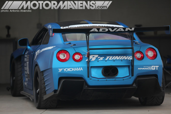

http://www.motormavens.com/...G_7546%20672copy.jpg
To me, thats a SWEET exhaust design that would work great looks wise on the Fiero, have it come out where u stick the licence plate. (My license plate would then go in between the rear tail lights, i have 91 rx7 fc3s tail lights in my Fiero with a custom panel in the middle. So it would fit np.)
However today I was told by my mechanic they could do it...but they would have to cut into the trunk area to get the exhaust tips to come out where the license plate goes....ugh....i havnt had my car in like 6 months so i forgot about that...he said he could go under it and have the tips come directly under the licence plate...but i dont know...So i gotta figure that out. I really wanted the tips to come out in the middle of the license plate spot but...i dont wanna cut into the trunk. So i may have no choice.
Other than that, things are progressing very nicely and they are hoping to start dynoing next week!
