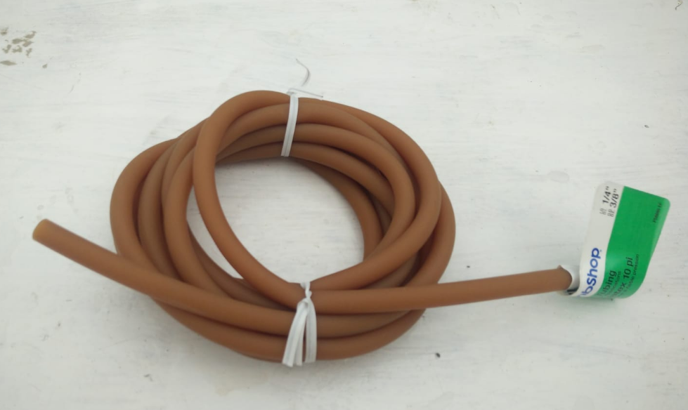

i bot this gum rubber tubing - surgical tubing - from Canadian Tire. Gonna try it on Freya's door rods to fight rattles and clangs. The tubing is real soft and bouncy - should absorb vibration very well.

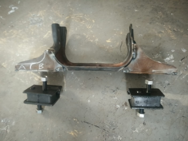

Ol Betsy being loaded on the trailer:
The lady that sold me the motor from Ol Betsy has a friend that makes these:
So i am having these made:
free online picture upload
Mine will say "Fiero GTP" but of course not until that 3800SC motor is in and running.

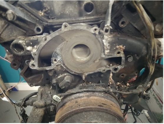

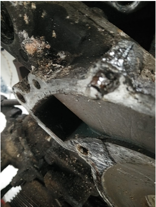

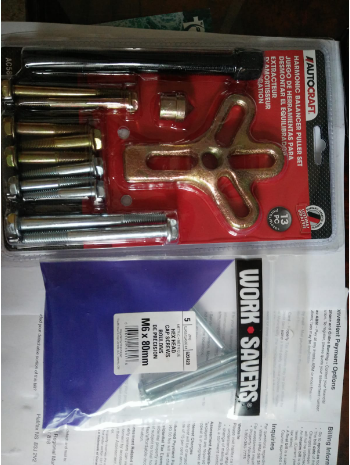

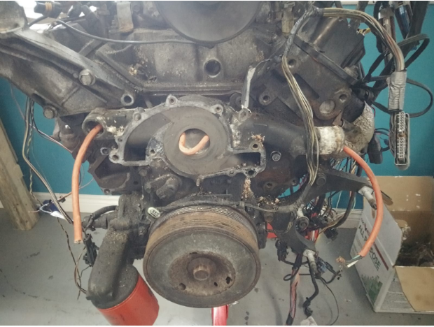

Well i got the water pump off my motor - and i found the first bolts to break so far on this job. Two 1/4" bolts (out of four). Should not have gotten in a hurry and should have used penetrating oil. Live and learn.
Youtube taught me about a 50/50 mixture of ATF and acetone. i learned that the acetone chemically changes the FeO into FeC which is a brittle molecule and allows the bond to break - not the bolt! Again, live and learn.
Now i get to learn about welding a nut on, also on Youtube.
But i am left with this:
i thot by taking off the water pump i would be next to the block, but no! i guess the inside of the water pump is aluminum, bolted to the block. i would like to replace all gaskets but i am faced with the prospect of removing more stuff. ugh
Anybody know of a tutorial on this?
thanks in advance

Report this Post04-01-2020 07:31 AM Click Here to See the Profile for longjonsilverClick Here to visit longjonsilver's HomePageSend a Private Message to longjonsilverEdit/Delete MessageReply w/QuoteDirect Link to This Post
longjonsilver
1113 posts
Member since Nov 2001
Posting this for my memory. Both holes on the water pump base are intakes - one from the radiator and one from the heater core. In other words they are returns from the radiator and heater core.
Note the orange cord. The outlets from the water pump are not where the orange cord is - they are on the side. Just wanna plumb my car right. Wanna have HOT water going to the heater core.

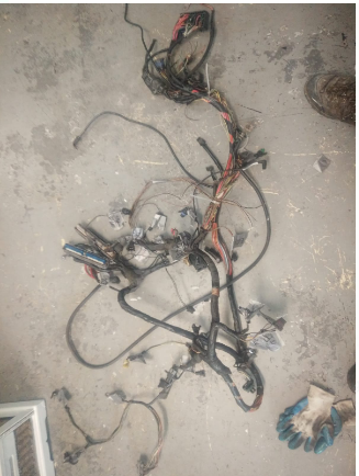

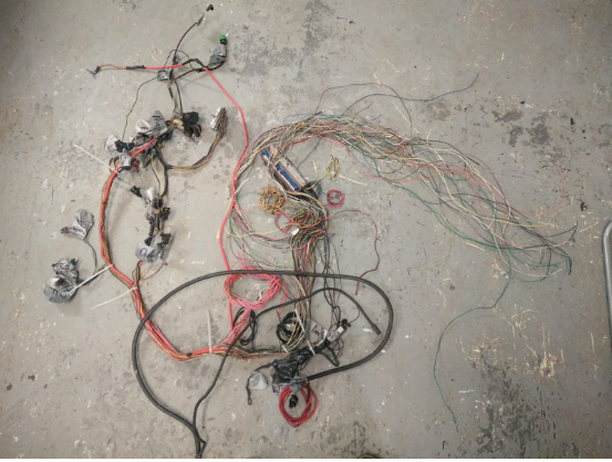

The obligatory shot of my wiring harness. Looks like spaghetti. Gonna take off the parts that i don't need, but i have decided that it would remain a stock motor - all sensors, the supercharger pulley and the exhaust manifolds. Gotta redo the loom as the one i have is a crispy critter in most places.

If you're lucky, the actual wires inside will still be OK.
Here is a recent discussion regarding the best materials to use for re-looming a harness:
https://www.fiero.nl/forum/Forum2/HTML/143417.html
There was also another discussion about the best (but not the cheapest) heat-reflective tape to use. I suggested the use of "DEI Cool Tape". I can't find that one though.

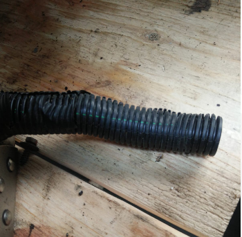

Part of my loom had this green stripe on it - kinda hard to see in the pic. i did the best i could.
Is that nylon loom?

If it came from an engine harness of a car, it's probably nylon. Have you tried the float test? Cut off a small piece, and see if it floats or sinks in water. Nylon will sink (provided it doesn't have air bubbles clinging to it), while polyethylene will float.
I don't know what the green stripe means.
You can get rolls of nylon split loom from Amazon, but it's not cheap. I needed a fair amount in one size, so for that particular diameter, I did an Amazon order.
For the rest though, I walked row-by-row through Kenny-U-Pull to pull engine bay split loom in a variety of diameters/lengths. Ideally, you should go into the junkyard with an approximate idea of what you need to complete your project. Loom at Kenny-U-Pull is dirt cheap.
While at the junkyard, bend the loom tight to see if the plastic is brittle and cracks.
Once at home, to take off the filth from junkyard loom (I use this on many parts in general, but be careful with aluminium), I use the blue Easy-Off oven cleaner can.

Report this Post04-19-2020 07:36 AM Click Here to See the Profile for longjonsilverClick Here to visit longjonsilver's HomePageSend a Private Message to longjonsilverEdit/Delete MessageReply w/QuoteDirect Link to This Post
Due to some guy's help on facebook
https://www.facebook.com/gr...=group_comment_reply
and youtube
https://www.youtube.com/watch?v=1Q8EnwNlxgI
i realize that i have to remove the crank pulley (also known as the harmonic balancer) to remove the timing chain cover to replace the gasket, cuz there is a lot of oil at the front of my motor. But to do this i have to remove the bolt. i have been soaking the crank pulley with penetrating oil for a week now, and my 1/2" Makita impact won't budge it. My buddy (Bloozeberry) warns me not to try to use a breaker bar due to the possibility of breaking the bolt, but rather use a bigger impact. The local rental place wants $35 a day for an electric impact wrench. Ouch Princess Auto has a 3/4" pneumatic impact for only $39 canuckbucks, plus HST for a $46 out the door special. i'm gonna spring for it unless my impact does the job today.

Well, i'm gonna try a cuppla things before i spring for an impact wrench. i have till Apr 30 to buy at that price, and i guess i can always order online for delivery if the local store is out. i'm getting up a shopping list for my engine - gaskets, coils, waterpump, timing chain. i notice that things are a lot cheaper at Autozone in the states than at Napa here in NS - even doing the math for the US$ conversion. Plus we will be going thru two states that have no sales tax - (on our way to a wedding) No tax at the border, so its really better to buy in the states. Autozone is my favorite parts store by the way. i will be able to send my shopping list to NHampshire and they will have it ready for me when i arrive. i do wonder tho, why the fuel injector rebuild kits aren't available there any longer. Its not like no one has these L67 engines anymore.
i guess another thing is that the alternator is seized up on the 3800 - and so i either have to fix it - will a bearing kit fix it? Dunno until i tear it down. If i use Freyaz Duke alternator, i will have to change the pulley. So many decisions - i'm sure that youtube will have a video on how to change pulleys.

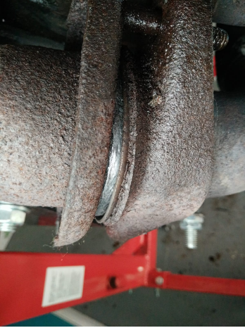

Report this Post04-25-2020 06:50 PM Click Here to See the Profile for longjonsilverClick Here to visit longjonsilver's HomePageSend a Private Message to longjonsilverEdit/Delete MessageReply w/QuoteDirect Link to This Post
Look what came out all covered in ATF and acetone:
Gives me enuf confidence to (maybe) remove my exhaust bolts. Been soaking them in ATF and acetone everyday for weeks now. Used a 1/2" socket 1/2" drive, rachet at half mast, and i removed 2 bolts. More ATF and acetone and 10 more to go.

Yup, crankshaft bolt! No, i didn't buy the impact at Princess Auto, the sale was on till Apr 30 so i just poured ATF and acetone into it several times a day and used my 1/2" Makita several times a day to rattle it around. Then i prayed, and just after praying it started to actually turn, then zipped out. i am beginning to believe what a guy on Youtube said that the C in the acetone displaced the O in the rust and created ferric carbonate - a brittle substance. Maybe next week i will see if some of the other bolts will turn on the exhaust manifold. i began to think about what you were saying and since i plan to buy a gasket kit from ZZP that includes the manifold gaskets, if i am careful and work slowly (i was in a hurry to remove the rest of the tailpipe from the manifold and now i have to pay the price and drill them out.
N, digging around on the web i learned about Alum - available at Bulk Barn. Alum will destroy steel, but leave the aluminum alone.
Alum in the form of potassium aluminium sulphate or ammonium aluminium sulfate in a concentrated bath of hot water is regularly used by jewelers and machinists to dissolve hardened steel drill bits that have broken off in items made of aluminum, copper, brass, gold (any karat) and silver (both sterling and fine). This is because alum does not react chemically to any significant degree with any of these metals, but will corrode steel. When heat is applied to an alum mixture holding a piece of work that has a drill bit stuck in it, if the lost bit is small enough, it can sometimes be dissolved / removed within hours.

i have some bolts stuck in my supercharger - the ones that hold the accessory rack on - which are not thru the supercharger into the intake manifold, but rather end in the supercharger, so i can remove the supercharger (soaking those bolts everyday too) and deal with the stuck bolts. Their heads rounded off - i am not happy with the quality of many fasteners on the 3800 and have found that some of them round off cuz they are best fit with an SAE socket rather than a metric - that's why i say that there is a mix of fasteners on the motor. Thats why i am using a 1/2" socket on the exhaust manifold bolts - just fits better than 13mm. Now i know why Canadian Tire oftentimes includes both in their sets.

Report this Post04-26-2020 02:41 PM Click Here to See the Profile for longjonsilverClick Here to visit longjonsilver's HomePageSend a Private Message to longjonsilverEdit/Delete MessageReply w/QuoteDirect Link to This Post
longjonsilver
1113 posts
i have taken out three of the studs along with only one of the nuts. 4 down 8 to go. No breakage so far. The nuts are stuck on the studs, buy new studs and nuts?

This is what made me decide to remove the exhaust manifolds. i now have gotten 10 of the twelve nuts/studs off the exhaust manifold. Soaking the others some more. i put the studs with the nuts into the ATF acetone mix to soak overnite. (or a week or a month...)

Bot this at Princess auto:
Only $15 canuckbucks and some 6mmx1x80mm bolts. We shall see if they are long enuf or whether i should look for 90mm bolts.
Whacha think?

My idea for a motor mount. The left side might (will) hit the drive shaft so i might (will) have to cut at line A or B. Dunno which rite now. Any idears?
i am using the Dodge 1979 truck with the 318 V8 motor mounts. Only $10 canuckbucks each. Such a deal.
