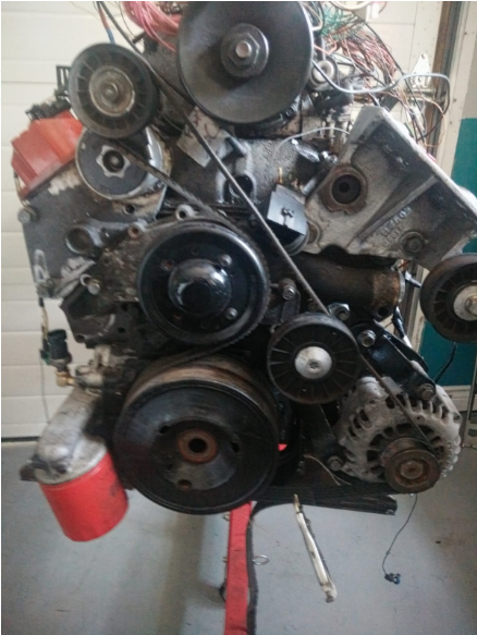

Bracket for accessory belt tensioner complete but rough, grinding and painting to come. Still the belt lines up very well.
That means that the belts are done, now on to wiring.

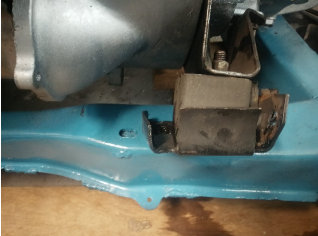

i'm trying to mount my engine on the cradle for a test fit and my motor mounts are too far forward on the cradle.
When i braced the forward tranny mount, as often discussed, i put the bolts on the drivers side holes. Maybe i should have put the bolts on the passenger side holes as this would have shifted my motor rearward. Any thots?
Would moving the tranny bolts to the passenger side holes cause a problem?
No they are not too far forward, they are in the correct spot. i need to modify my motor mounts to fit.
Yep, now the engine is too far back in the compartment and i will have trouble with the exhaust. Plenty of room in front to clear the hinges. Gonna move the engine 3cm forward and mount the forward motor mount on top of the cradle.
Would moving the tranny bolts to the passenger side holes cause a problem?Yep, see above.

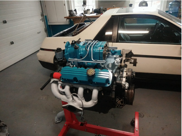

Getting my motor painted.

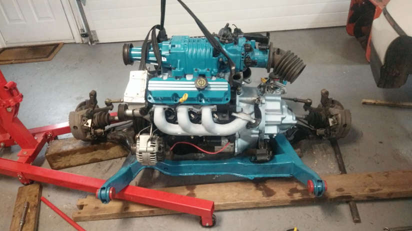

On the cradle. Gonna put it in for a test run to see if stuff fits...

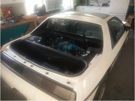

And its in...(sortof)
Engine is nice and low - bottom of oil pan is flush with bottom of cradle, but engine sits crooked in compartment.

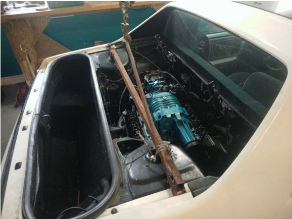

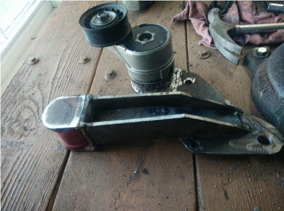

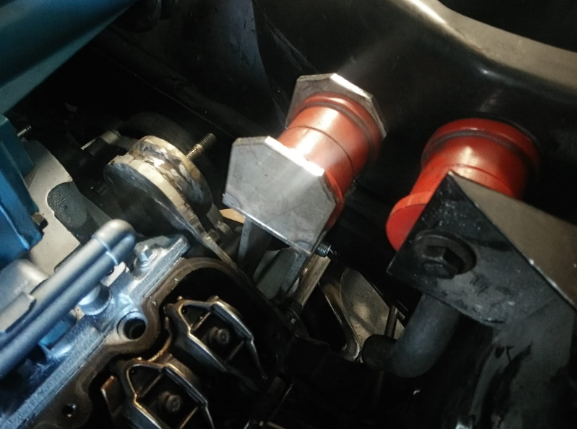

And some detail pics:
The SC roller with the ICM cut off.
The tensioner for the accessory belt, with the dogbone mount, tacked up till final fitting....
N the dogbone bracket in place - looks low, i could raise it up 1cm.

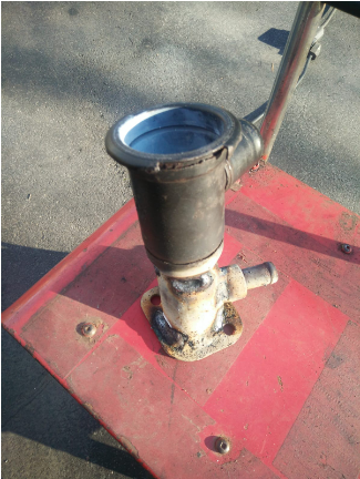

The coolant fill from a duke - this is the second iteration - the first one was too tall. i might have to modify this one as well.....

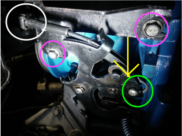

Fuel lines hooked up to filter and fuel rail. The fuel injectors have been cleaned, new filters and o rings installed, but one washer on bottom broke....
Throttle adaption. The pink are slotted holes to allow bracket to slide to the right 5mm. The yellow arrow is where i widened the slot to allow the lead of the cable to fit inside. The green is where i slid a bolt thru to hook the ring from the cable. The white is where i modified the 84 cable to fit in the 3800 slot.
While some of you might do this job in no time, for me this was a good day's work. i also found the other bolts and nuts from the fuel rail, they were lost in my parts bin...

Originally posted by longjonsilver:
While I have seen this done a lot, it is a really bad idea to have a hose barb fuel connection(s) located a few inches above an exhaust manifold, especially when the fuel pressure is going to be 50+ psi. You might want to rethink the placement of the fuel system components.
longjonsilver
Posts: 1114
From: Lower Sackville, Nova Scotia
Registered: Nov 2001
Report this Post12-22-2020 05:25 PM Click Here to See the Profile for longjonsilverClick Here to visit longjonsilver's HomePageSend a Private Message to longjonsilverEdit/Delete MessageReply w/QuoteDirect Link to This Post
Any ideas how?
