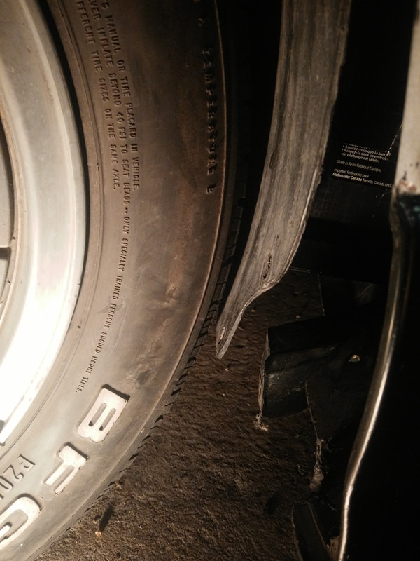

Unfortunately, the battery box protruded into the wheel well. i didn't want a bump on my wheel well so, i shortened the front of my battery box 1/2" so that by raising the front it would rock the rear forward. Seems to have worked. i made the special filler pieces for the wheel well our of some unknown cars air dam and now it is all buttoned up nice and tite. In addition, the new tires clear really well. Lotsa room. However, Freya's battery would no longer start her, so i transfered the battery from my S10 to Freya, but now i have no battery for my S10. What to do? i thot that maybe the Freya's old battery might start my S10 with its shorter battery cables. Sho nuf started rite up. Now both start This tells me that i need to rethink my cables leading from my starter to my battery. Seems good enuf for now, but when i get involved in my swap i'll want to do something else. Something better. Maybe welding cables like others have used.

Took my car on the highway for the first time since installing the battery under the right headlight. Seems to make a difference at speed. Installation looks a lot cleaner in the front compartment as well. And if i ever need my spare tire.....
