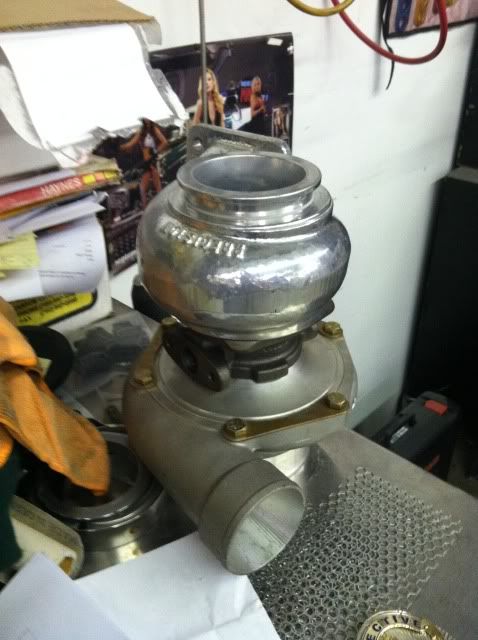

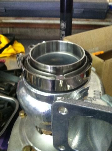

Originally posted by nosrac:
Is your Turbo a T4 or T3? Also what is your .AR? You also have a manual trans which is a totally different animal than a Auto.
Your heads were ported by someone who did 3800 heads before and my heads were gasket matched on exhaust and hogged out on the intake.
I also have the MLS gaskets which lowered my compression and ultimately my low end TQ.
My turbo is a Precision Turbo T67 w/ the ball bearing CHRA upgrade. IIRC is a .68AR on the hot side. Its also fully ported and coated.
Ball Bearing + .68AR > spool than my Journal Bearing + .84AR from a dig.
The few runs I tested it on the highway it was pretty responsive but it IS a slow turn from a dig.
I still have DH anti-lag trick if the 3K converters doesn't work as expected. I wish I got a chance to test it before the HG started leaking.
I really want to keep the stock converter but I NEED to be able to create positive boost off the line.
[This message has been edited by nosrac (edited 10-20-2012).]

Jncomutt
Posts: 8916
From: Charlotte, NC
Total ratings: 221
Report this Post10-20-2012 03:34 PM Click Here to See the Profile for JncomuttSend a Private Message to JncomuttEdit/Delete MessageReply w/QuoteDirect Link to This Post
I don't consider that big on the hot side. That thing will be much more efficient than my MPT70.
