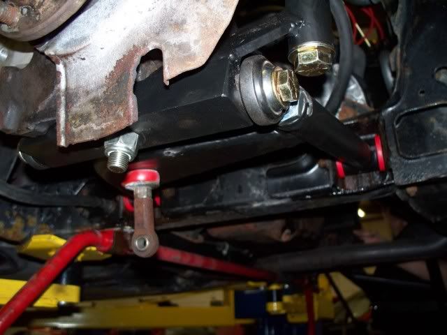

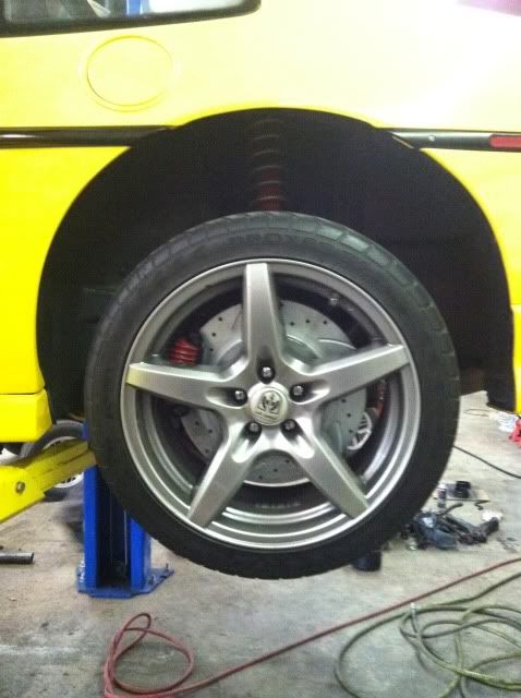

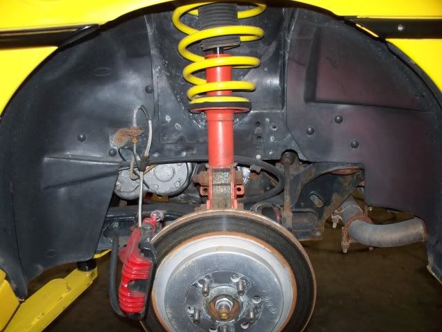

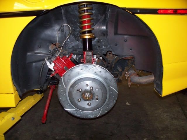

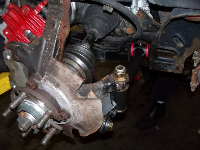

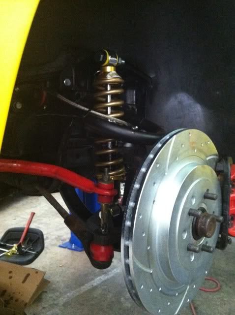

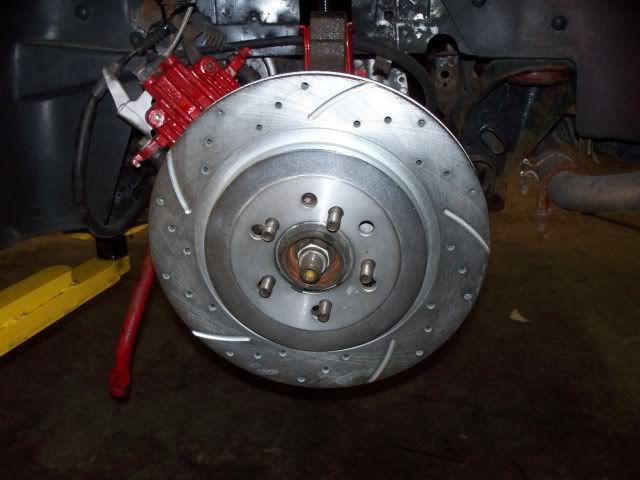

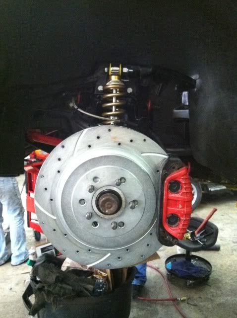

so all of the LED's have been installed on the inside of the car as well as the new markers. now on to the suspension
we started on the rear the other day adding the new arms, coilovers and brakes
before...
in progress .......
and Done ...............
now to finish up the other side and move to the front coilovers
D.
more to come soon
D.

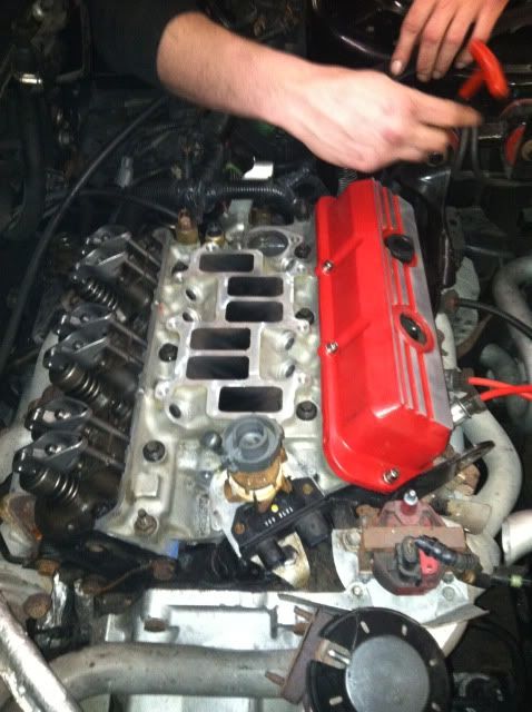

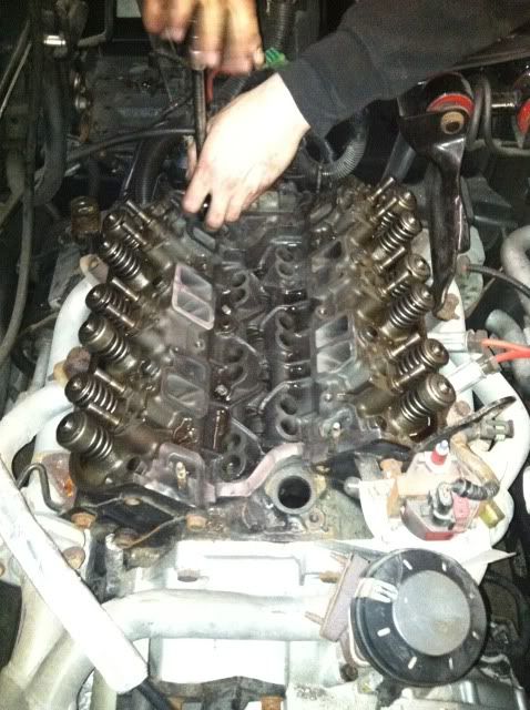

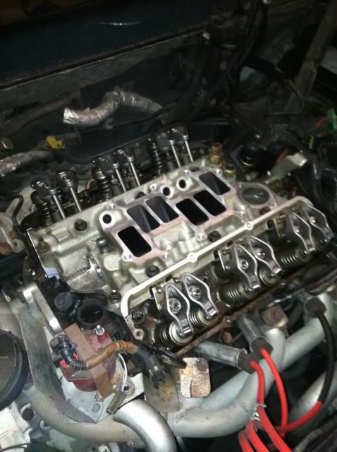

Progress!

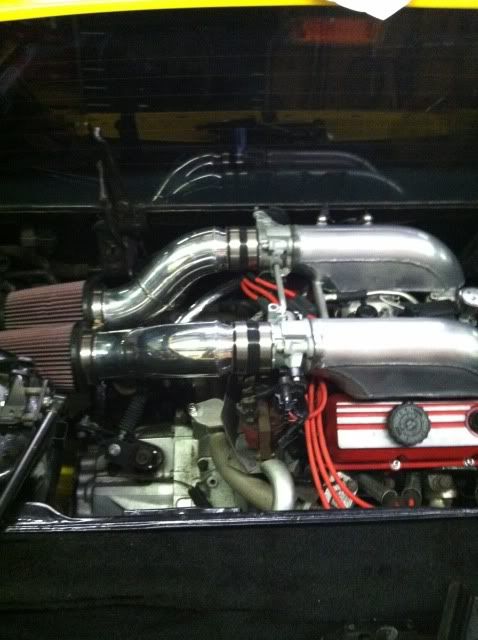

New lifters and 1.6 roller rockers installed:

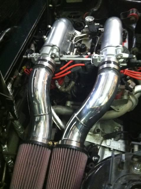

TLG dual intake going in:

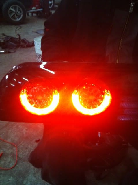

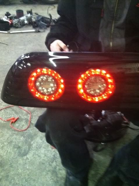

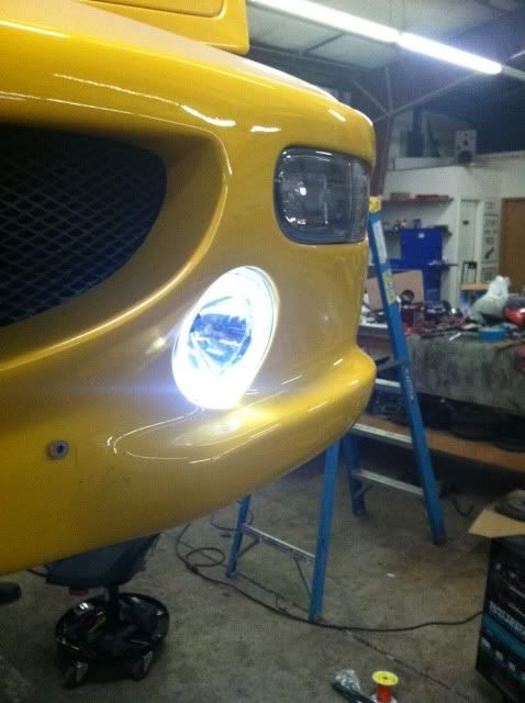

The Hella lighting onslaught is beginning at Whodeanie Customs:
The red/amber ribbed taillight inserts and the silver plastic enclosures around the Hella lights will be painted black.
And the reverse lights will receive TLG's HID kit.

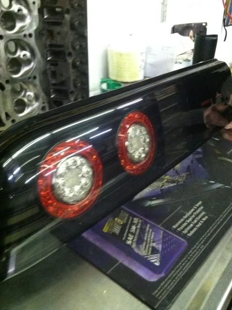

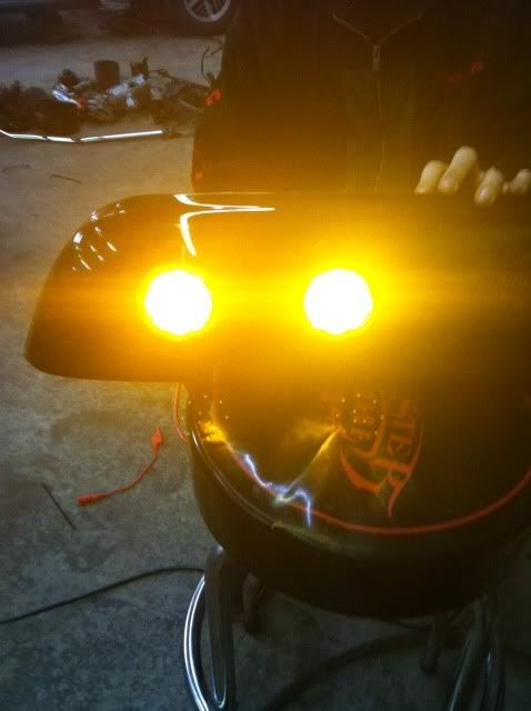

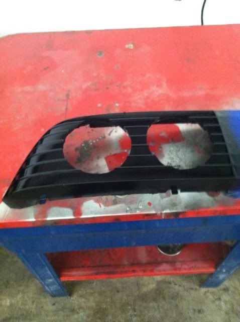

Now painted black. Doesn't this look completely and utterly awesome?

Ok, many people have asked how to do the tail lights. it is not that hard to do it just takes time a hole saw and a little luck.
first take the tail light apart and remove the red and amber section, measure it out for the lights, get a hole saw that is the right size or a hair under and drill the hole. this is the kicker! you have to use a very fine hole saw bit or run it backwards other wise it will brake the cover. once that is done clean up the hole and sand to fit. after that paint the lens black with krylon fussion semi gloss black let dry and install lights.
they will have to be glued in because no other way to mount them. I used hot glue to hold them in place then sealed them with black RTV.
you will have to trim patr of the back cover to clear the lights to reinstall it as well, and done
here are some other pics of them.
now on to other things.

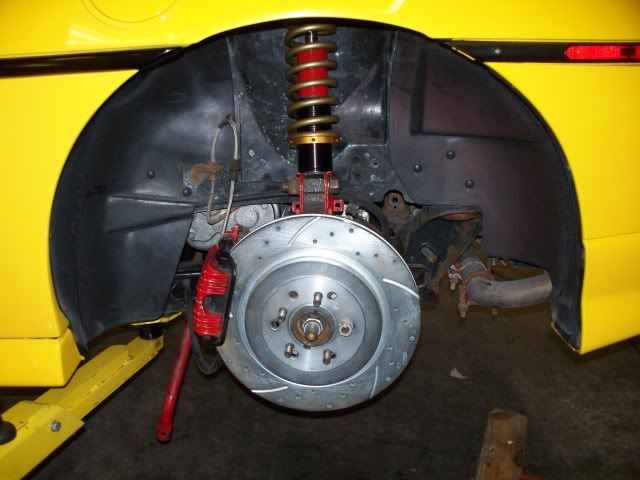

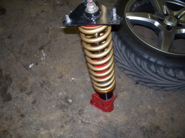

we installed the coliover front on the car as well as the rest of the TLG intake.
here are some shots of that as well.
we also installed new lifters and roller rockers.
way more to come.....
HID back up lights, HID head lights, Angle eye running lights, LED cab, brake and marker lights. as well as a few other goodies we will shaer later

tailight mod sooooooooooo simple...wonder why it took so long! LOOKS AWESOME ! How much are the Hella units?

the lights look great and last night we bench tested them
if these are not seen someone needs help, unless they say they were blinded!
the running lights.....
the brake lights....
they are so bright that they only use 1/2 of them
the turn signals......
and the angle eyes....

That looks soooooooo good! I want my car back and drive over to South Beach! Right now! :-)
[This message has been edited by yellowstone (edited 01-21-2012).]
Yellowstone, you beat me to it! These taillights look amazing. I am in the process of doing the exact same mod. Mine are using a slightly different set of Hellas, smoked, and I am eliminating the stock reverse lights as the new ones incorporate them.
OK....I guess I'm ditching the 82' Corvette LED reproduction taillights I have to do this mod and ordering the Hella lights as soon as I have the money!
This just looks WAY TOO COOL.
The turn signals are yellow, right?
I know you have been working toward this for a VERY long time Kolja. I even remember seeing some stock taillight insert parts you had been tinkering with that were on the workbench in your shop in Dusseldorf. At the time, I didn't quite get what you were doing, but as we both know now, THIS is the way the taillights SHOULD look!
The suspension, the brakes, the intake manifold, all that looks great too, but the taillights REALLY "grab me by the boo-boo" and give me a thrill

The Hella LED turn signals are white when off and yellow when flashing.
I was toying with this idea for a long time and what you saw on my workbench years ago were taillights from a VW Golf IV that I was trying to modify. The Hella route is much better (and much more expensive), though.
